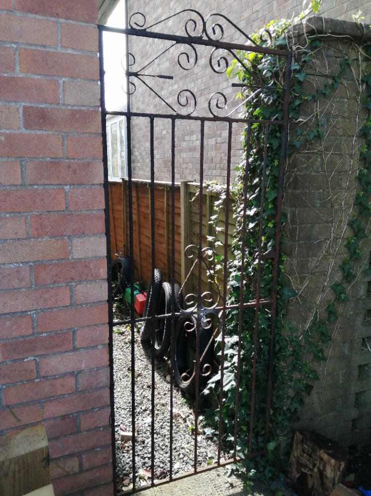

C Chris152 Member Messages 240 Location Cardiff Monday at 11:14 AM #1 We're remaking a decorative steel gate, about 6' x 3' wide. The outer frame on the existing (very rusty) gate is 20mm x 20mm. Should that be solid steel, or hollow box section? If the latter, will 2.5mm thickness be adequate? Thanks.

Mick Annick Forum Supporter Messages 3,045 Location Burgundy, France (450 miles SE of Somerset) Monday at 11:36 AM #2 I’d make it from solid bar, I’d use 16mm square or possibly 25mm x 10mm flat, depends on what you want it to look like.

C Chris152 Member Messages 240 Location Cardiff Monday at 11:44 AM #3 Mick Annick said: I’d make it from solid bar, I’d use 16mm square or possibly 25mm x 10mm flat, depends on what you want it to look like. Click to expand... That's great - thanks Mick.

Mick Annick Forum Supporter Messages 3,045 Location Burgundy, France (450 miles SE of Somerset) Monday at 11:46 AM #4 If you need to use box - I avoid it like the plague - I use 3mm wall, that’s the smallest I can successfully arc weld, I don’t have MIG.
