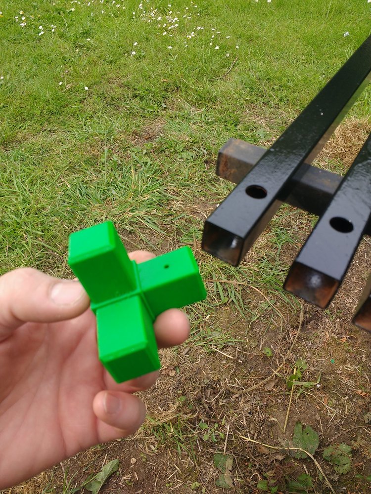

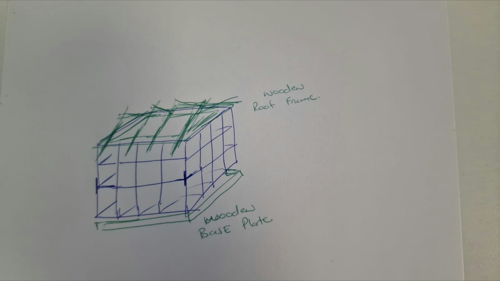

A while back my mate gave me a load of 25mm box section. I think it's powder coated. This was old server racking. Each length has a few holes in it.

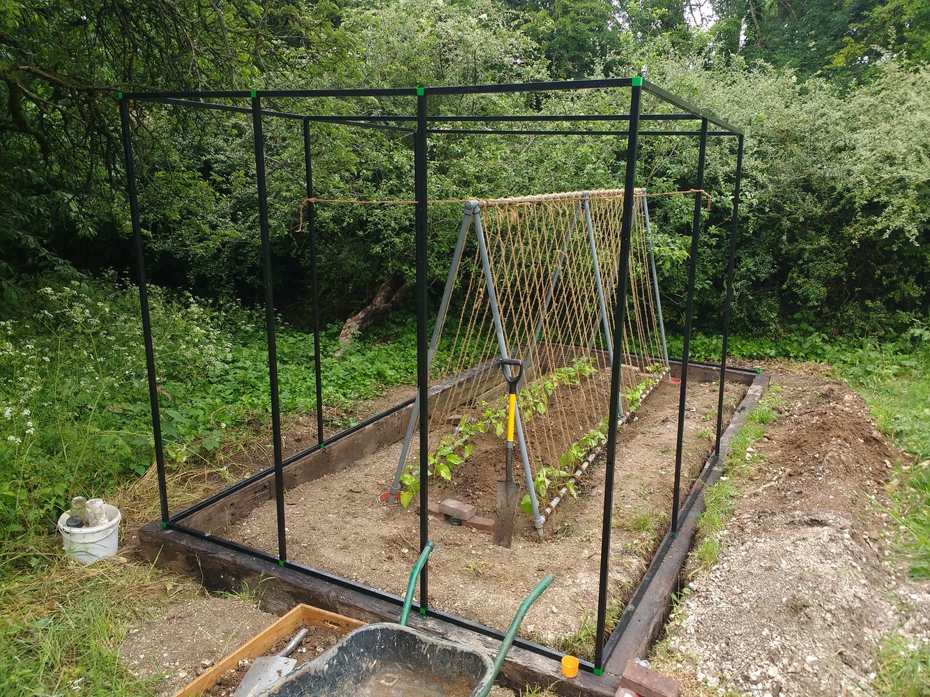

He's been on for ages about building a new wood bothering workshop and has a mad idea for my lad to print him 120 - 140 PETG connectors and have the box section back. Then to clad the resultant frame in 18mm ply with self drill screws. It comes from him seeing the veg patch frame I've built from the box section using similar connectors. That's just having a net over it.
Seems a crap idea to me for a number of reasons. For one I feel MIG welding it would be better if at all. Even then the wall "studs" would I think need to be like lattice / ladder beams
I can't see how he'd insulate it easily either.
Gut feel is such thin walls would be "wobbly" to say the least and the walls likely to bow.

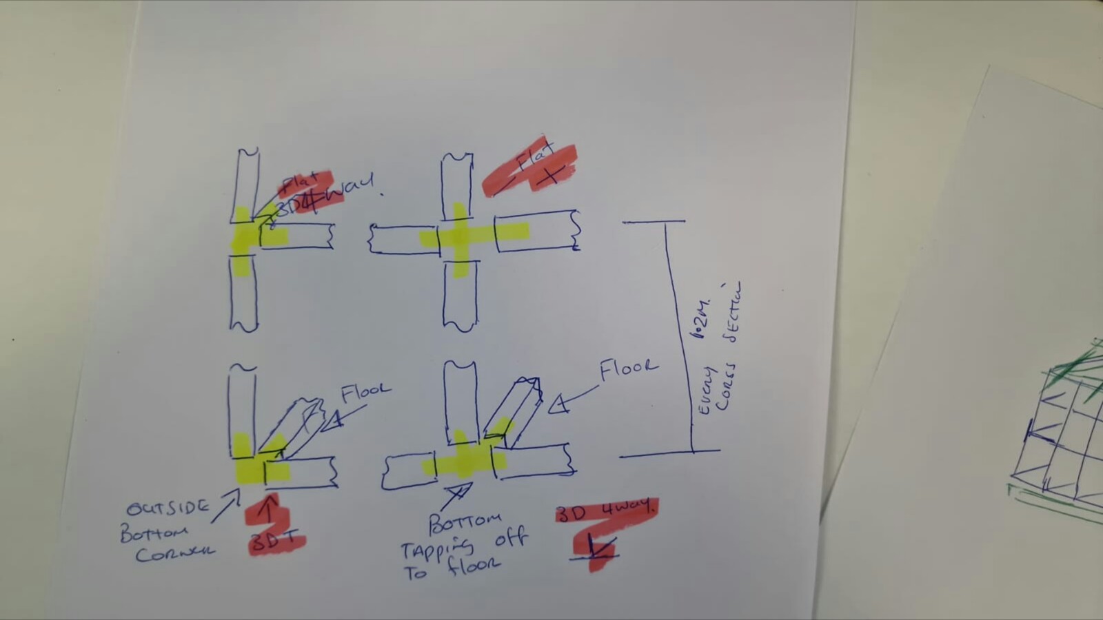

These are his sketches:
Any thoughts?
