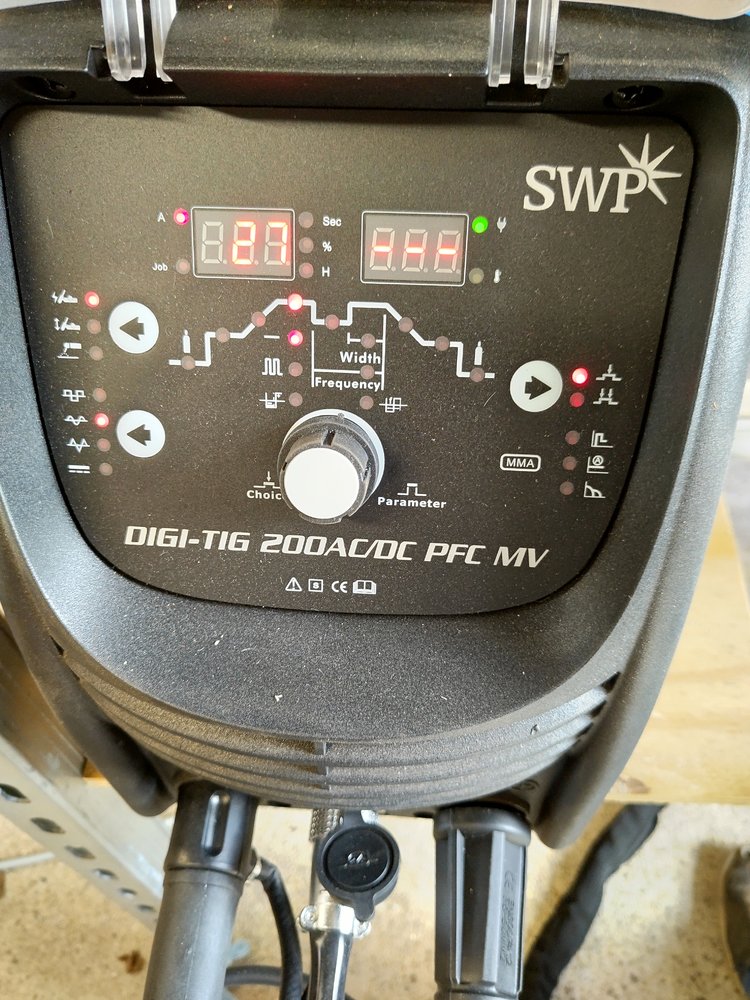

Cheers qwakerswel at first glance you are in ac sine wave (bottom left) you want dc for steel (far bottom option)
that disables all the ac controls so should work fine. assuming you have the torch and earth in the right ports (not reversed) it should be good to go. do check you have proper gas flow though, i had this issue when i thought i had good flow but i didnt.
