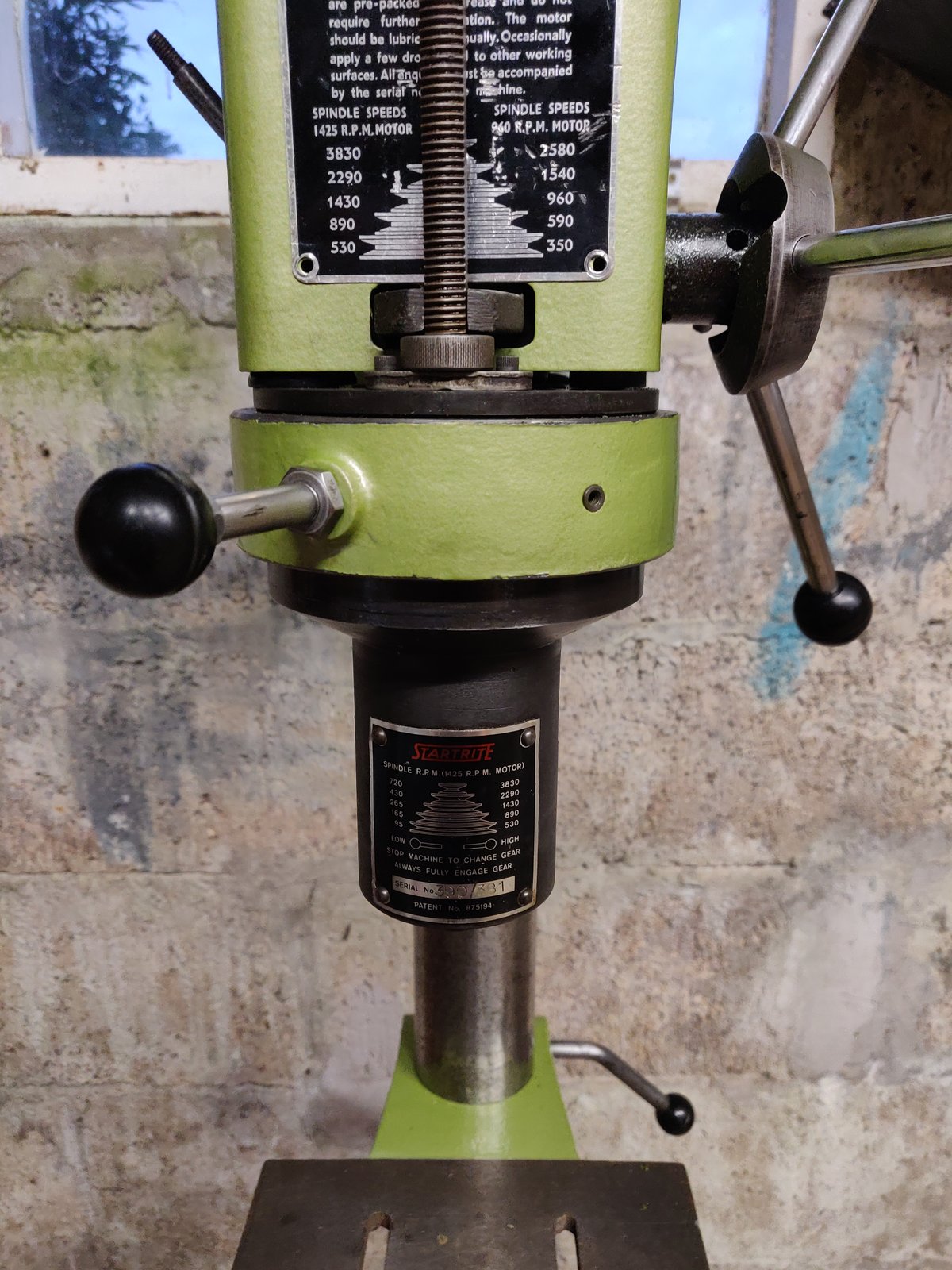

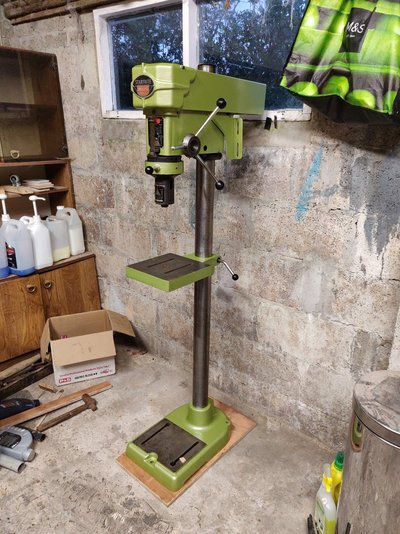

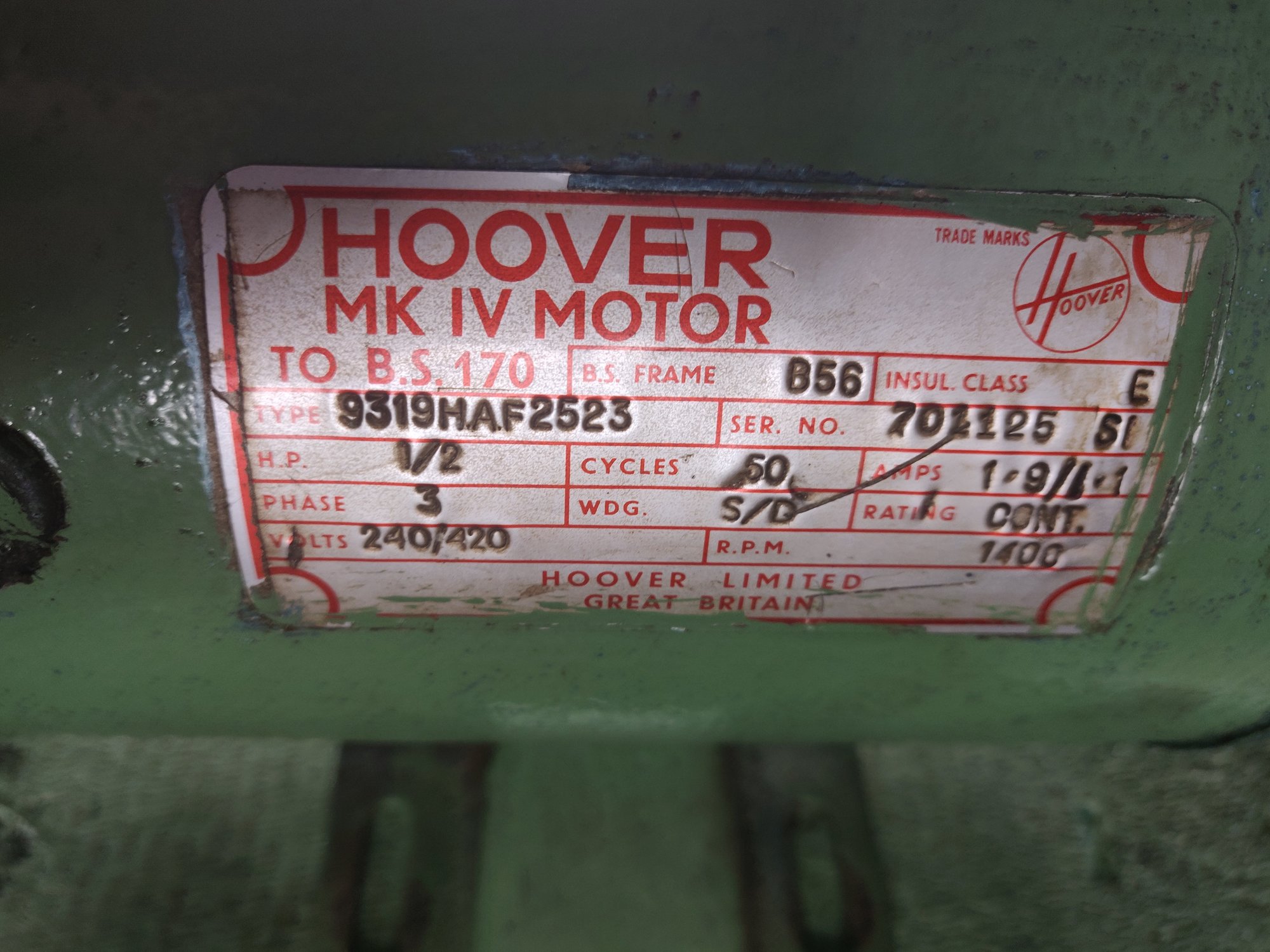

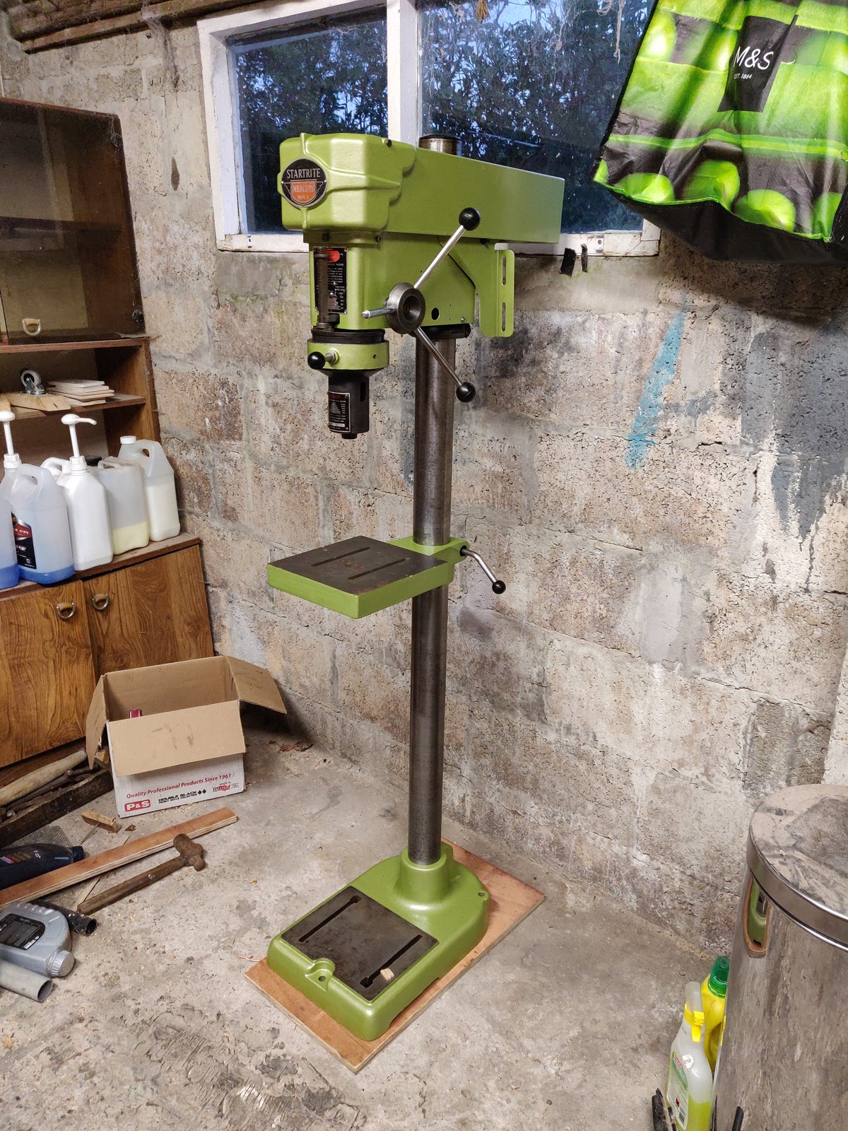

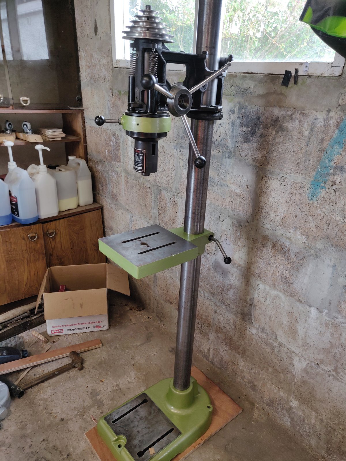

I have the same machine, but with a single phase motor. My second one - the first was a 5 speed. Made in the town that I grew up in.

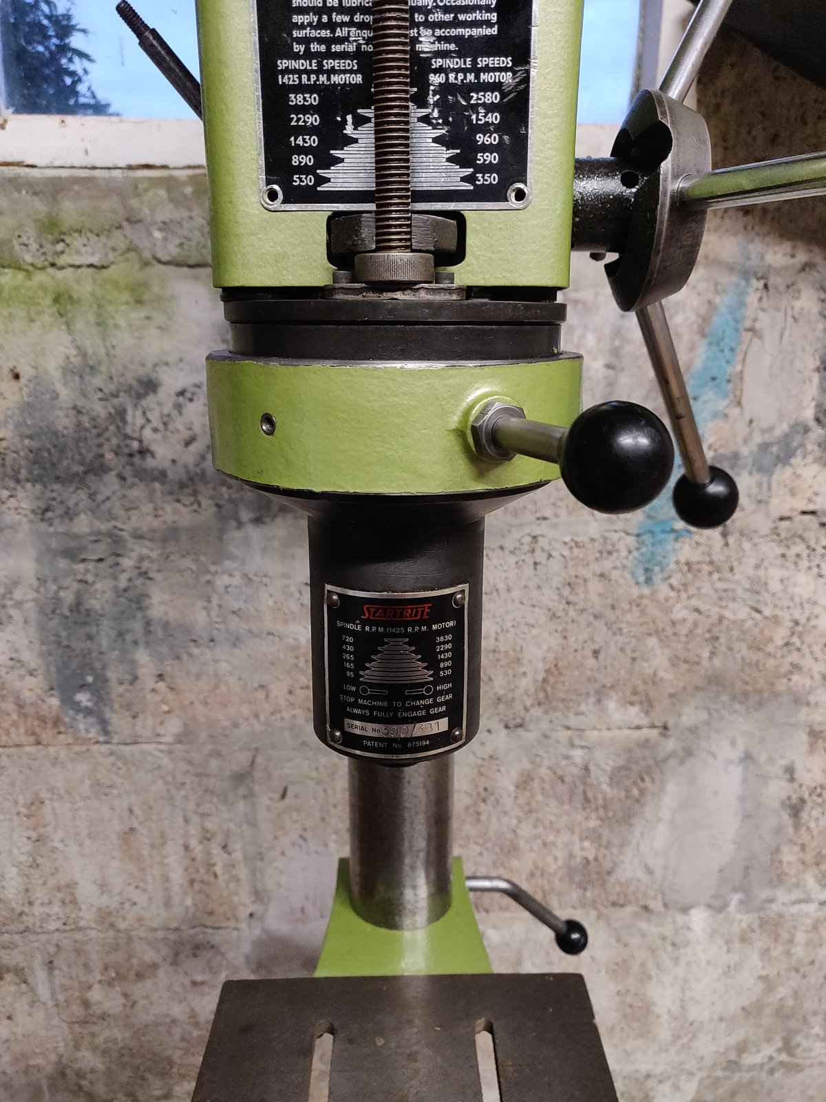

I find you sometimes have to wiggle the lever whilst rotating the chuck to get it change gear

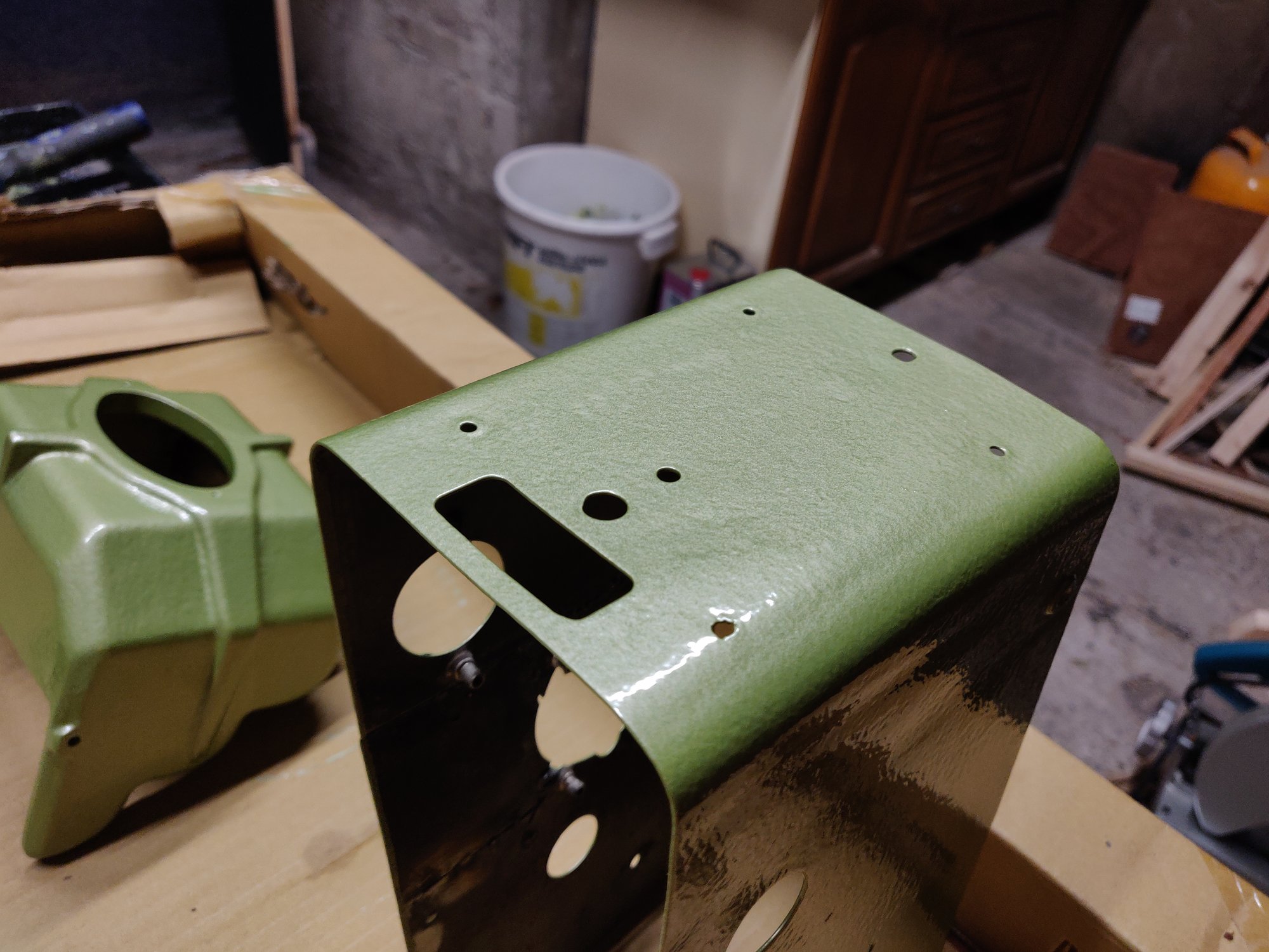

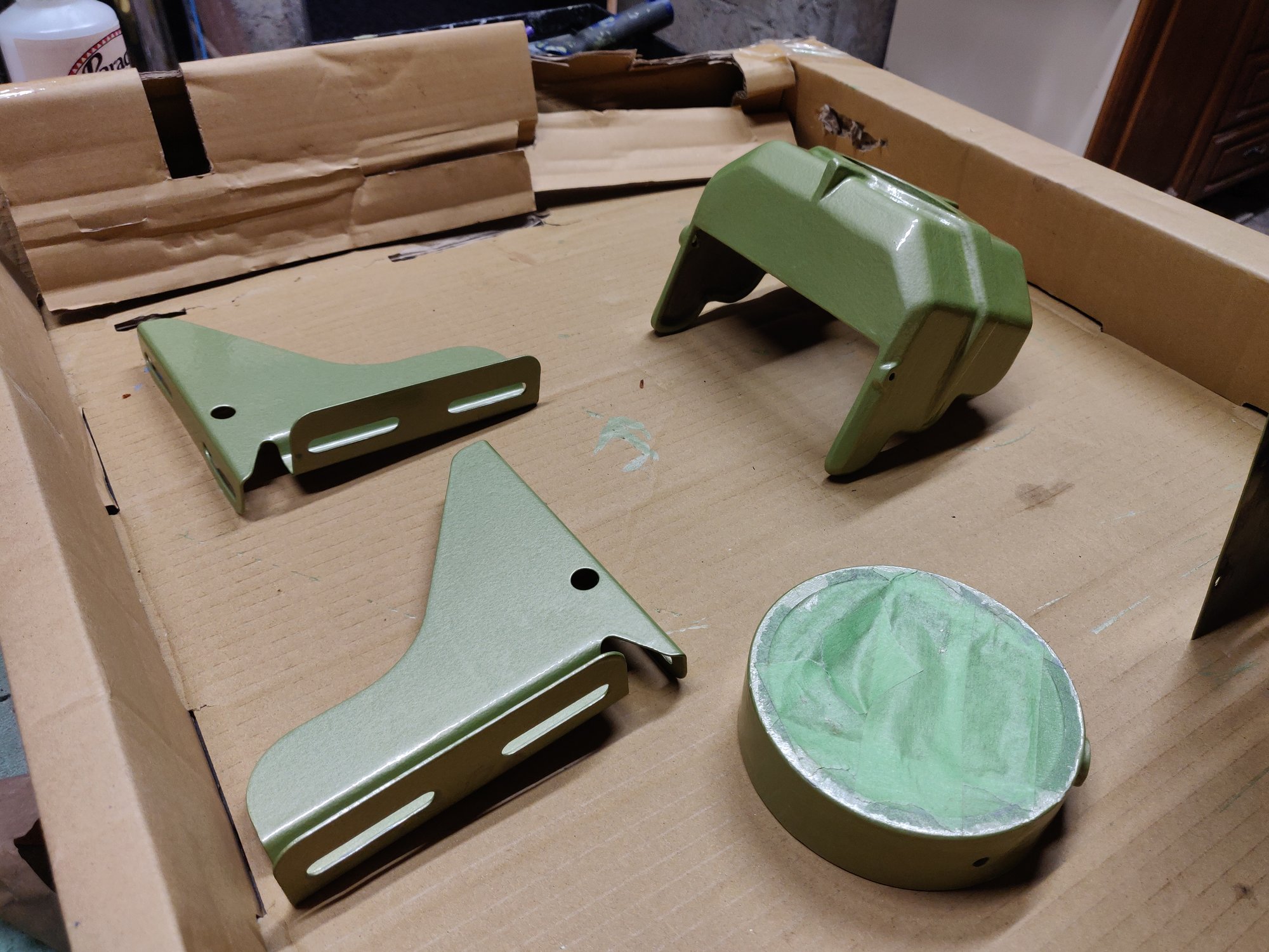

Mine is a bit noisy as the sheet metal belt cover vibrate - I must add some rubber buffers at some point
