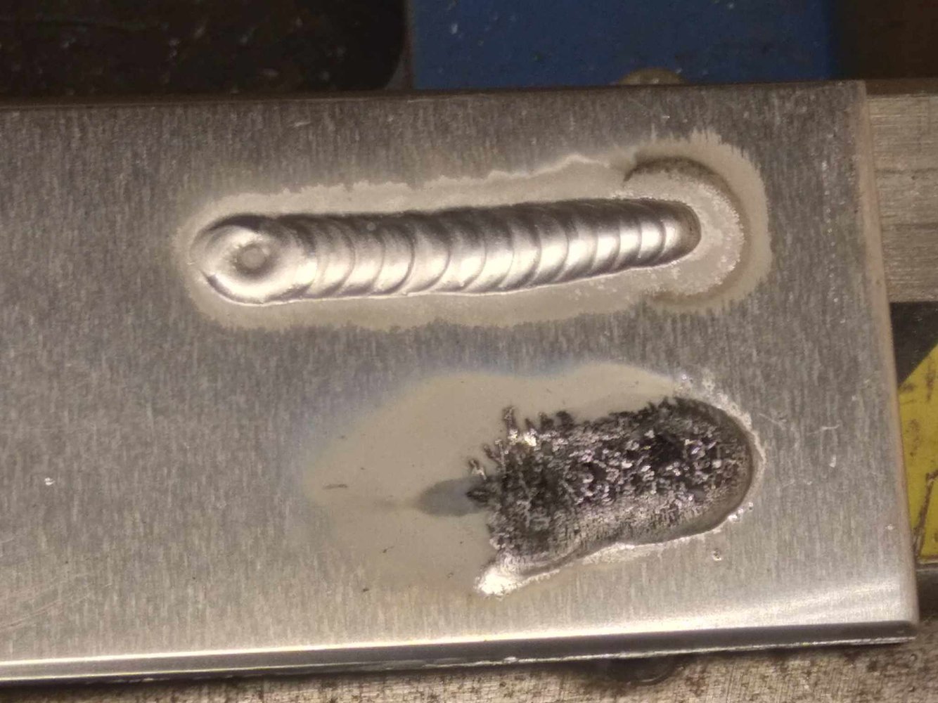

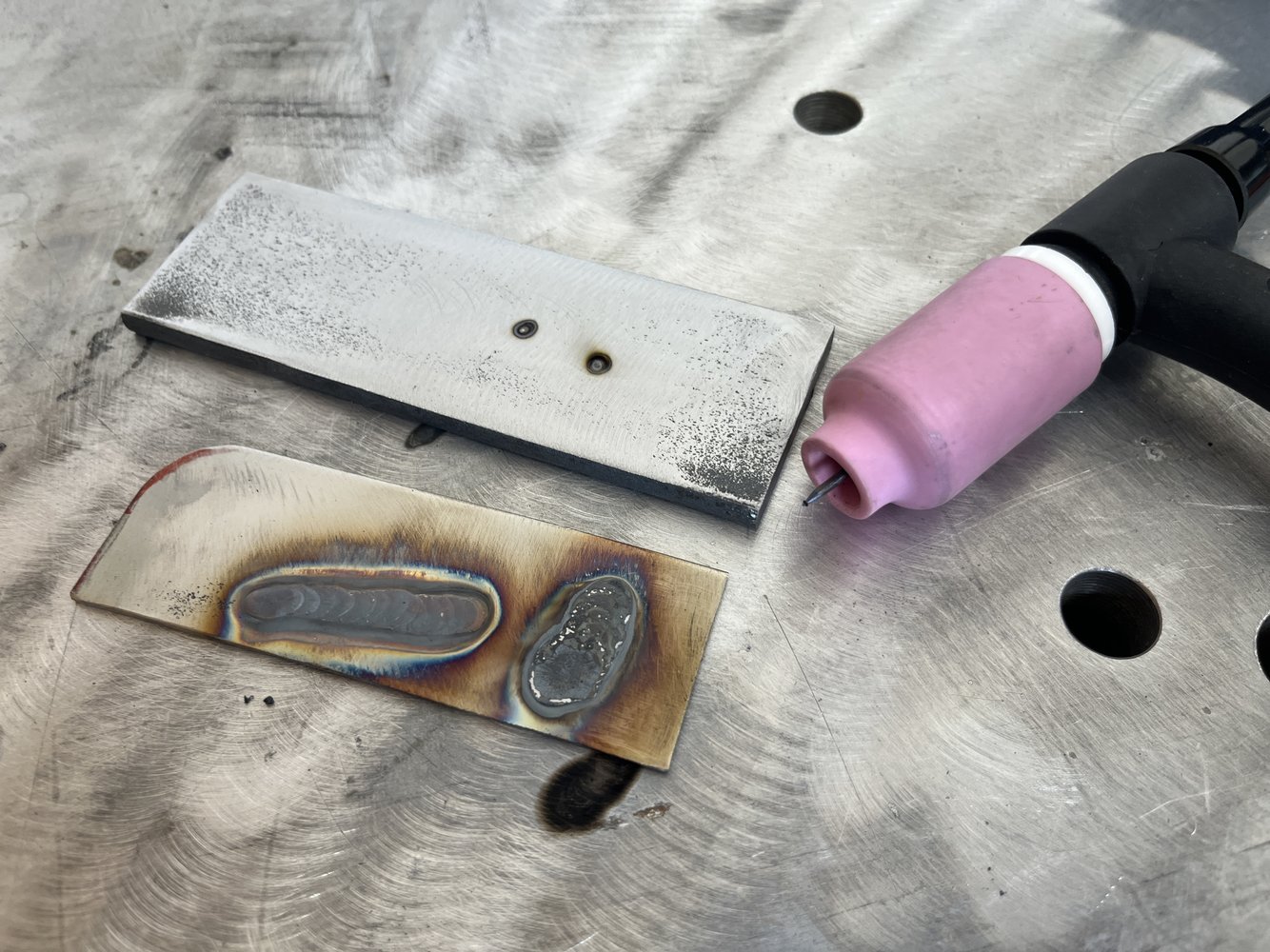

Have you checked it's not the gas hose from welder to torch? They can get porous or crack with age.
Any way you can do a "leak down" test - maybe put a pressure gauge (even a U-bend of clear pipe, filled with water would do) on the gas hose or the welder's pipe spigot feeding the torch, flick the trigger so some gas escapes, watch to see whether the level drops - the leak could be upstream of torch and hoses, inside the machine itself.
