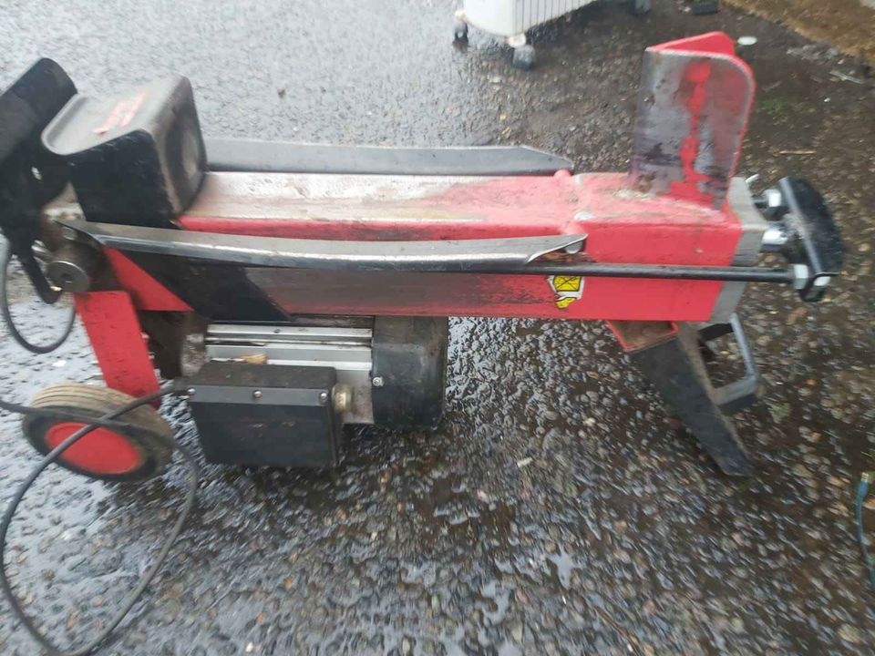

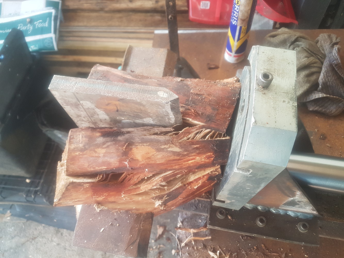

thats what i thought they get mullered trying to push through knotty stuff and burns out the motors!well used i bet motor is failing

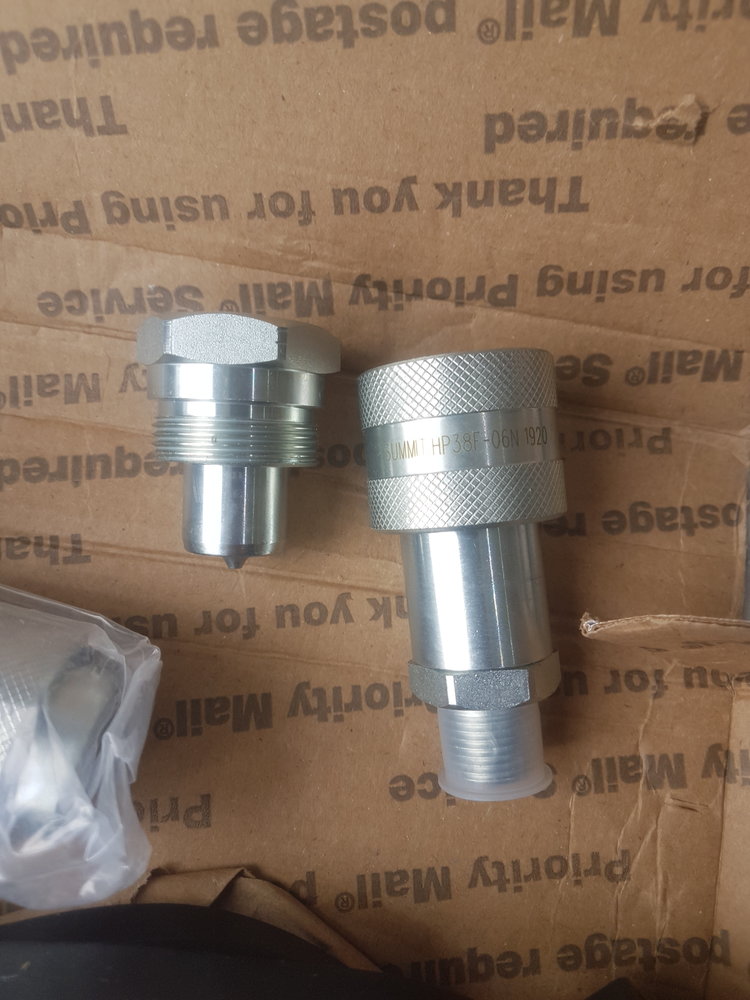

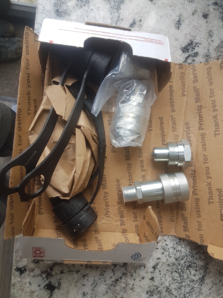

Some I ordered from the USA. the real deal yoh!What fittings are those?

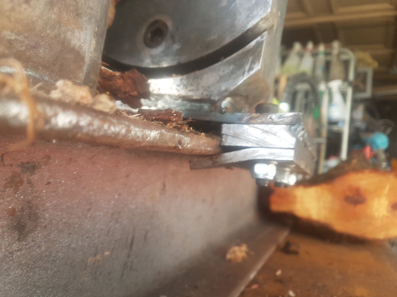

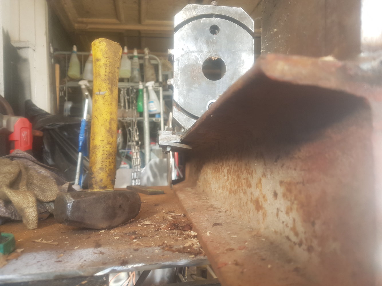

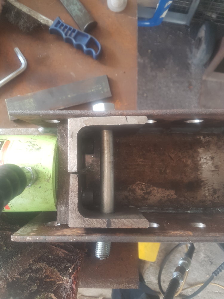

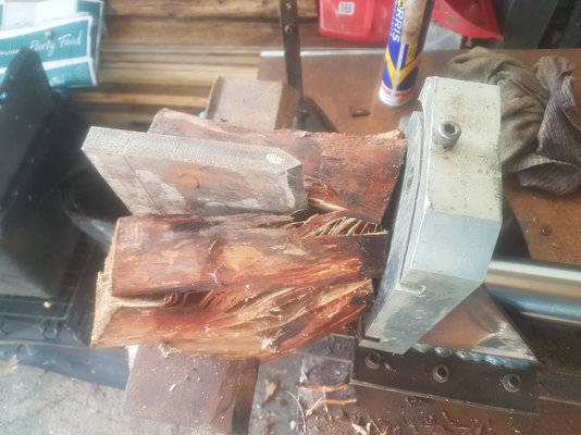

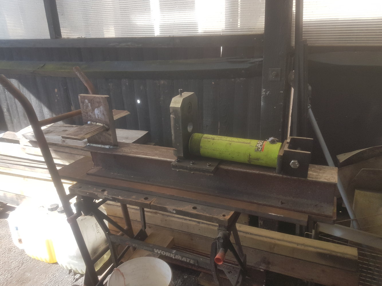

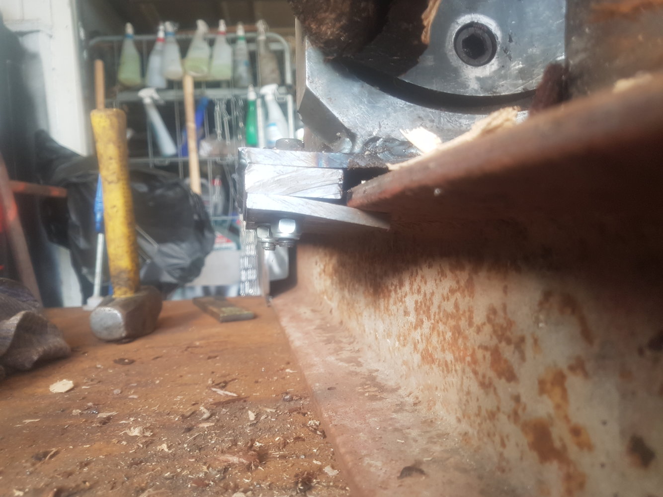

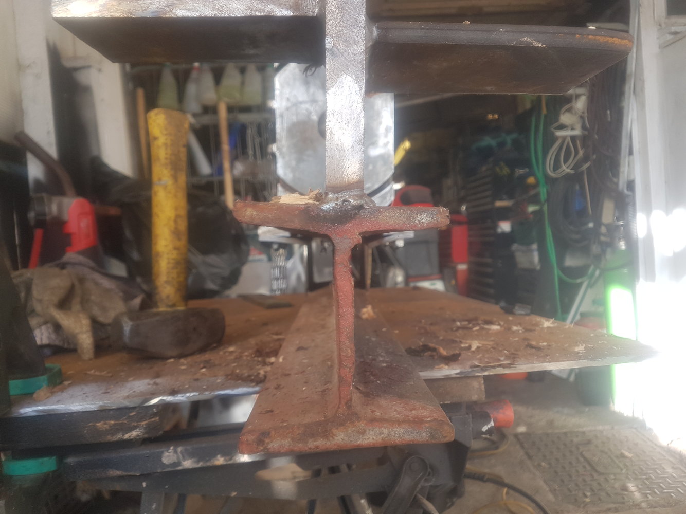

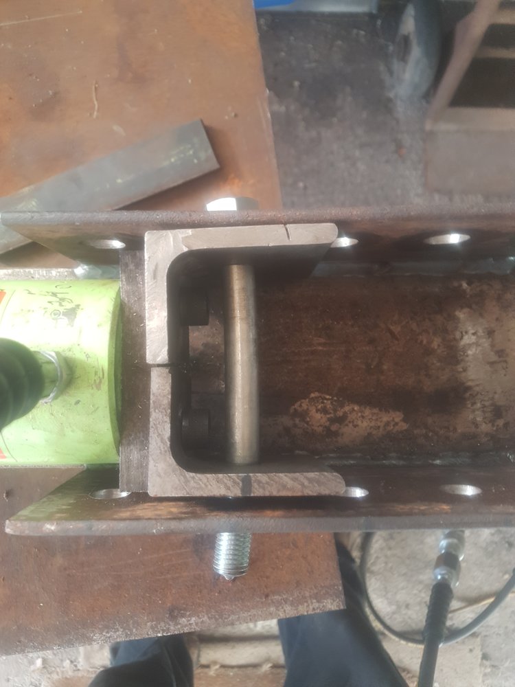

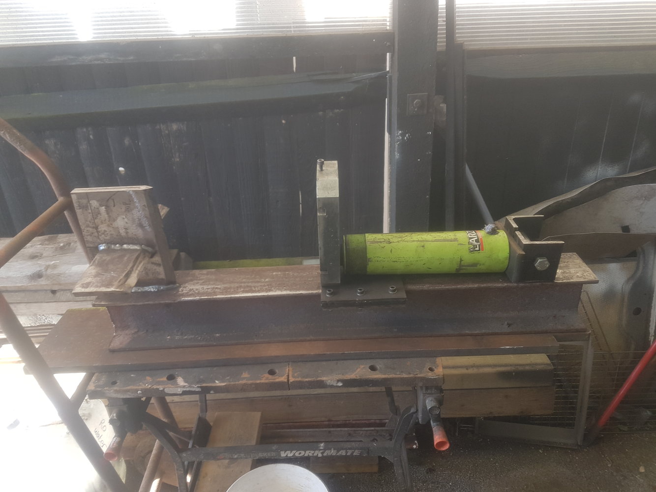

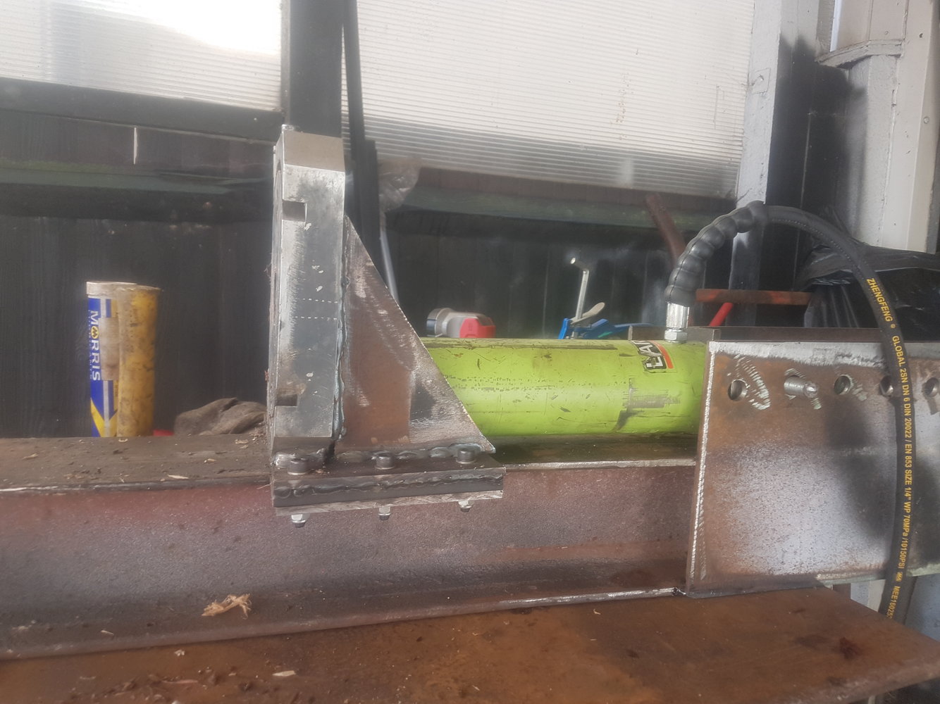

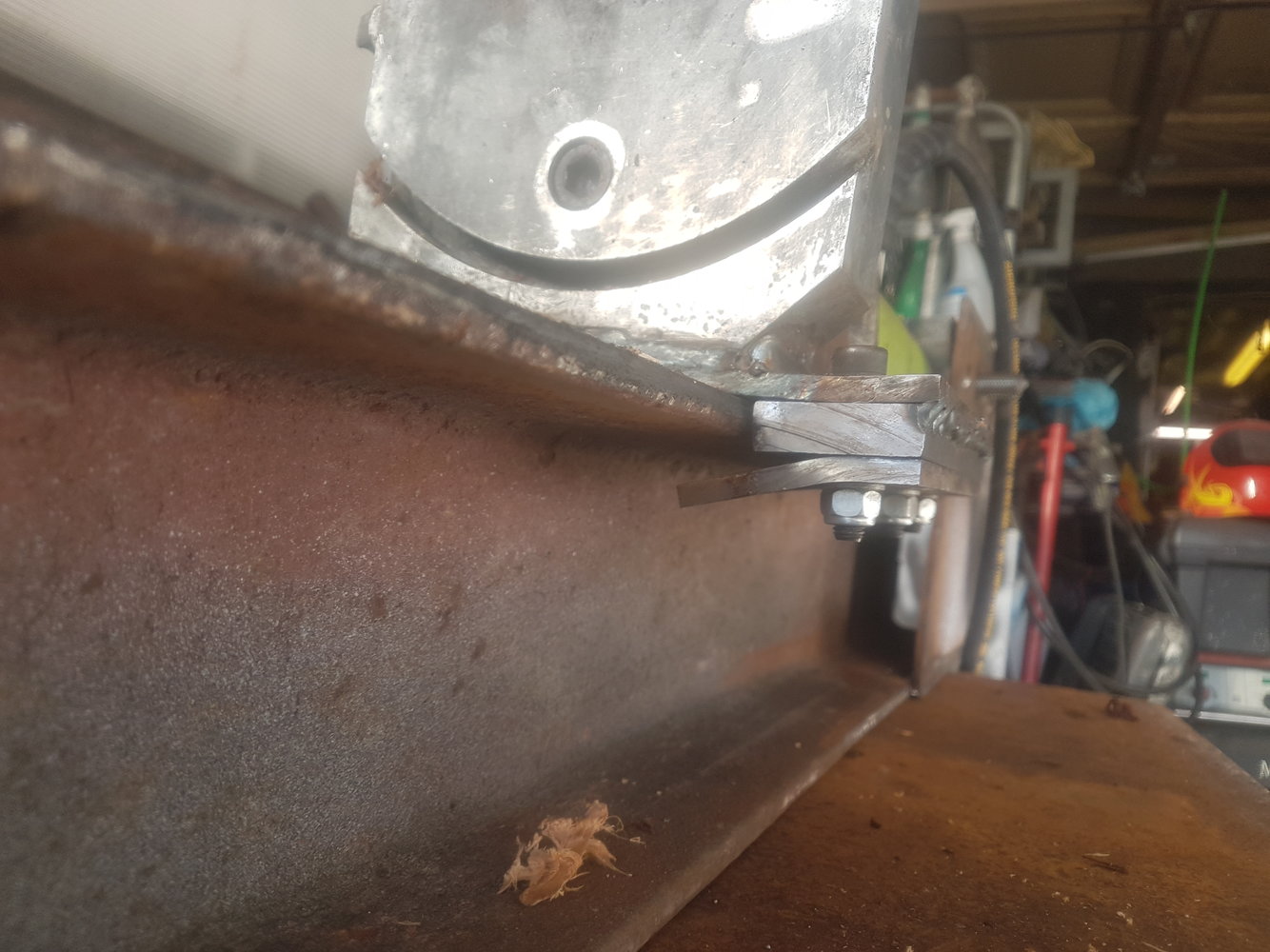

ill post some pics they bent downwards, it dont help that the web aint flat either, I might have to grind the inner web a bit flatterwhere/how did they bend/break?
make them longer, and add a triangle piece between the pusher plate and the top piece that runs over the rsj (to stop it trying to twist)
the bottom runner which runs along inside the runs make that longer too, and have it stick out the front, as the ram goes forwards it'll go under the axe/sharp bit.... but that's ok
it;ll stop the front edge digging in as the pusher plate tries to lift is when you're pushing as log forward
EDIT:
unless they bent down? if that's the case they're pivoting around the bolt holes so there's not much meat there for the top/bottom plates, so wider would fix that :-)
