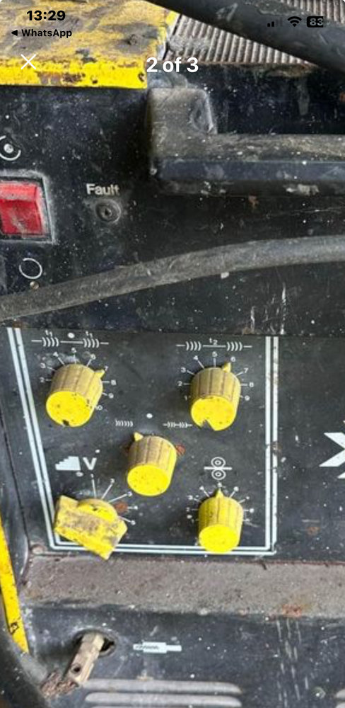

£50Easy enough to find all that via a quick Google search.
30-160A output, single phase 240 or 415v input, will probably run from a 13A plug but not at full output.
The spot weld funtion is simply a timer. Set the dial to the required on time, press the trigger, the power will shut off once the time has elapsed, no more elaborate than that.
How cheap is cheap?
Definitely worth a punt at that price. No return lead by the look of it but they're not expensive. Any torch with it?
Return lead?Definitely worth a punt at that price. No return lead by the look of it but they're not expensive. Any torch with it?

No, the return lead is the return lead. It is not the earth lead, even if many people call it by that name....Return lead?
Is that an earth lead
Sny idea of the weight mateLooks like you could get a bargain, and a decent semi-professional machine. This ( rather smarter-looking ) one went for £180:
The data plate on this one confirms what Woz said - it is a single-phase machine that can run off 230v on a 13A plug, but also on 415v across two phases of a "red plug";
With 8 voltage steps across a 160 Amp output, it should give good control on thin sheet metal.STANNERS Euromig 2000 Mig Welder; Serial Number: E95/L/0197; Complete with Mig Torch and Earthing Clamp
