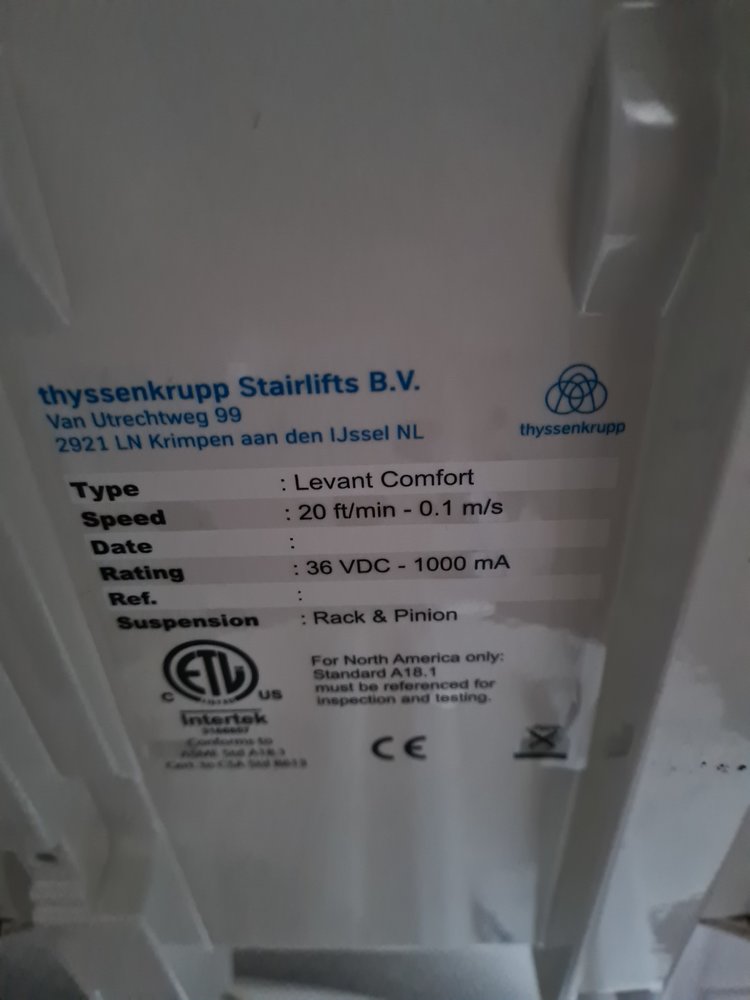

ok we have any one on here that knows about stair lifts ?
mate got one been in for a while and not used they are trying to get her mum to vist for a day but need the lift if she wants to have a nap in the bed
problem the batterys are dead and the unit is not on the charging points
ive done the cheaks there is power 240v to transfomer the on the charging port there is 34v or 36

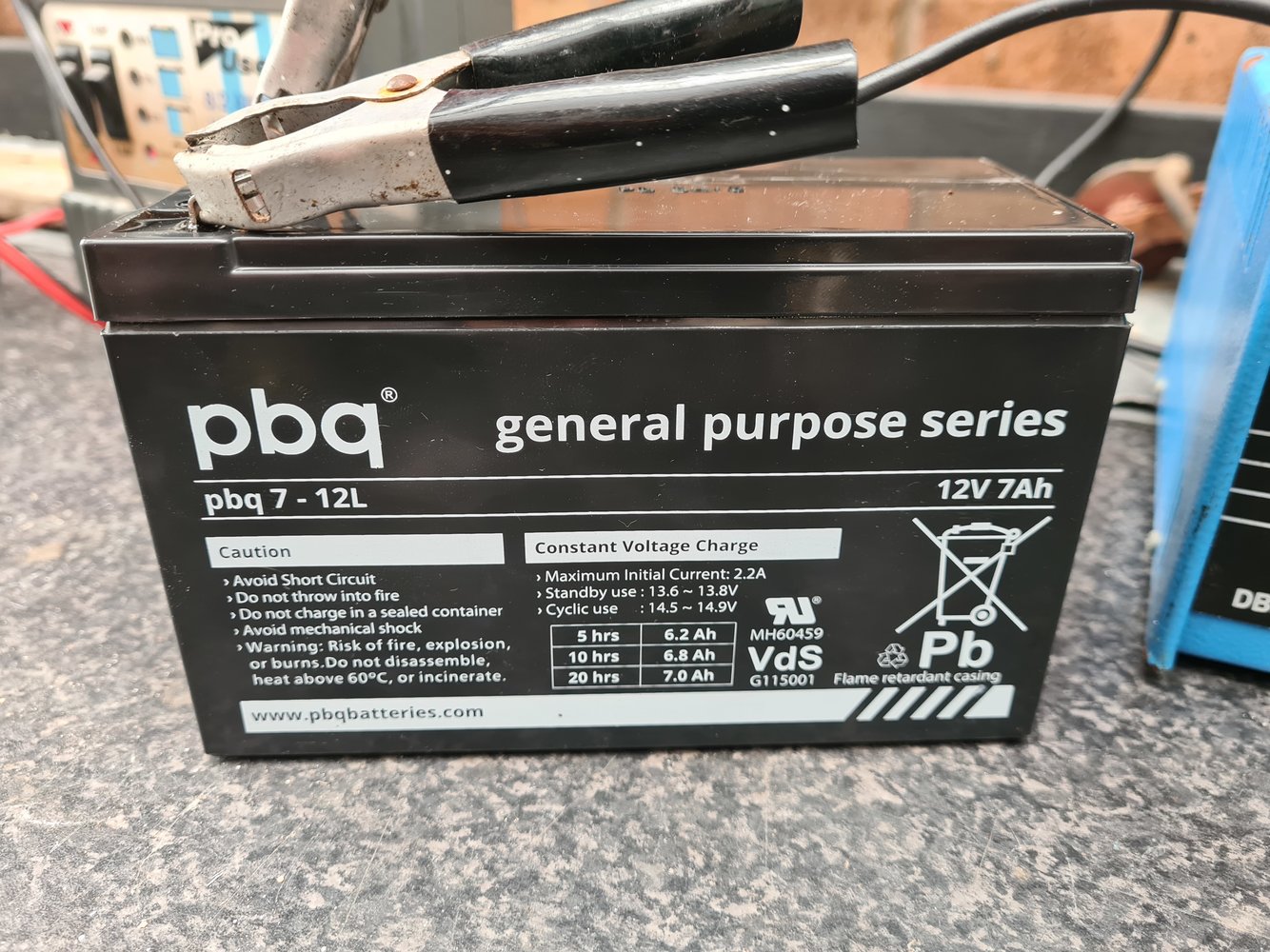

ive removed the cover to find the batterys cheaked them they are well low
so removed added 2 batterys that i had in my sons bike same volt 12 both showing 11v and 13v so 24 total
it beeps when on when push the stick to go up it spins a bit then so as to move but just a nudge then stops and beeps if i try to go down it just beeps
