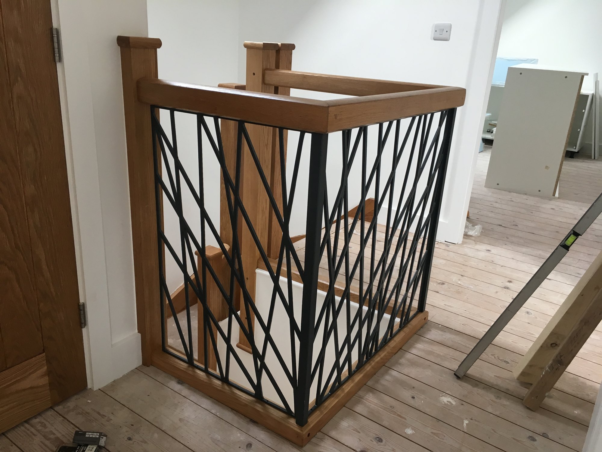

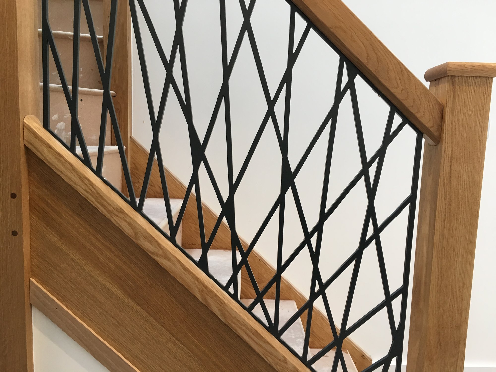

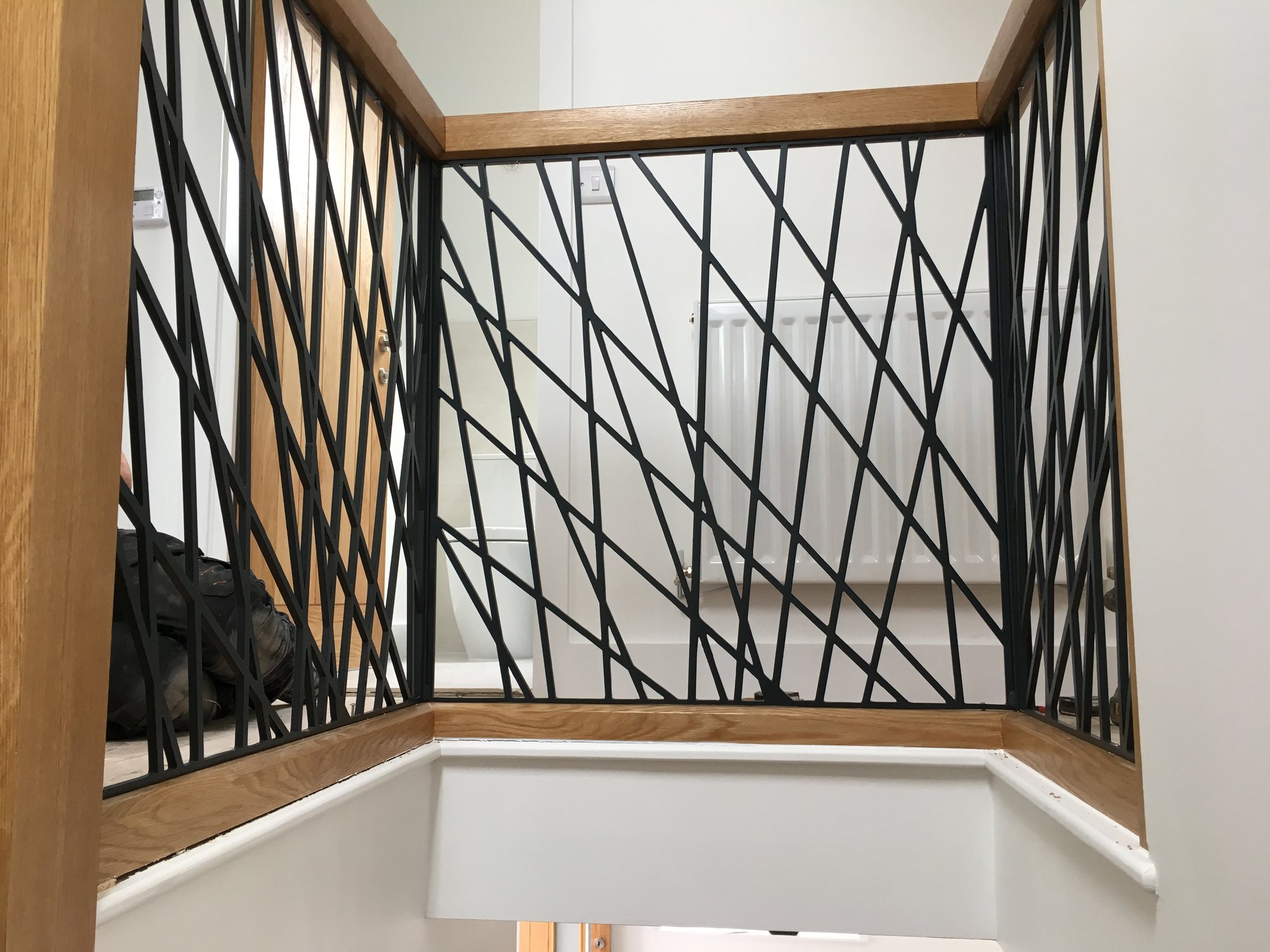

random lines was the request, accompanied by a fag packet sketch. this is what they got, they were happy and so so was I.
That's great, I really love it
Is is waterjetted from a thick plate?
I like that a lot, simple really, but looks great. I was going to ask if they were lasered...
Looks like a pretty good cut, your own machine, or outsourced?
Our own, hypertherm 125 cutting on a swiftcut cnc table. Mainly used for steel structure end plates but do arty type stuff as a bit of a side line
