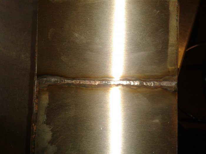

unfortunately I already cleaned the surface after welding, so cant take pics. Yes i cleaned outside and inside of both pieces prior to welding. First flap wheel sanding, then aceton, then stainless steel rotary brush. The weld was dark grey on the outside, and also on the inside. I was set in DCSP at around 120 amps.
