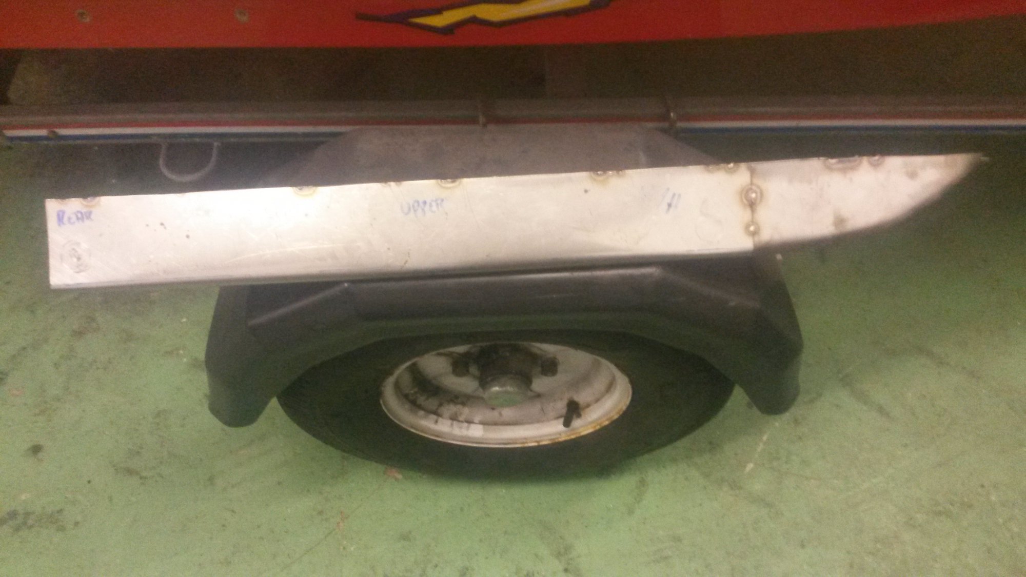

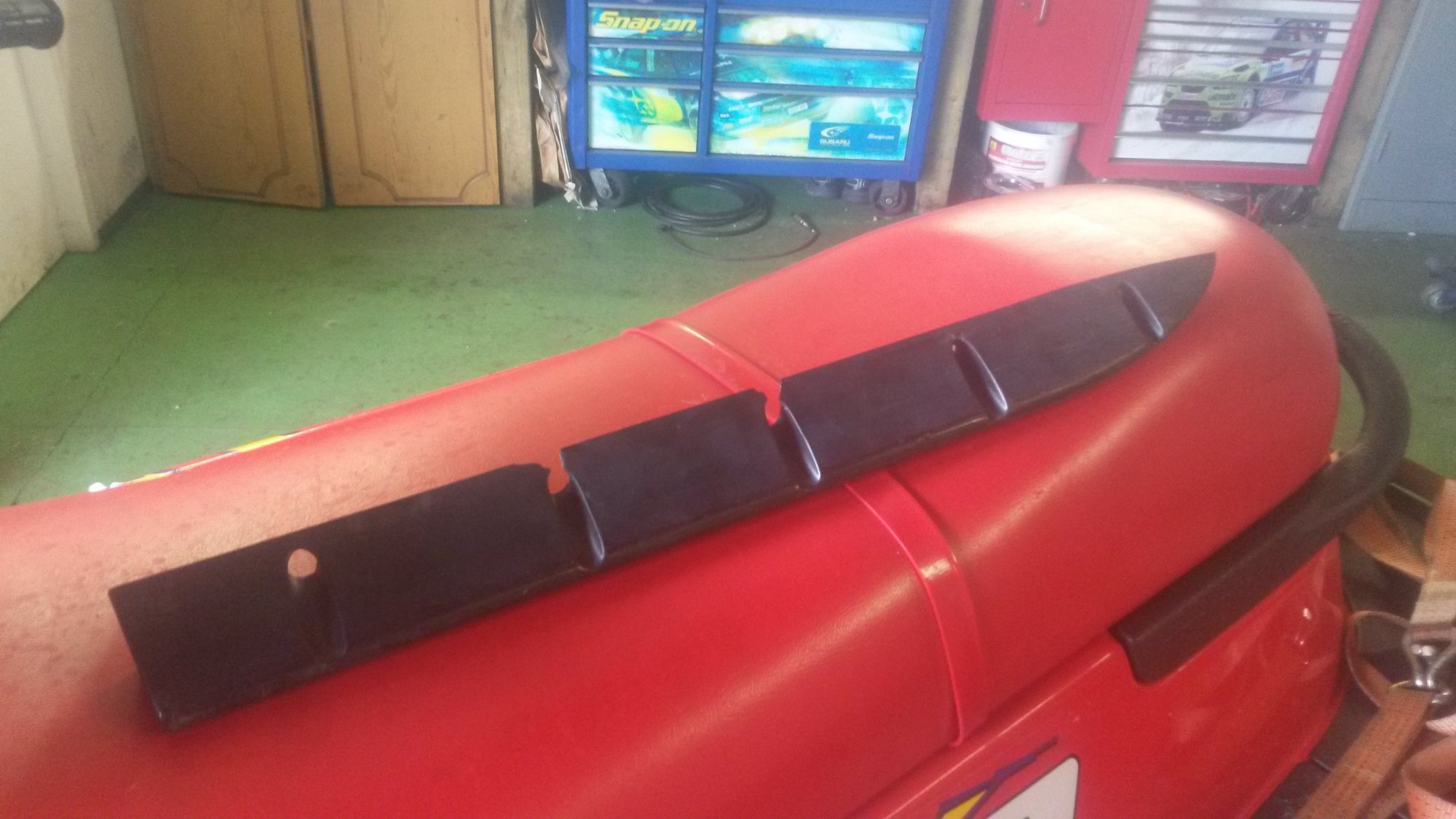

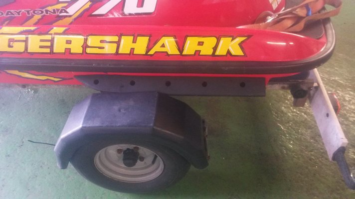

I got completely fed up of my original plastic sponsons breaking, I think the plastic is old, brittle and the cold UK waters don't help either. Spares are unobtainable and I have used up the two spares that I did have.
So a replacement set in 316 stainless seemed like the way to go, not many pictures but you can get the idea. Made from 1.5mm sheet, profiles cut with grinder and then all hand worked to get the required shapes. Fully seam welded with backpurge and then flap wheeled to finish, prior to a coat of matt black paint.
An original sponson
Tacking
The finished article
