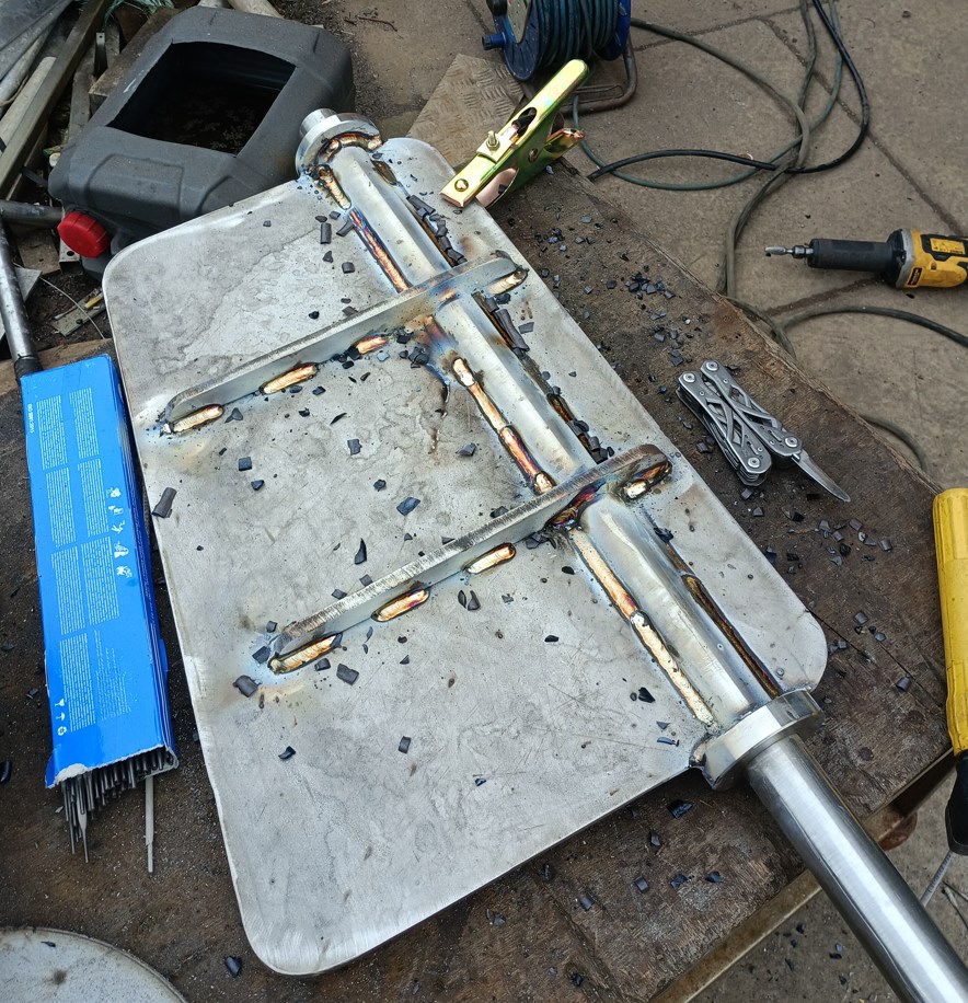

The rudder in the above pic was done with Magmawelds, they seem very sensitive to dampness, if stored in the van the flux will start popping off the rod when you use them, never had that issue before with any stainless rods. They also tend to have an initial porosity issue even when just out of a newly opened packet but I have had that with a lot of other brands in the past so it is not specific to them.I bought some Magmaweld 312's and 309Ls - I getting on with them OK.
Was buying ELGA's for last 10years plus - but local stockist can't get them at "right price now"...
