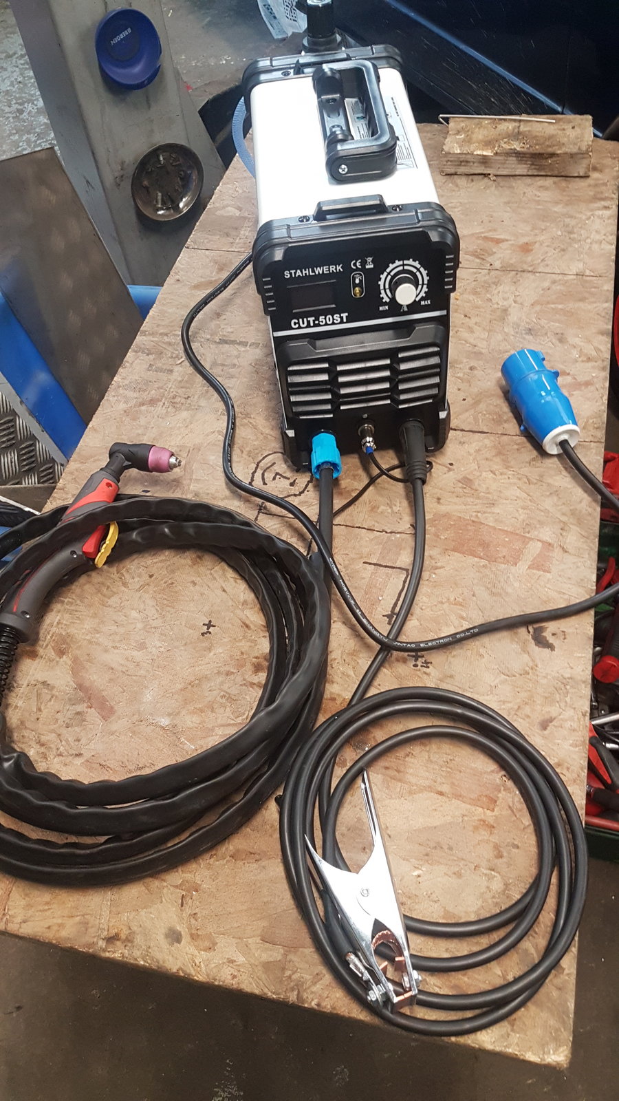

Just got this during the week to replace my previous plasma that kicked the bucket. I ordered it directly from stahlwerks ebay shop, I ordered it on a Thursday and had it the following Thursday, it was shipped from their depot in London.

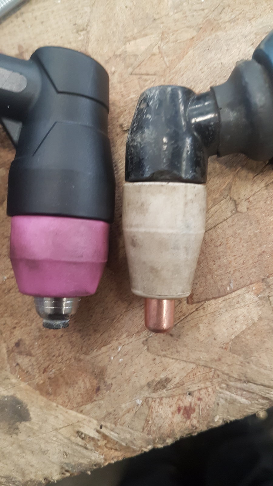

The torch is really nice, its a 5mtr long SG55 (AG60) that comes with its own little carrier bag that I'll never use.
Earth lead is 10' long with a small dinse fitting and a generic stamped steel earth clamp.

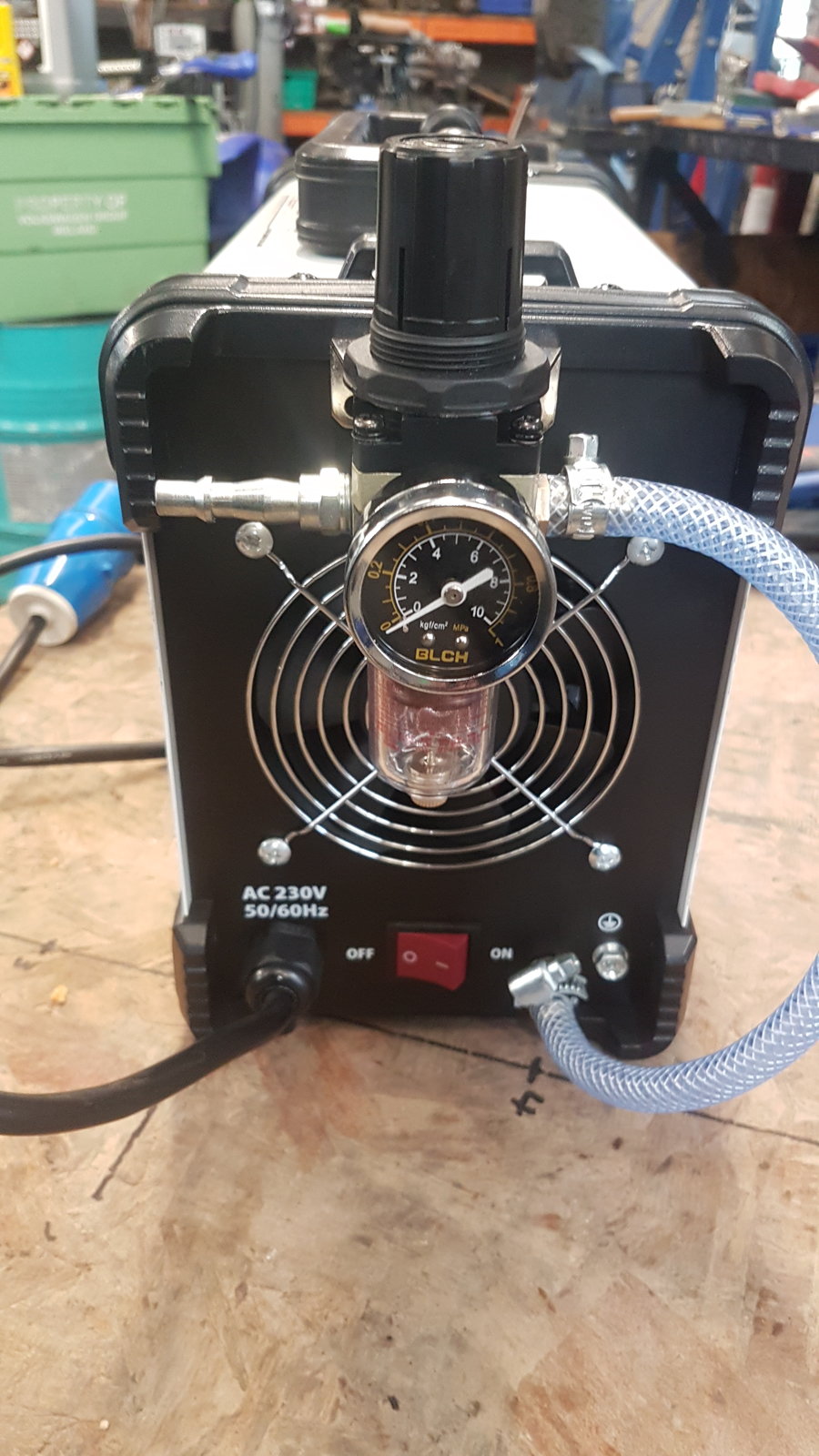

It comes with a water trap/regulator which fits on the back of the machine, this is where the pressure gauge is fitted so to set your pressure you have to be at the back of the machine. The on off switch is also on the back of the machine at the very bottom.

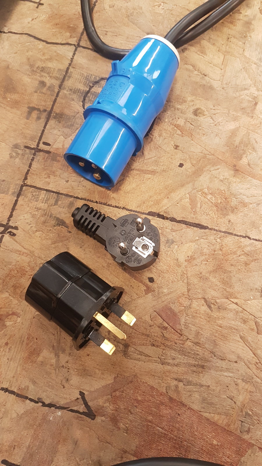

The pwer lead is on the short side at 1m. It came with a European style plug with an adaptor to plug it into a uk 13amp plug. It cut at 40amps no problem on a 13amp fuse but popped thr fuse after a few seconds at full power. I chopped the plug off straight away and fitted a 16amp plug.
