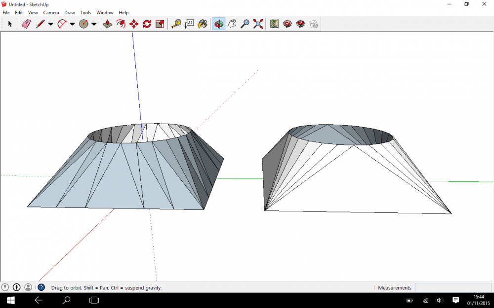

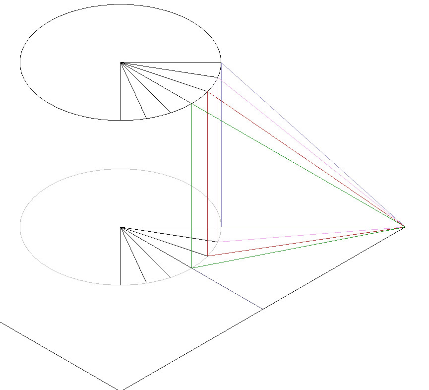

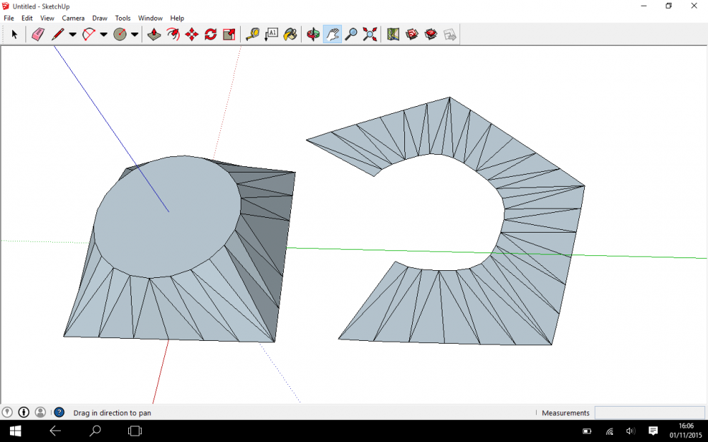

) isn't planar, ie they would each need a diagonal bend across them, like this:
