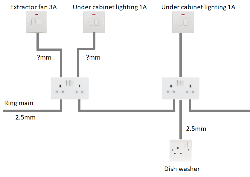

what software did you do that in??Guys, I want to put a few spurs off my kitchen ring main buit am not shure what is and isn't allowed.
I want spurs for the hob extracter fan, dish washer and cabinet lights like this.
First is this allowed, i.e two spurs from each double socket. if yes should they be wired in 2.5mm?
If not allowed, what are my options?
Thanks
And you cant do that then?that is why you can only take one 13 amp spur of a ring at any point to balance the load round the ring otherwise you could get a string of sockets down a 10 meter length of the ring and the other half return may be 20 meters with nothing on it
u can but its not good practice having a fair few sockets on the 1st 15 meters of wire and 35m of cable on a return why would youAnd you cant do that then?

A radial is a circuit where a single cable leaves the consumer unit and goes from socket to socket but ends at the last socket.What's a radial
What's a spur.
And what's a ring main.
I think I know. But just in case..

As I thought. So you can have spurs of rings and radials?A radial is a circuit where a single cable leaves the consumer unit and goes from socket to socket but ends at the last socket.
A spur is a radial circuit, one end of which is connected to a ring for its supply, and the other end stops at the last socket
A ring is a circuit that leaves the consumer unit MCB and goes from socket to socket, and then from the last socket it returns to the consumer unit and is connected to the same MCB.
Yes.As I thought. So you can have spurs of rings and radials?
