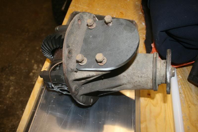

only 2 things seem to be an option at this time, well in my mind anyway
hydraulic drive l like this as it would allow me to drive one side forwards and the other side backwards allowing me to turn on the spot something l cant do using solid axles as l propose, down side is the amount of fabrication it will create removing the solid axle casings from the equation they are doing many jobs as it is from supporting the common shaft locating the wheel bearings and forming part of the chassis/assembly mucho more to make but maybe ???
the other option l might consider is using front axles instead of rear to allow some normal steering as well, l cant nick em of a vitara as they are independent suspension on the front but that may still work as l could use that as well and at have working suspension something the supacat dosent have l would have to forget about it being amphib though as l doubt l could seal around a suspension that moves
