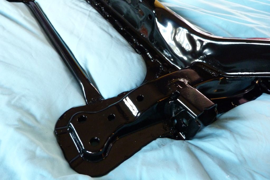

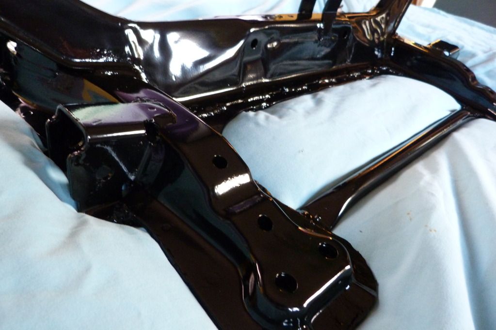

Weldinator Astalavista baby.... Messages 770 Feb 16, 2012 #7 A token was missing when trying to upload them ?? Is it ok to have a little standard primer on the stone chip from overspray before top coat is applied ? Here's mine in 2k epoxy primer and paint. Ive used Photobucket because the forum loading wont work. Last edited: Feb 16, 2012
