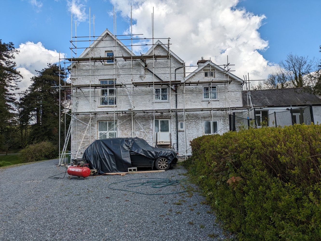

Does anybody have any direct experience of spraying limewash onto a stone building?
I'm not interested in people proving links to YouTube, other Internet posts etc., as believe me I've searched. I want hands-on experience.
It's reached the point where we need to apply the limewash to our home which is slightly larger than most. I've done so far one coat using the normal method of yard brushes (well okay brushes but we're scaling things up here) on about 100 square metres (only another three or four coats and another 800 square metres to go). It's not been bad applying it with the yard brush but I'm wondering if I can speed up the process a bit.
I've used a friend's Wagner 350M before for the office with standard emulsion and that worked really well. From my research a minimum of about 0.5mm tip is required because of the lime particles in the mix.
Points to note:
- We're mixing from scratch (quicklime) because of the volume needed and therefore cost
- No additives being added (just pure limewash)
- Fresh lime pointing and stone
My main concern I guess with any sprayed on approach is it may dry too quickly.
As said the brush approach isn't too bad, so far 1/3rd of one side of the house has taken a couple of hours to do one coat.
