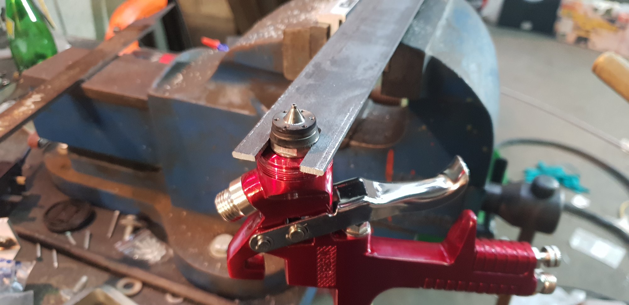

@fizzy was just thinking about this, can you straighten your "bike spanner" so it fits, grip the gun in a vice, fit the spanner to the fluid tip then use a stillson to grip the jaws of the spanner and slacken it.
You might need to use a spanner to hold the head of the spray gun head to stop twisting or breaking the gun.
