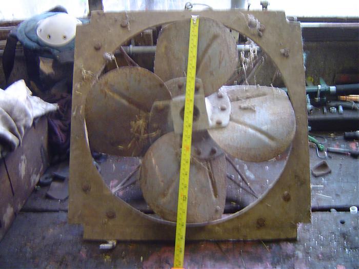

Paul I have a Shed load of 3ph extraction fans around 2' d... Any use???, Just another one of them things I aquired![]()
ooohhhhh that sounds of interest mate. 2' sounds powerful...!?!?.......

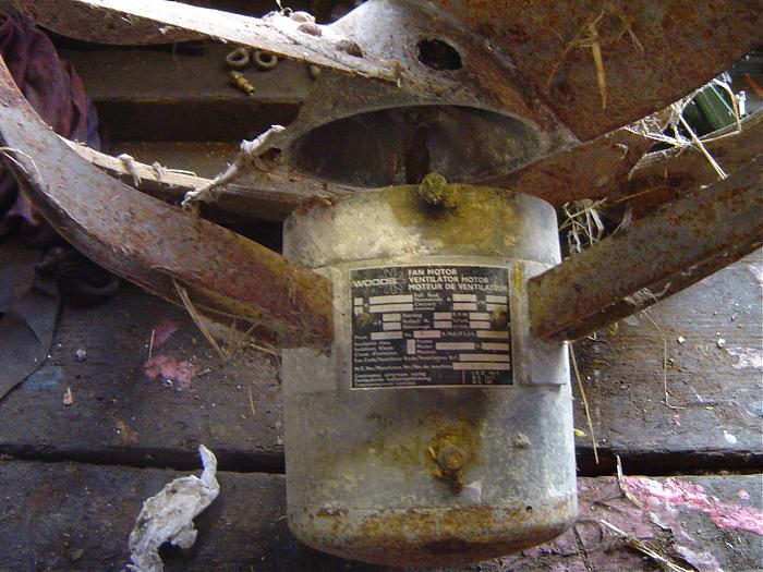

Il take some pictures tommorow iv got about 10 or so, had a fealing there was some speed controlers as well...think there brook ones, the guy told me fan motors run a diffrent set of windings to a standard motor dont know why??, anyway's Il take a photo any use you can have a couple.....

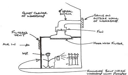

Remeber, any fan used for a spray booth has to have the motor out of the airstream, ortherwise it will a} soon get clogged b} will go bang! when a spark from the motor ignites the paint vapours! a bifurcated way is best, axial fan is a none starter!
This is what i was planning on doing - any thoughts anyone![]()
what are the pros and cons ?

Except, Dave, how many motors on applications like this would not be TEFC? They'd stop cooling effectively, covered in paint... admittedly![]()

.......But then you won't have to change the filters so often as it'll take longer for them to clog up. Result!
Actually, i'd use fans like that as general workshop vent fans. They'll happily blow fume laden air out of the workshop all day. So get a couple anyway. You can work a cowl in over your main welding bench and keep your lungs clean, nae bother.
Setting up a spray booth for spraying gates and railings.
I am going to form the booth from (Probably) glav sheet on a framework of angle or box section. Includes perspex windows on the back wall to let light in. I will include for intrinsically safe lighting and some sort of a fan to extract fumes. I was going to try to get hold of some sort of disposable lining for the walls - seen in it big spray shops - but don't know if it is worth the expense?
How do i need to set up the fan - presumably some sort of filter would be needed so it doesnt clog up over time. - Can it just be discharged outside? I will need a few hanging rails set up to support stuff. er.. anything else? Oh, mask with a breathing line to the outside world?![]()
