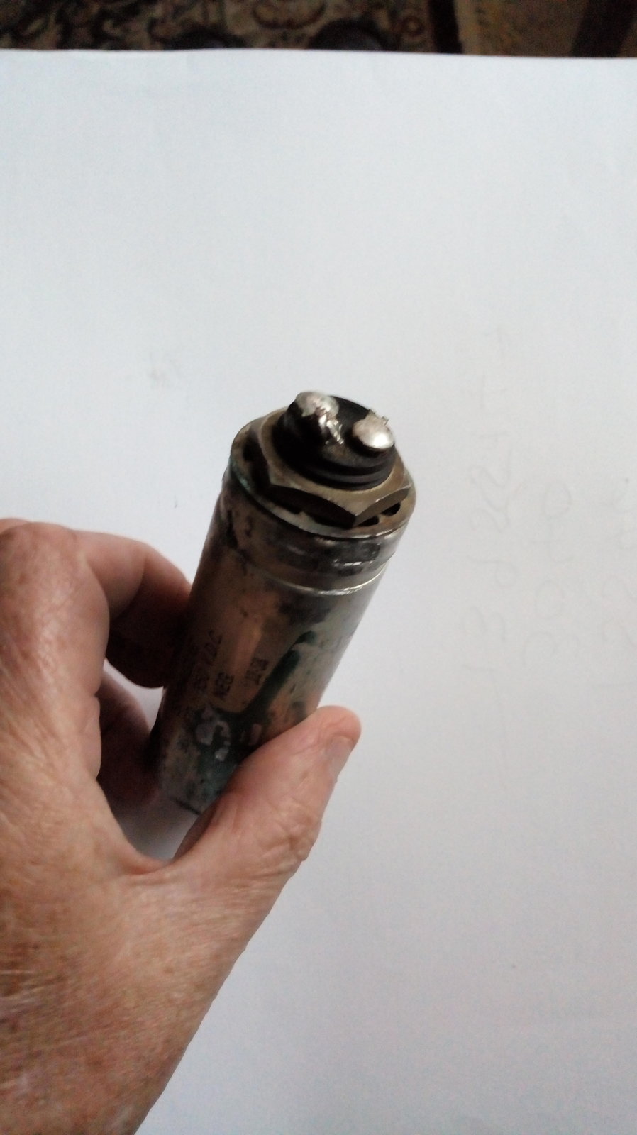

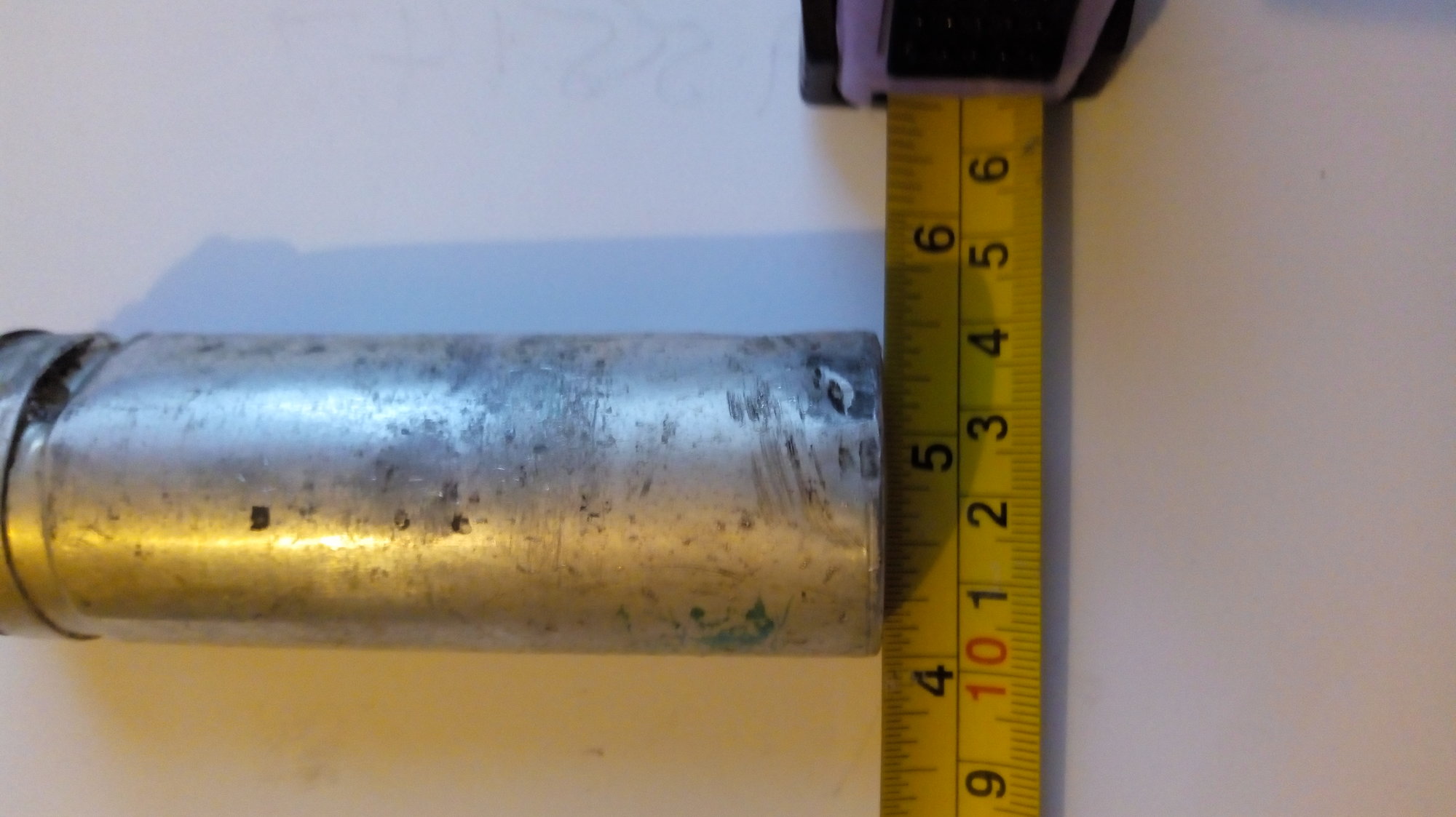

B Bob Page New Member Messages 1 Location England Surrey. Nov 1, 2018 #1 The capacitor on my MF4 has blown.Does anyone know where I can get a replacement or a suitable modern one that will do the job.

T Turbo Member Messages 7,517 Location Fermanagh, Northern Ireland Nov 2, 2018 #4 Look on ebay for a 90uf start capacitor rated to 350v or higher. It will probably be plastic bodied but that doesn't matter as long as it is the same physical size. Aluminium bodied ones are harder to find & are expensive. This guy also has an ebay shop & sells good quality stuff. https://www.electrotechdrives.co.uk/
