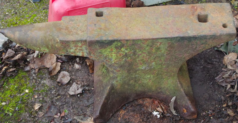

But you dont want it too hard as it becomes brittle.....plus I was told you need "the bounce" but Im not 100% certain what that meansThere are two for sale locally, 300€ and 400€ respectively
Cheaper one comes with a vice
Not that I am looking right now, too much other stuff going on, but I would like one someday. I understand if they are worn you can build them up with hardfacing stick electrodes and grind back down. I have a friend who has repaired several like this. Good for fixing edges that have gotten too rounded over.
It is, but Im not sure what rod is best....the trial I mentioned earlier (50 anvils) was done to try to find out the best method....I think we chose 5 different ways but for the life of me I cant remember which way was the best suited......I recall the build up before hardfacing was best using something about 350 Hv hardness as it "gives" but not too much......and I think going straight in with a CrC deposit was too hard and had a tendency to spall (this stuff check cracks anyway)......but as I say I cant remember (it was 12 years ago) the details.I don't believe these rods I am talking about produce a brittle weld, they are meant to be used on buckets on excavators so if they were brittle I don't think it would work very well. My friend does smithing and he says this is a common method for repairing anvils so I am inclined to think it's an acceptable method.
