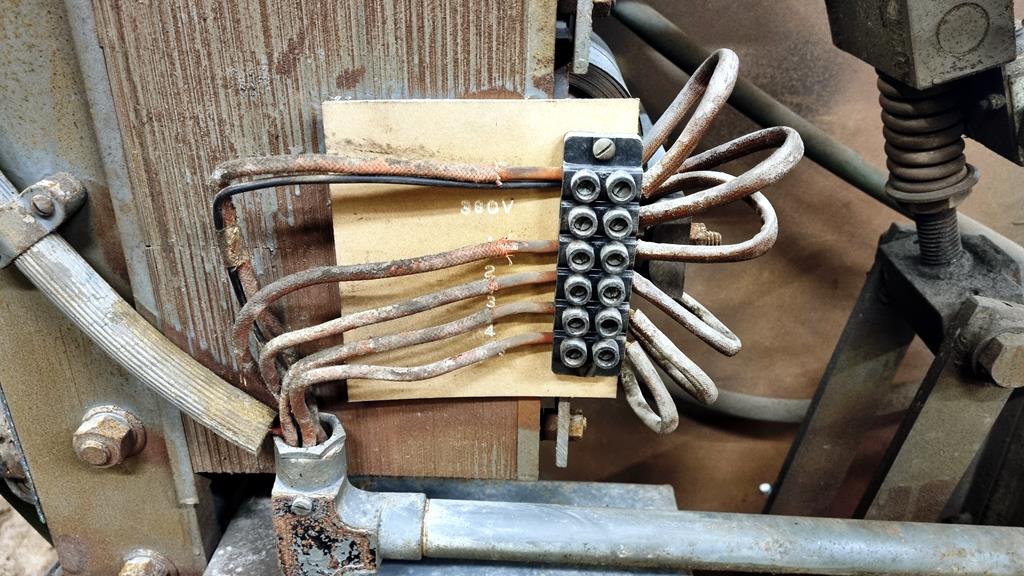

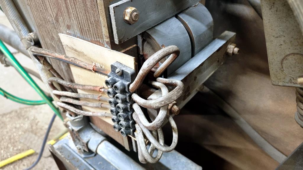

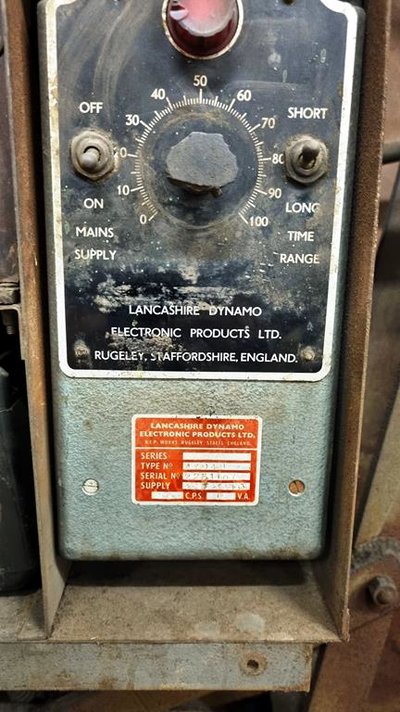

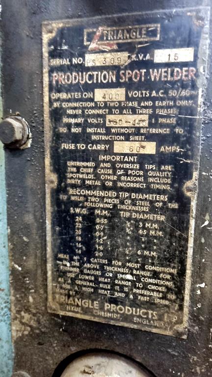

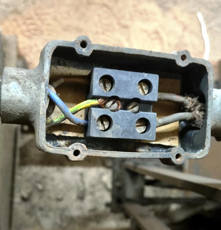

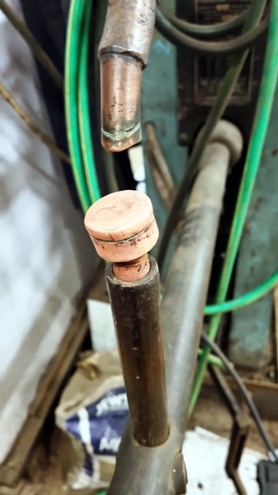

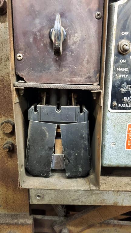

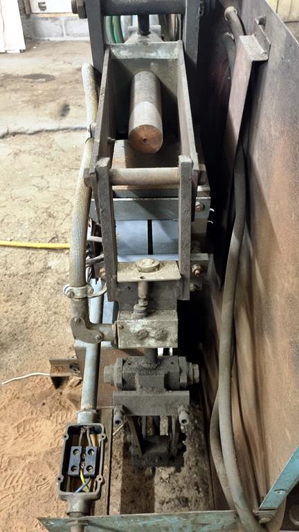

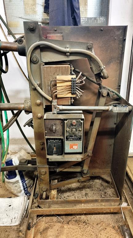

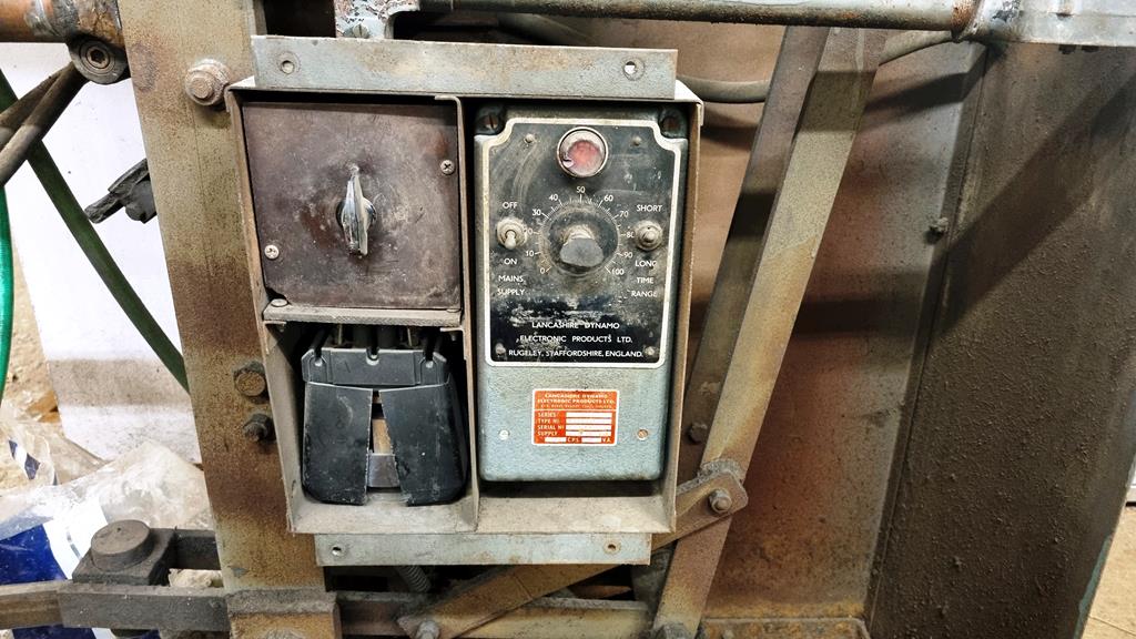

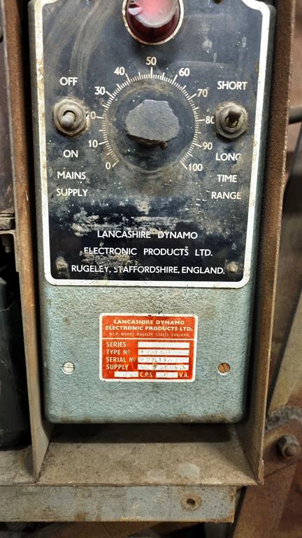

Long story short, this is a Spot Welder at a place I use to do some fabrication and welding. I can use anything in the place as I make myself useful. Latest thing to fix is this spot welder. It worked fine on Tuesday but on Wednesday, nada.
It goes through all the motions, makes all the right noises but doesn't weld, pictures first:
