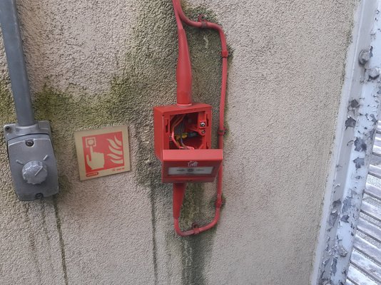

Spot the install issues here.
A nice game of spot the mistakes here.

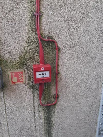

The unit is located out side, South West facing wall.
The gutter above is blocked.
The stain is a water mark.
This is 2 years old and fitted by a National Company. I can not name as I feel this will end up messy.

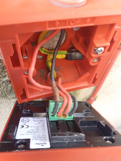

Oh yes, what can't be seen is the not fitted second screw. Only one was used.
