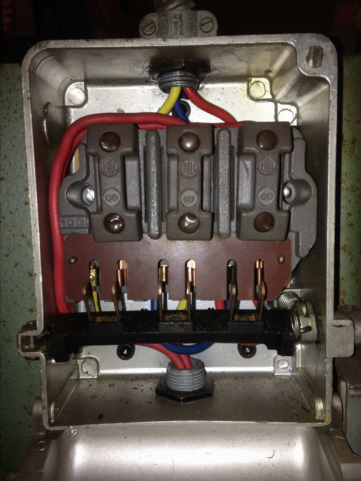

Can't get continuity between any cable entering isolator block. As far as I can see three phases enter, one terminates in fuse block and the other two continue on into machine.
I have continuity across the slydlok fuses and across the wire leaving the fuse labelled no2 but not across no1.
This might be going over my head (electrics not my strong point) but surely a machine cannot work on two phases and no Earth or neutral?
