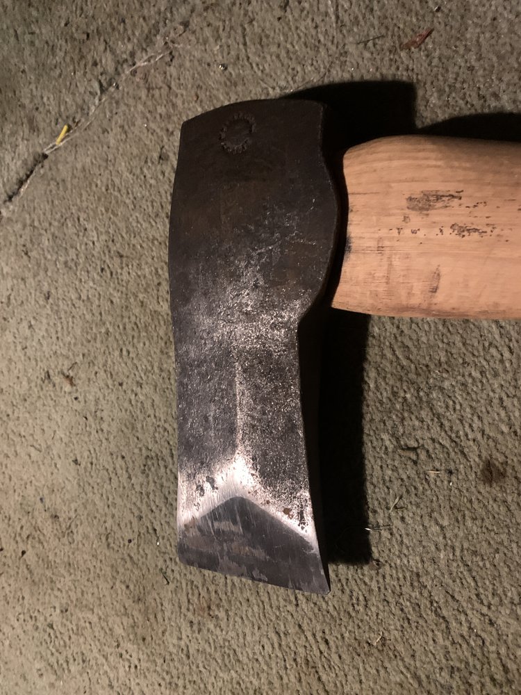

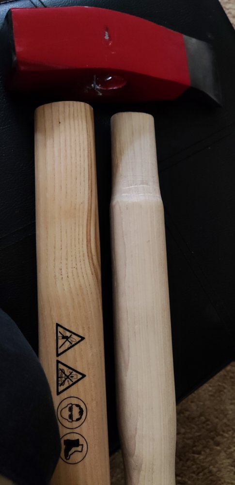

It's the log splitter, but i'd have thought a 3kg head would have had a shorter handle, if the snapped one is 36" it should do. I wouldn't even think about trying to repair the old one, it will let go sooner or later (probably sooner) and could go anywhere.

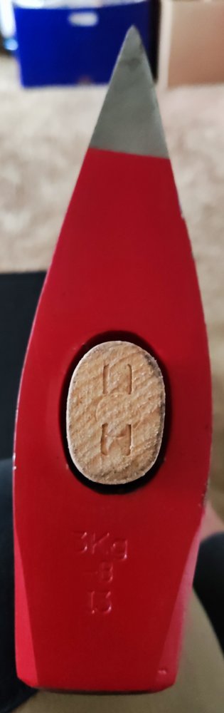

Last one I did I mixed some Araldite in before I put the wedges in, every little helps.That handle you've bought is ok, and the gap will disappear with the wedges and stop the head coming off.
I'm not saying not to do it, but i've fitted thousands of handles to British standard and never used glue. The wooden wedge spreads the shaft and is responsible for holding it on the steel wedges are fitted to stop the wooden wedge from coming out.Last one I did I mixed some Araldite in before I put the wedges in, every little helps.
