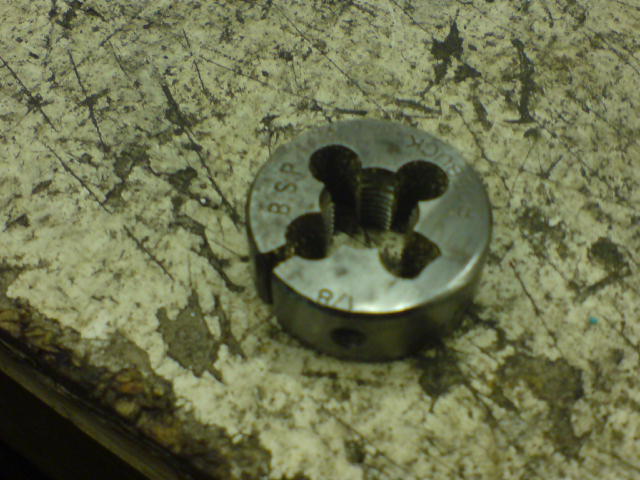

here's a 1/8" bsp die I broke a few years ago, attacked it with the mig and its stlll being used to this day.
You can in a pinch but it's similar to cutting flutes into a bolt to make a tap, might get you out of a hole but not the best.
Disagree. A solid die will still be hardened correctly and usually has the correct detents for opening and closing. I have put a slot in several cheap chinese dies and they work supprisingly well for a quid each delivered, functionally identical to the real thing.
