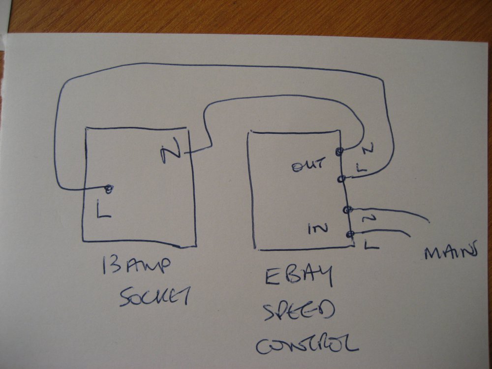

Gerry, Aldi and Lidl both do variable speed 125mm angle grinders now and again, Both priced at around £29-99, I have had one for a few years and been well used and has been great,

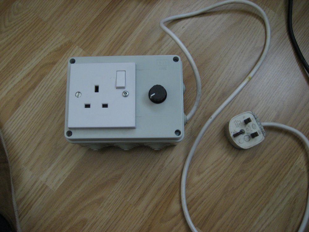

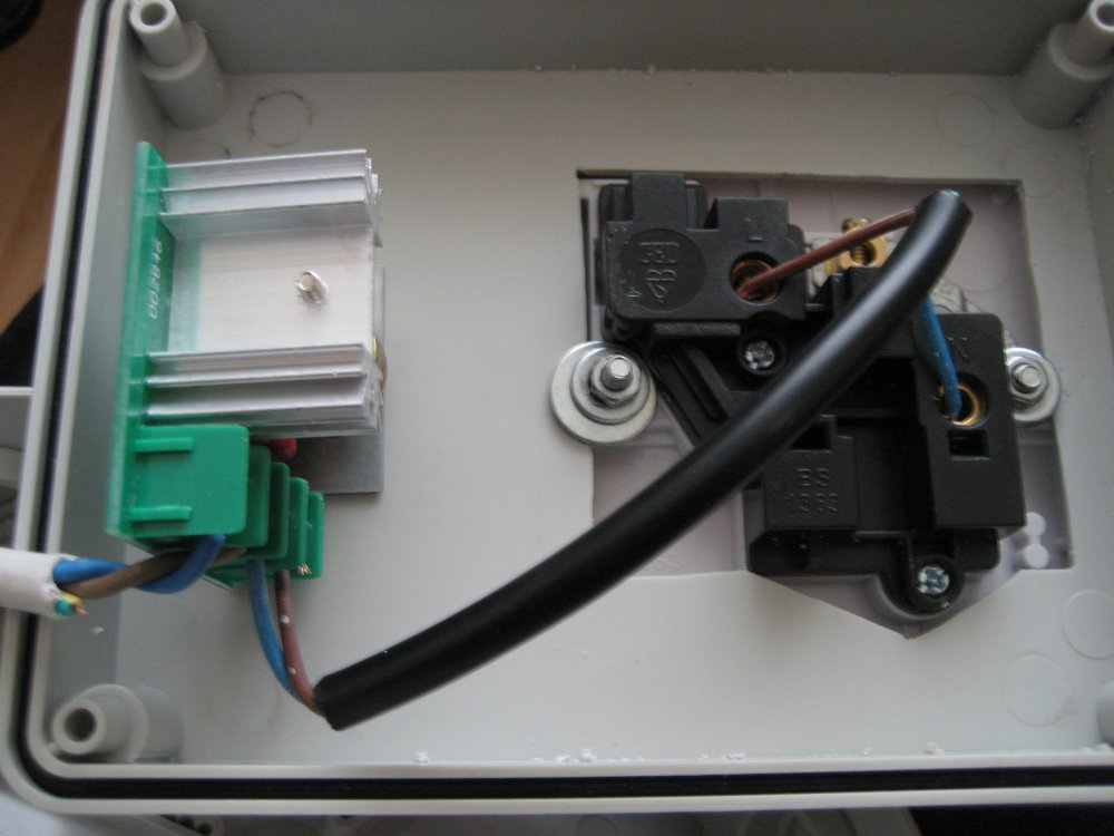

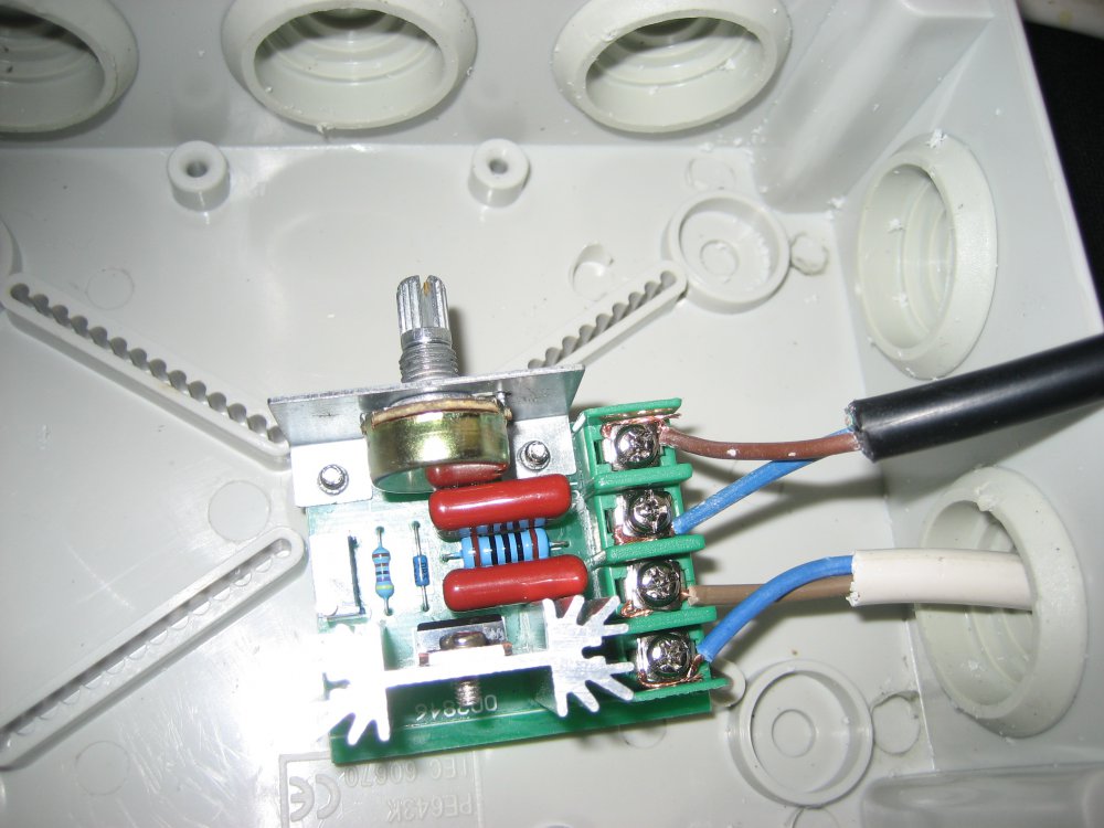

I have two of those Aldi grinders and they are perfectly good though I don't use them in a business environment. Actually I Rob the speed controllers out of them and run then at full speed. You could do the same, then you'd get a cheap controller for your grinder and a spare full speed one for peanuts.
