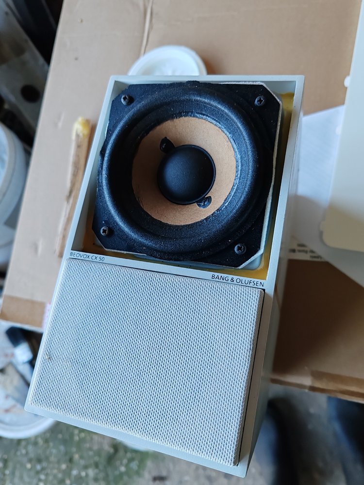

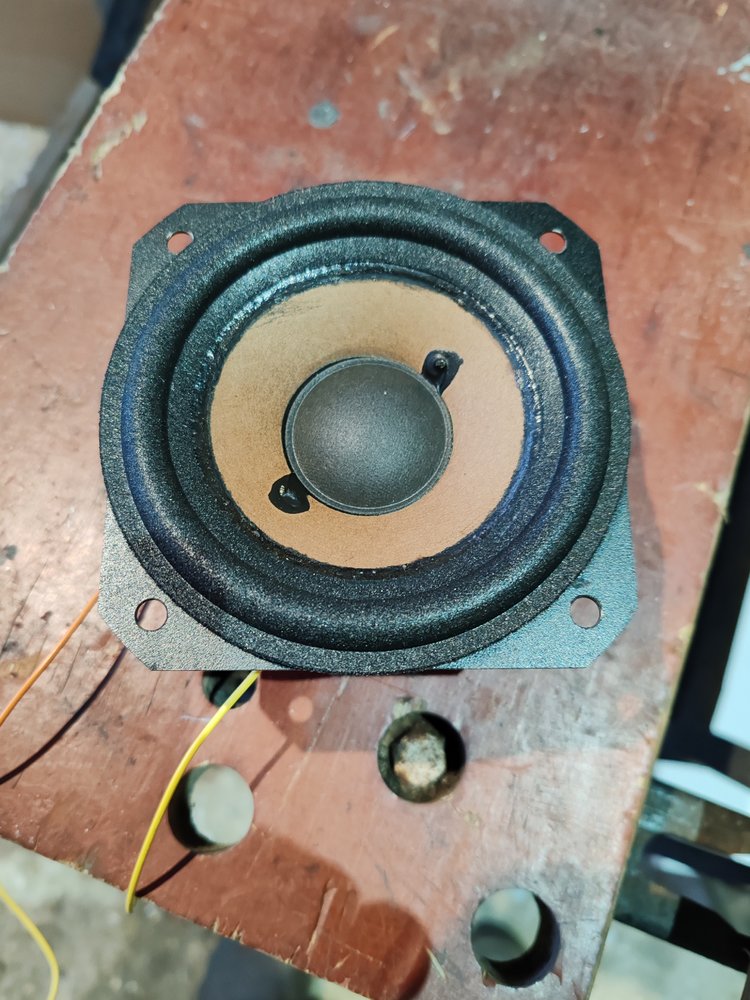

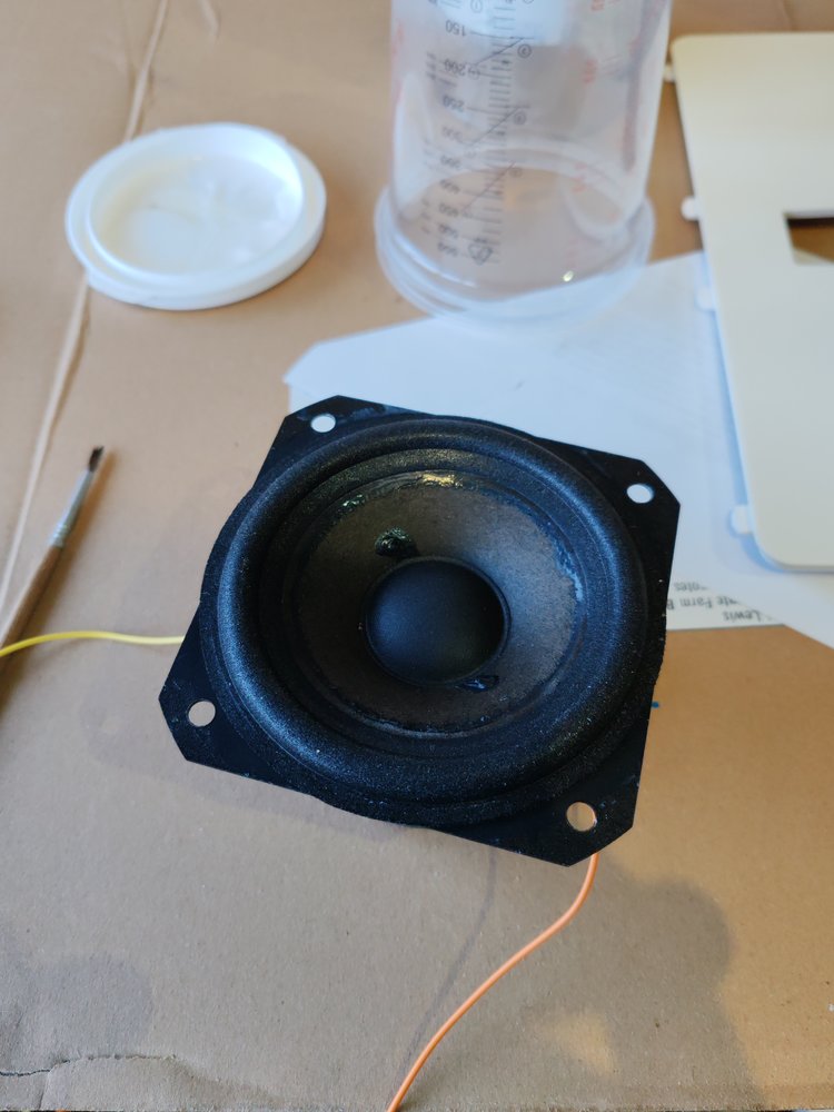

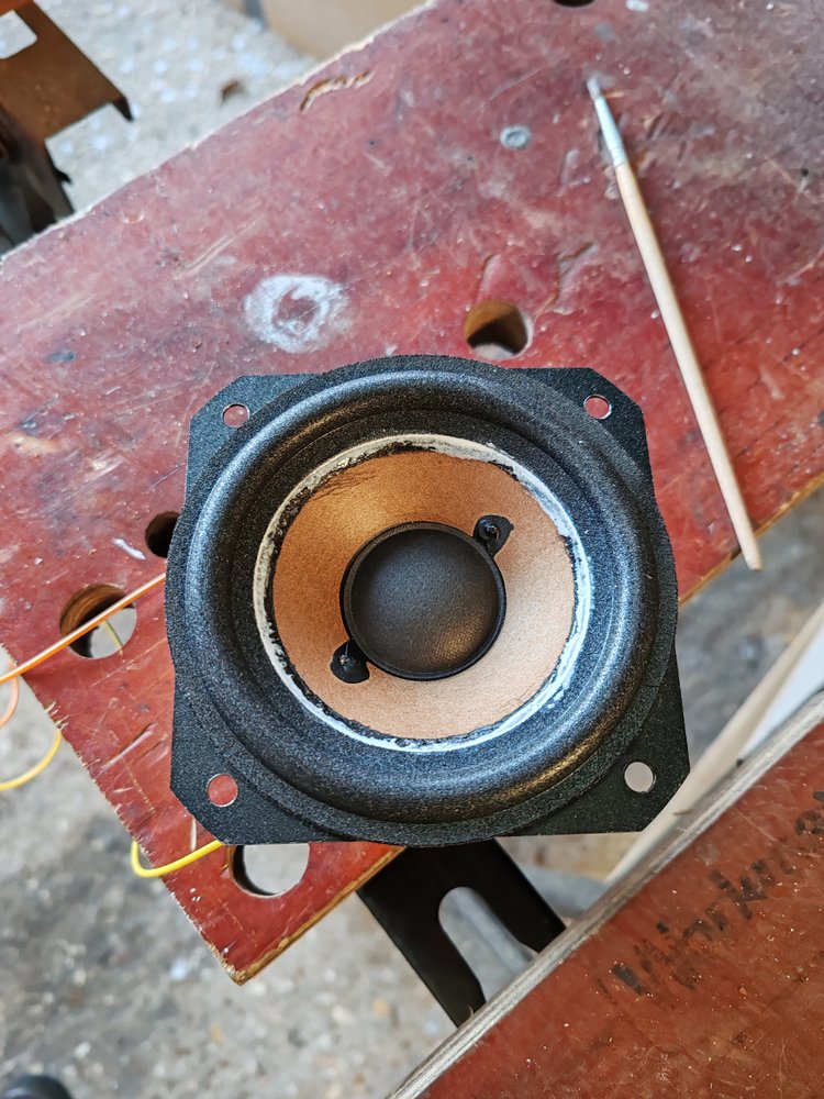

The dust cap is really well stuck and is keeping the cone in shape nicely, if I go near it the paper cone will be destroyedIt’s quite essential to take the dust cap off and Centre the coil, otherwise it may rub against the magnet
The cone is supported at the base by a concertina shaped thing so its all well lined up, you really have to push the cone out of place to feel it catching anything so its just deciding on glueThe cone support is the only mechanical centring.
