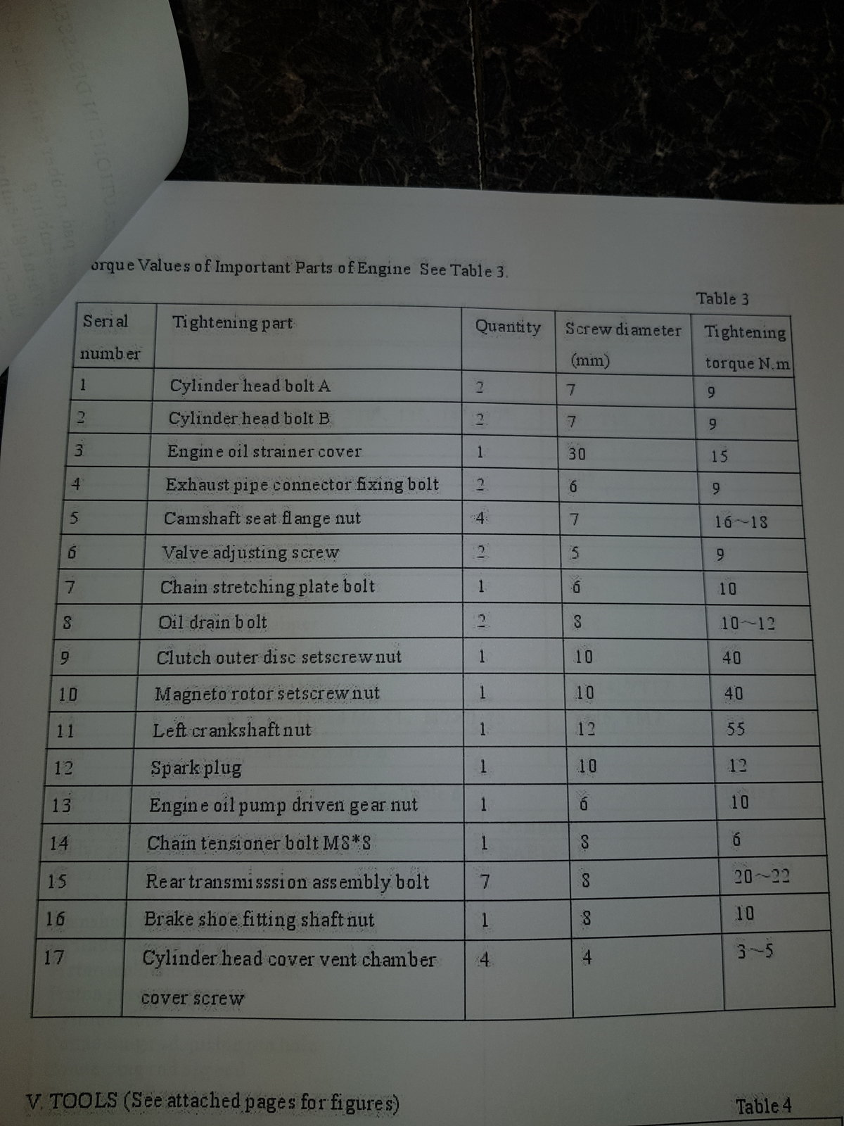

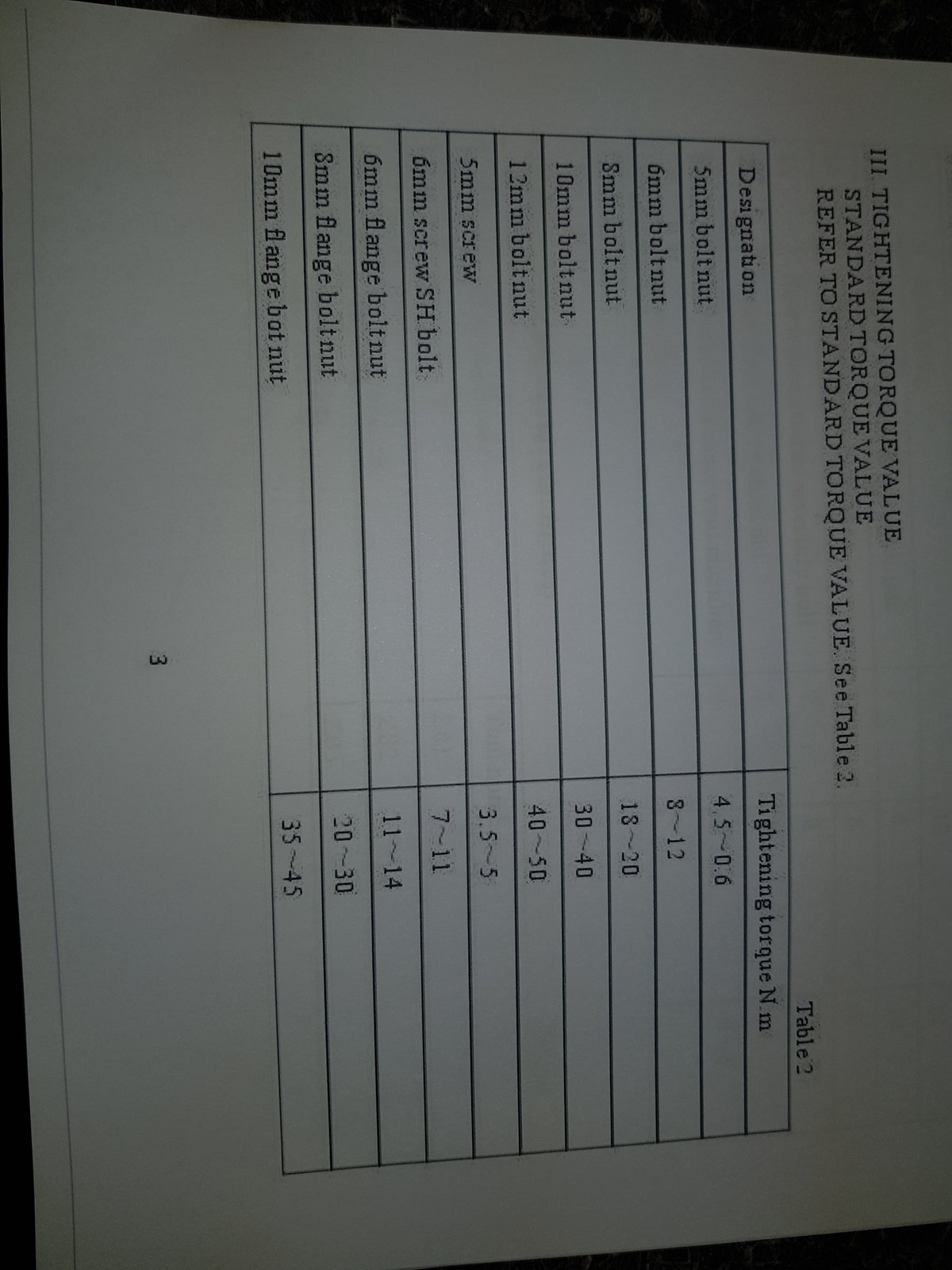

These are general torque settings, hope it helps
Standard Torque Settings
M5-Bolt or Nut--5Nm
M6-Bolt or Nut--10Nm
M8Bolt or Nut--21.5Nm
M10Bolt or Nut 35Nm
M12Bolt or Nut 55Mm
M6Bolt or Nut flanged head 12Mn
M8Bolt or Nut flanged head 27Nm
M10Bolt or Nut flanged head 40Nm
M5-Bolt or Nut--5Nm
M10Bolt or Nut 35Nm
M12Bolt or Nut 55Mm
