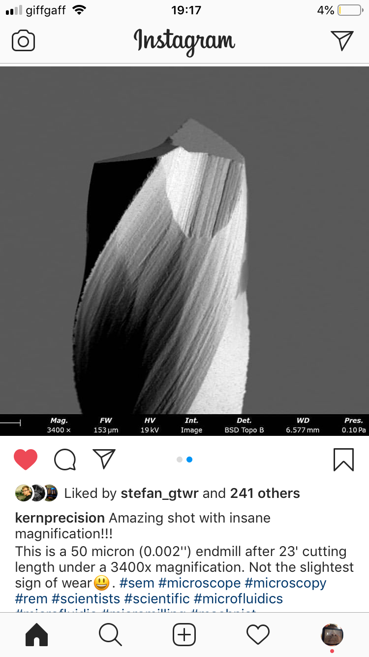

saw this on Instagram, a two thou end mill!
and do you do conventional or climb milling with it.......I get nervous using 1mm milling cutters

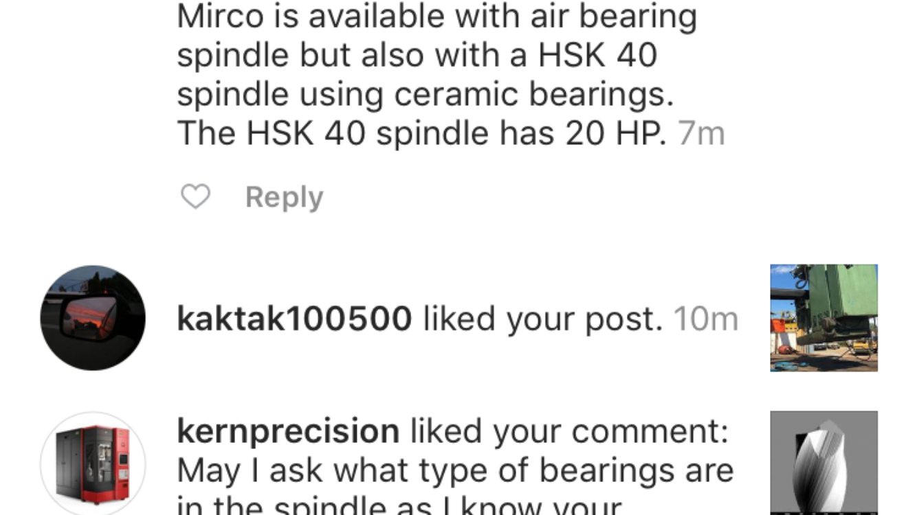

Kearns can really hog metal off so maybe ceramic?That is cool. I wonder what cutting RPM they used, and how on earth they kept that cutting with no runout. Must have been an air bearing spindle and about 50k rpm I guess.
Actually I’ll just ask them!That is cool. I wonder what cutting RPM they used, and how on earth they kept that cutting with no runout. Must have been an air bearing spindle and about 50k rpm I guess.

I got a reply, spindle speed is up to 70000rpm!!That is cool. I wonder what cutting RPM they used, and how on earth they kept that cutting with no runout. Must have been an air bearing spindle and about 50k rpm I guess.
