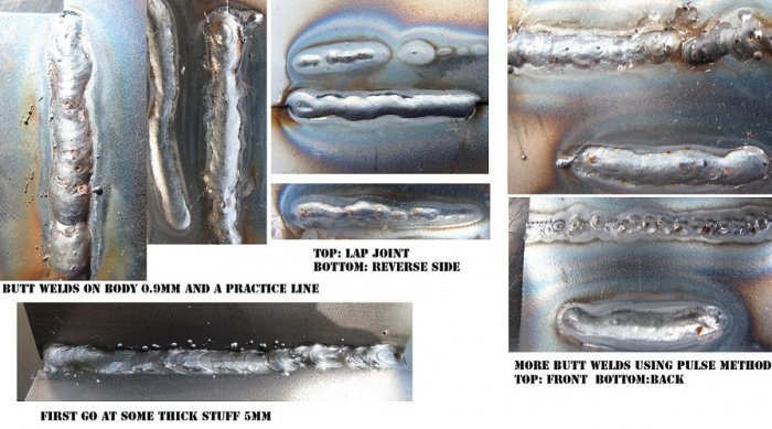

Had my first welding related injury today.
A neighbor came round as I had just finished running a line. After a quick chat I went back to what I was doing. I grabbed a piece of metal that I had just been welding
It started ok but the angle of the torch must have changed as the weld is wider on the bottom piece than it is on the upright piece.
I gave it a good slap with a club hammer, there was no movement and it sounded very solid.
I welded both sides of the upright piece, the other side which wasn't pictured, was more consistent angle wise but didn't look so good as I was working out wire speeds.
Going by something I read somewhere, having the contact tip slightly proud of the shroud can help on that sort of weld. Won't be trying it myself as I can't afford to be buying more shrouds and tips on top of the new gloves I need.
My Mig tip is slightly proud of the shroud but I think that is not the best for ensuring good shielding gas coverage.
At the time I thought pull gave more penetration but less gas coverage.
