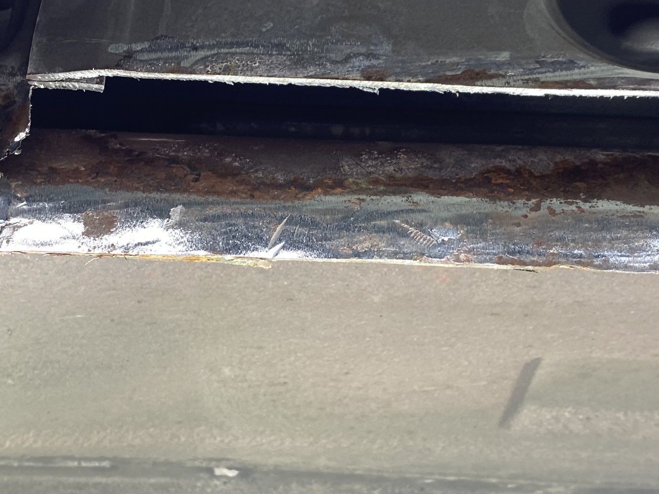

MOT failure on rotten sills. Nearside had to have the inner plate repaired before the outer was replaced. Offside was a bit more fruity with the rear part of the sill rotted out too. I made a mistake on the nearside (no pictures) where I seam welded the bottom of the sill, rather than plug weld, which would have been easier. The job is still waiting for a dry day for me to finish the stitching, hopefully tomorrow and is just weldthrough primered in the meantime.
These photos are all the offside...
