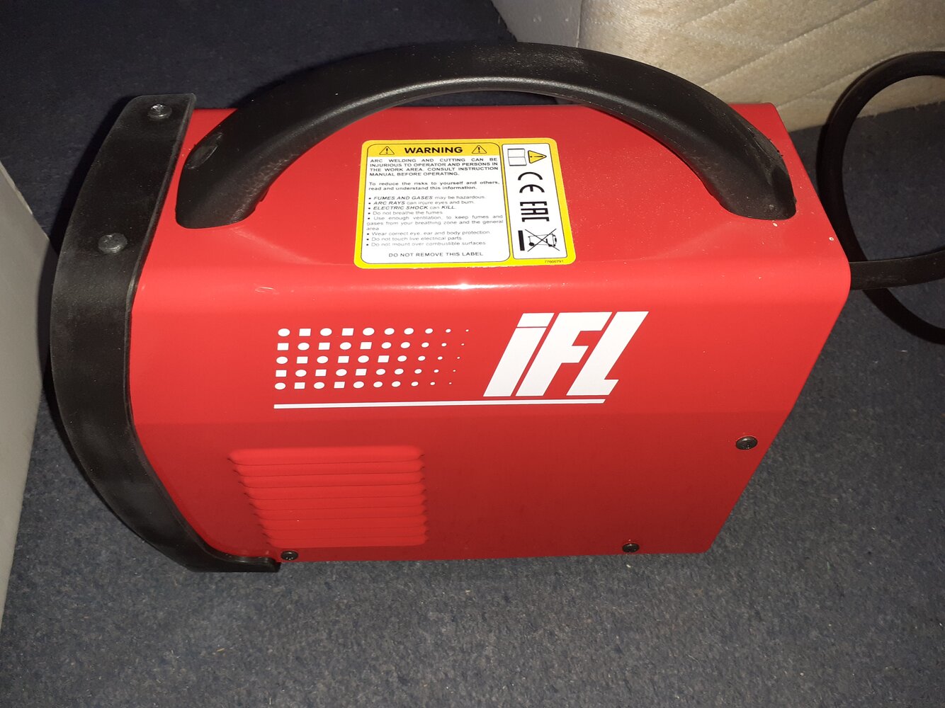

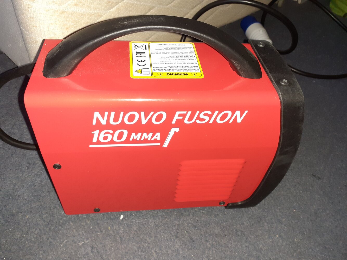

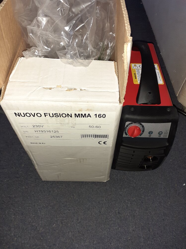

This isn't a review of the welder, just some random beginner trying out a refurbished MMA inverter welder.
The machine is sold as professionally refurbished stock and looks practically new. It's claimed amperage range is between 10-160 Amps. It also claims to have hot start, arc force and anti stick. As I've no experience on these features, I can't really comment up on them.
I bought it from Inverter Fusion Ltd in Honiton, for about £120.

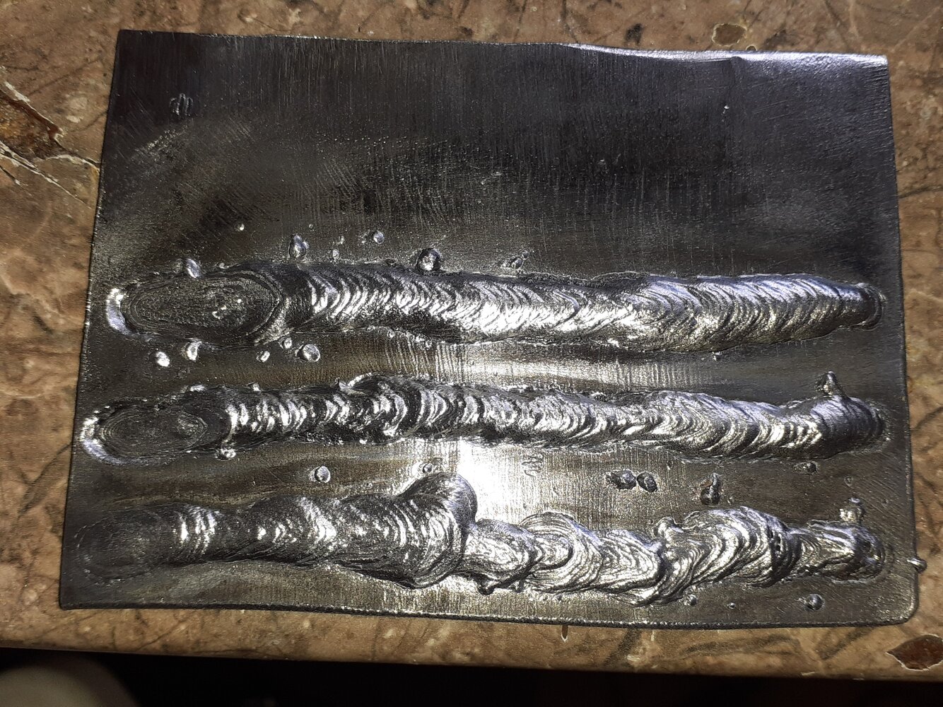

I ran three separate beads on a 4mm piece of mild steel plate. The one in the foreground is 2.5mm E7018 @ 90 Amps, the second one is 3.2mm E6013 @ 110 Amp and the last one is 4mm E6013 @ 160 Amps. The first weld was wobbly, my own fault.
I just wanted to see what the welder was capable of. I did notice some arc blow (I think), towards the ends of the 3.2mm and 4mm beads. There are appears to be some deep cratering at the ends, even though I hovered over the ends and went back over the last half inch of the bead. This welder seems to run the rods a bit more fiercely than the Impax welder. The arc seems to be more active and throws out more sparks than the Impax, even at the same settings.
