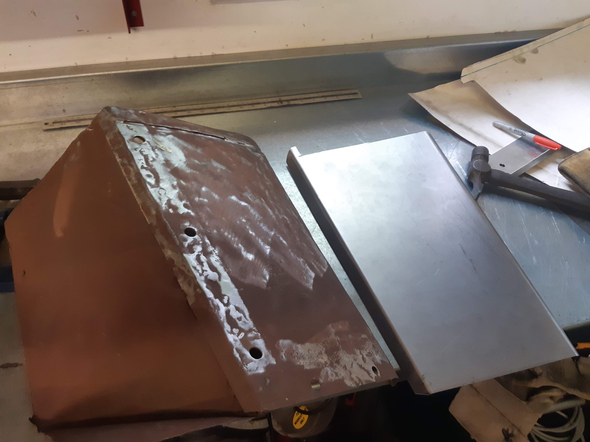

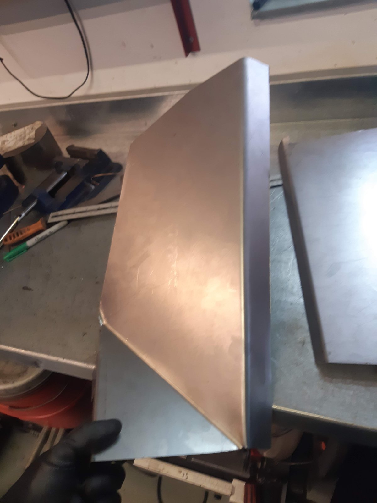

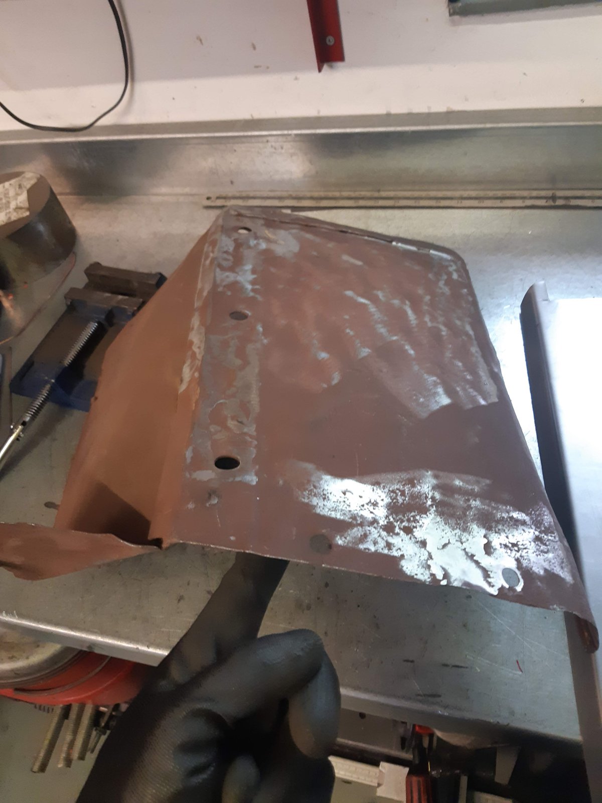

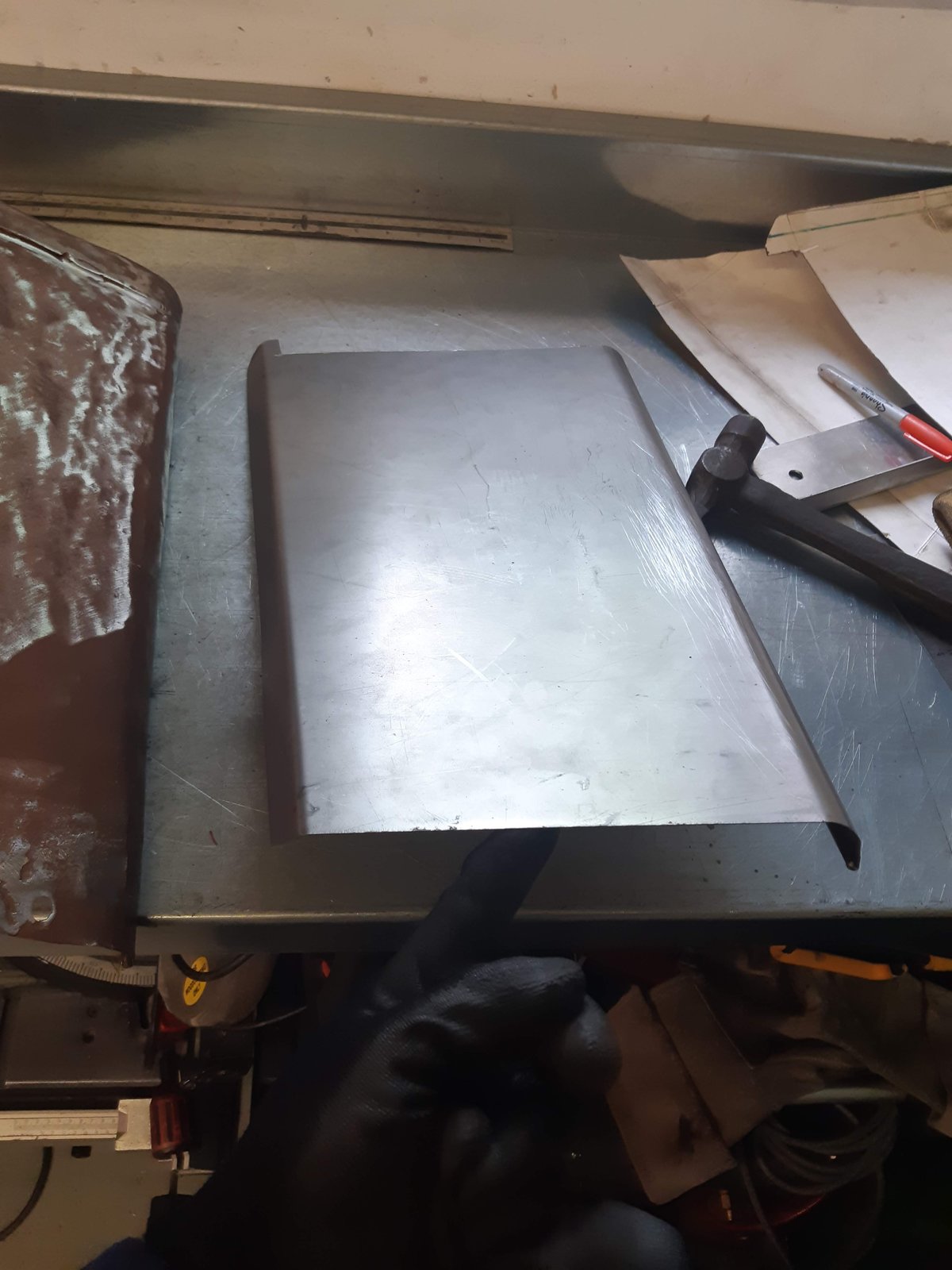

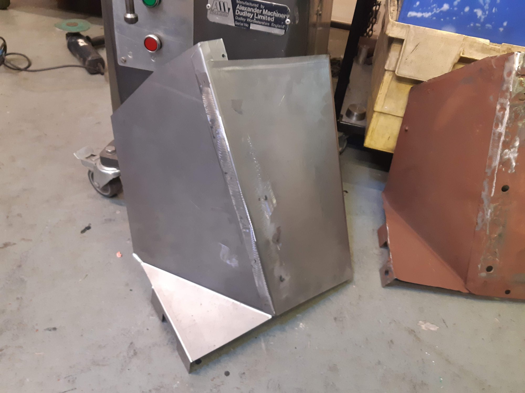

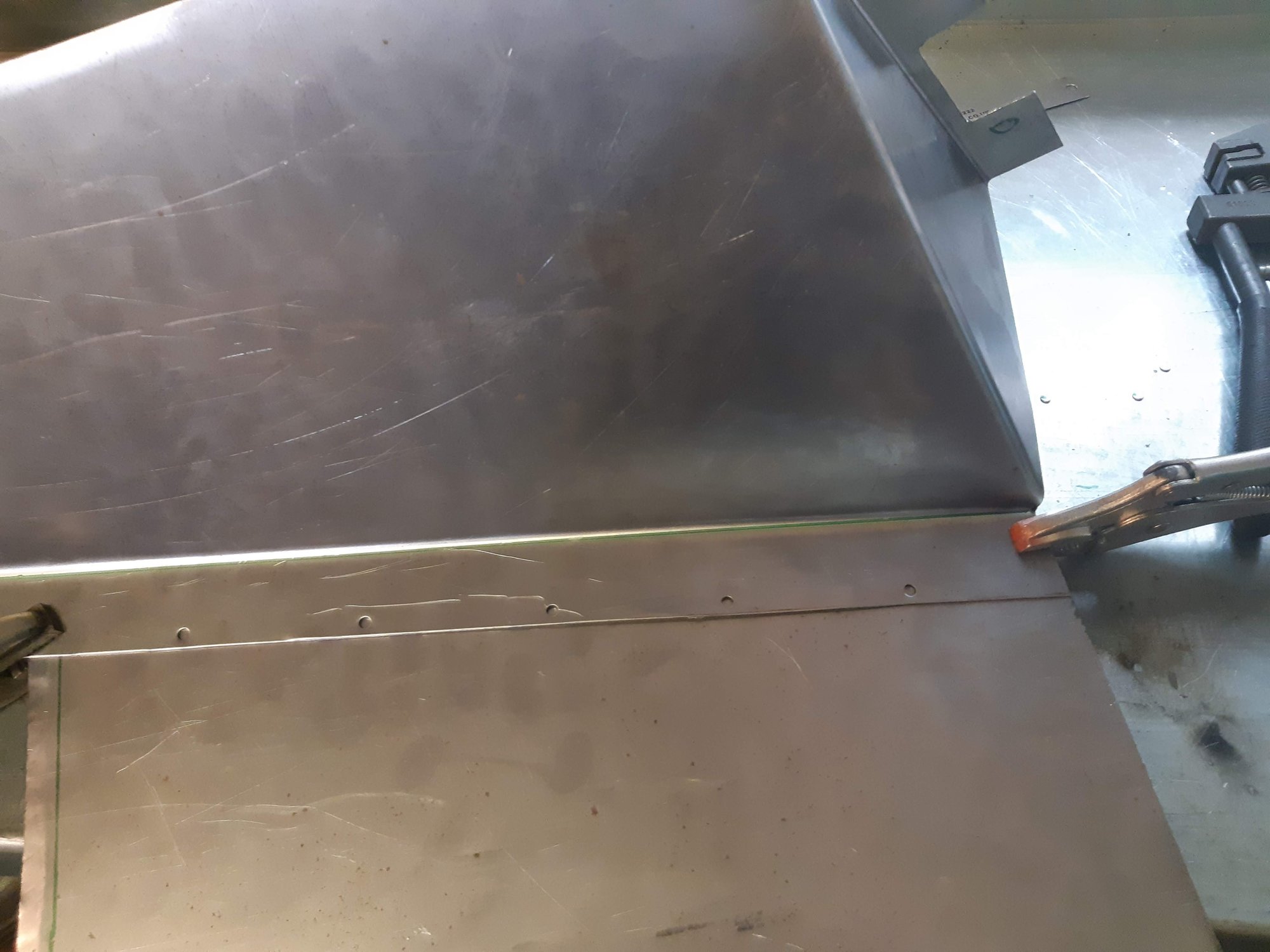

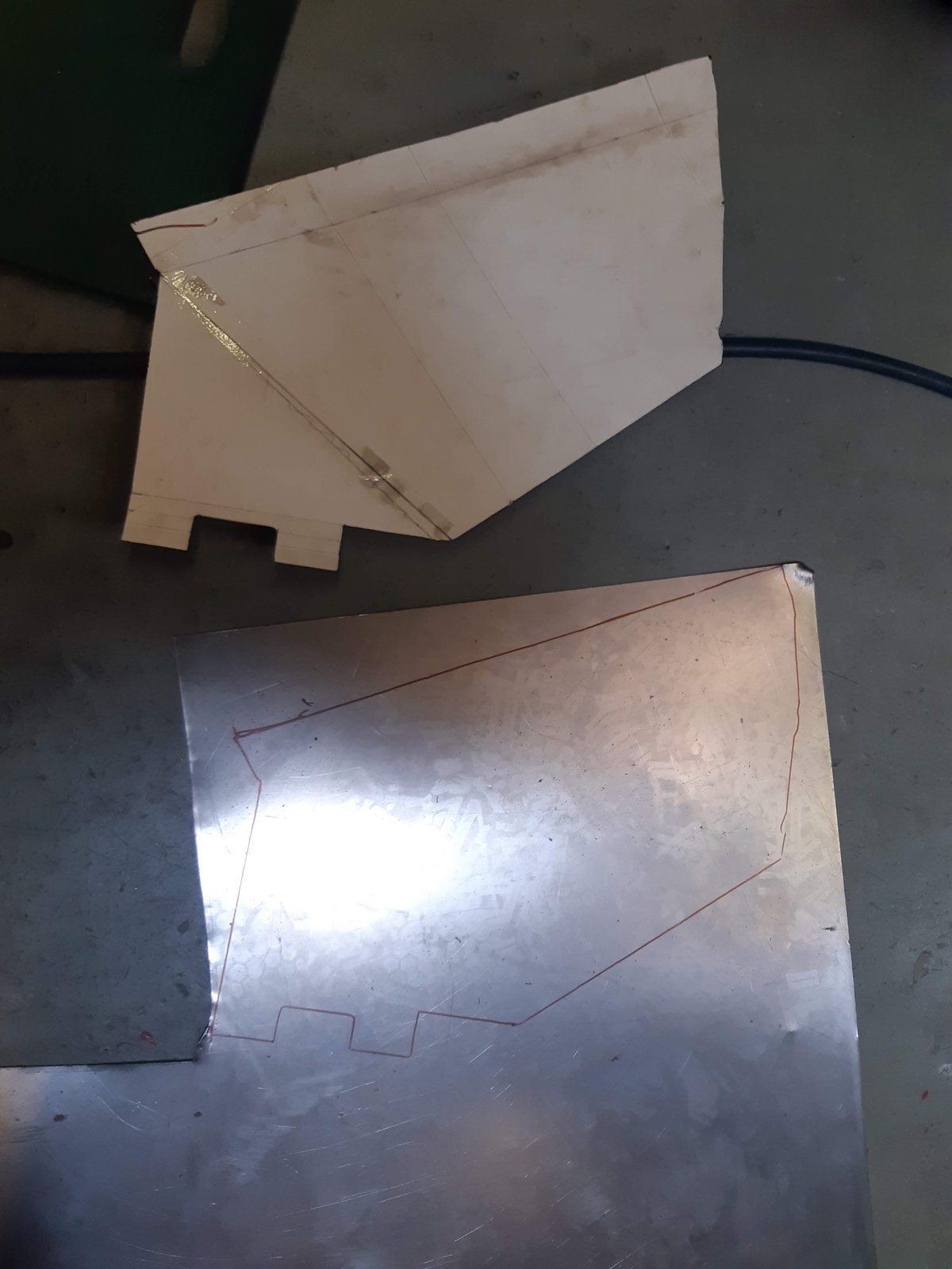

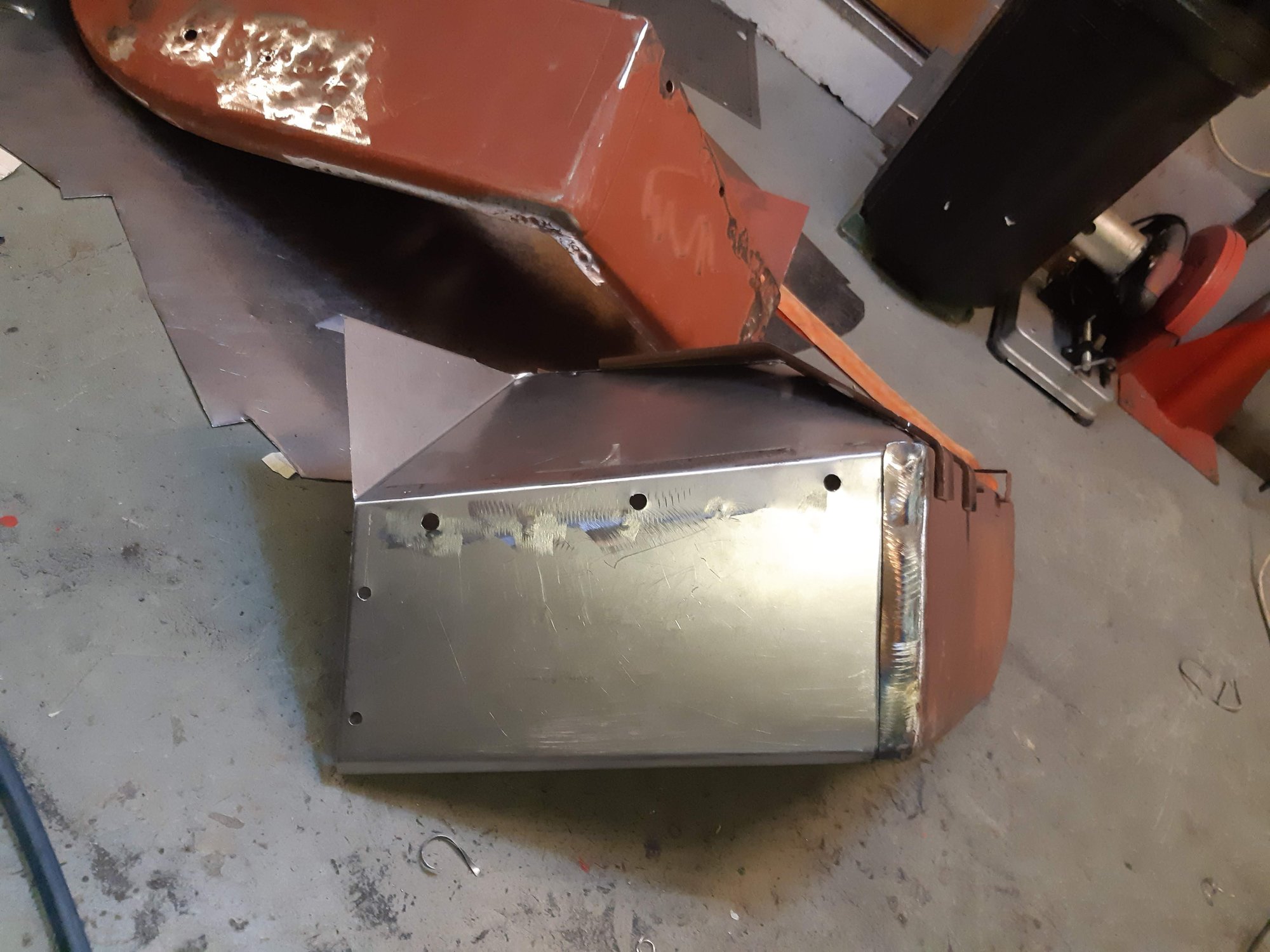

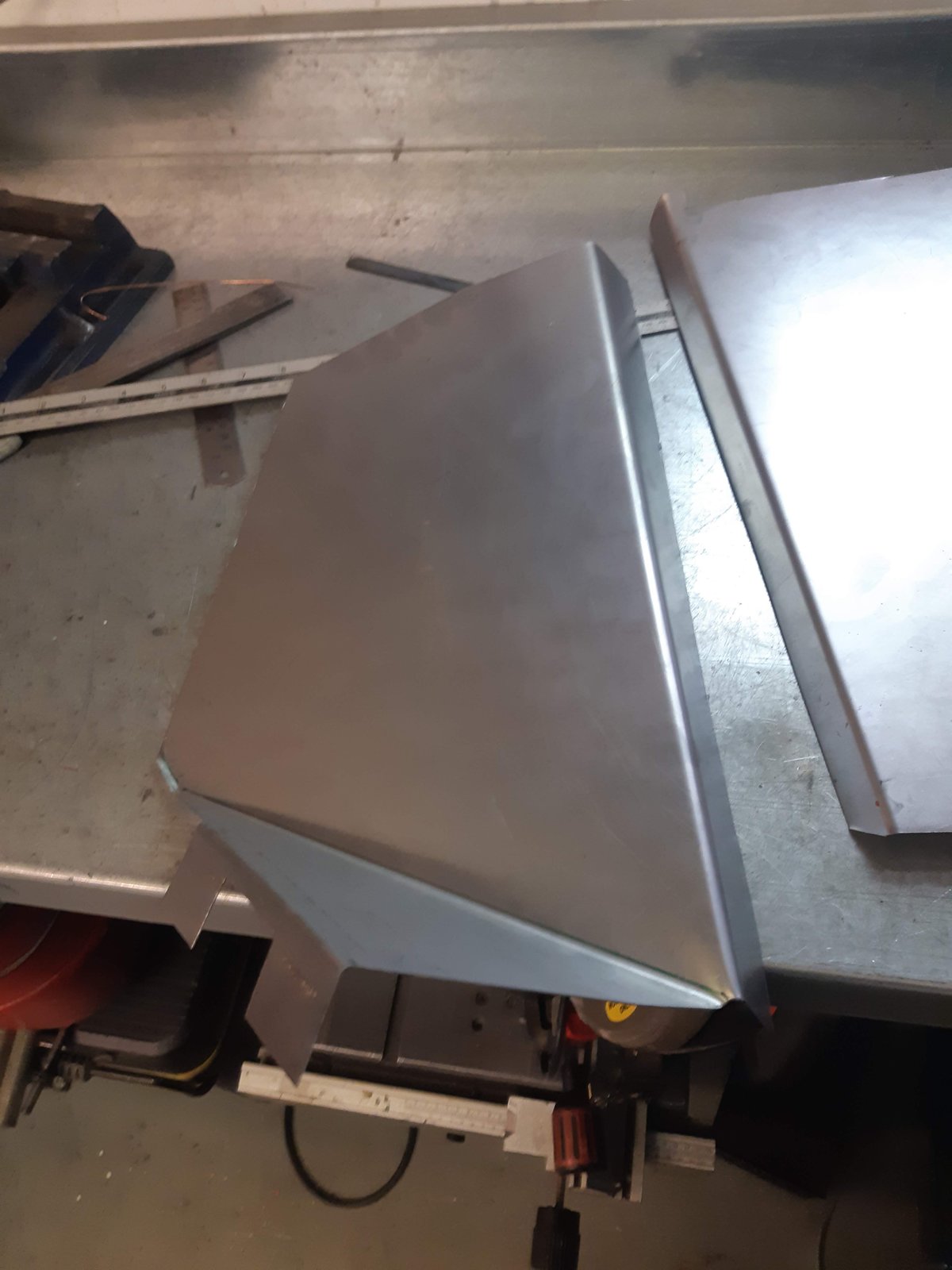

Fazerruss Member Messages 3,228 Sep 27, 2020 #1 This is a front wing for a WW2 jeep. You can see the old one in red oxide has had the crap beaten out of it so I made a new piece from 0.9 mm sheet. It was a bit of a faff due to having to recreate a rolled edge and a slight curve.

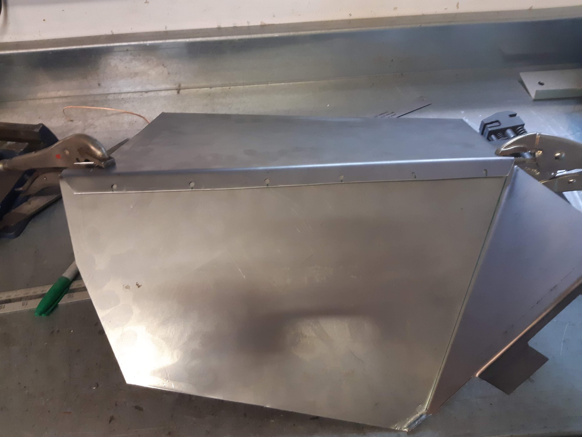

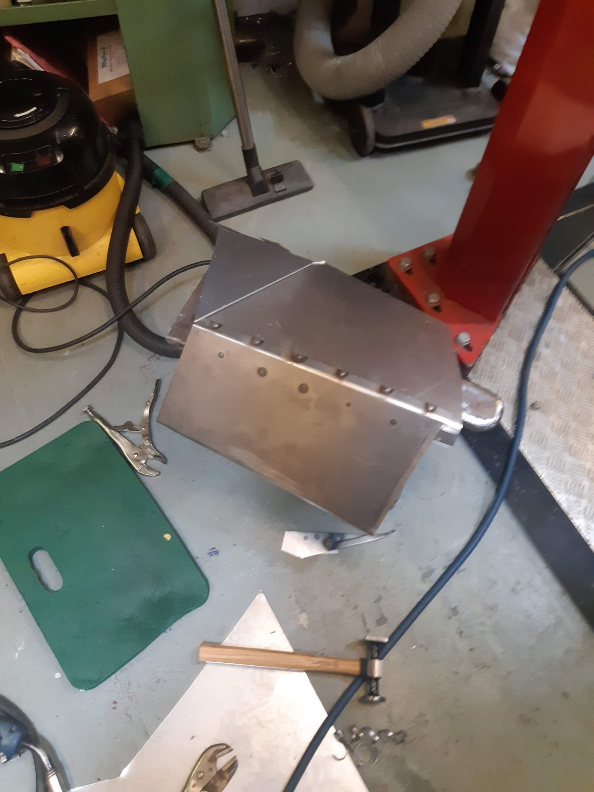

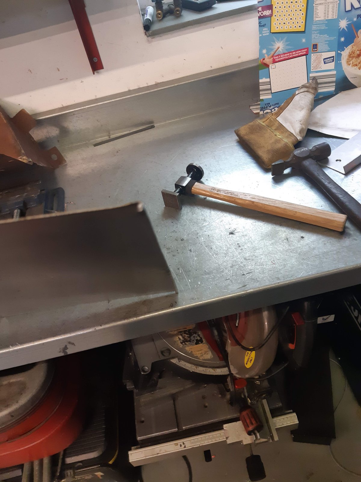

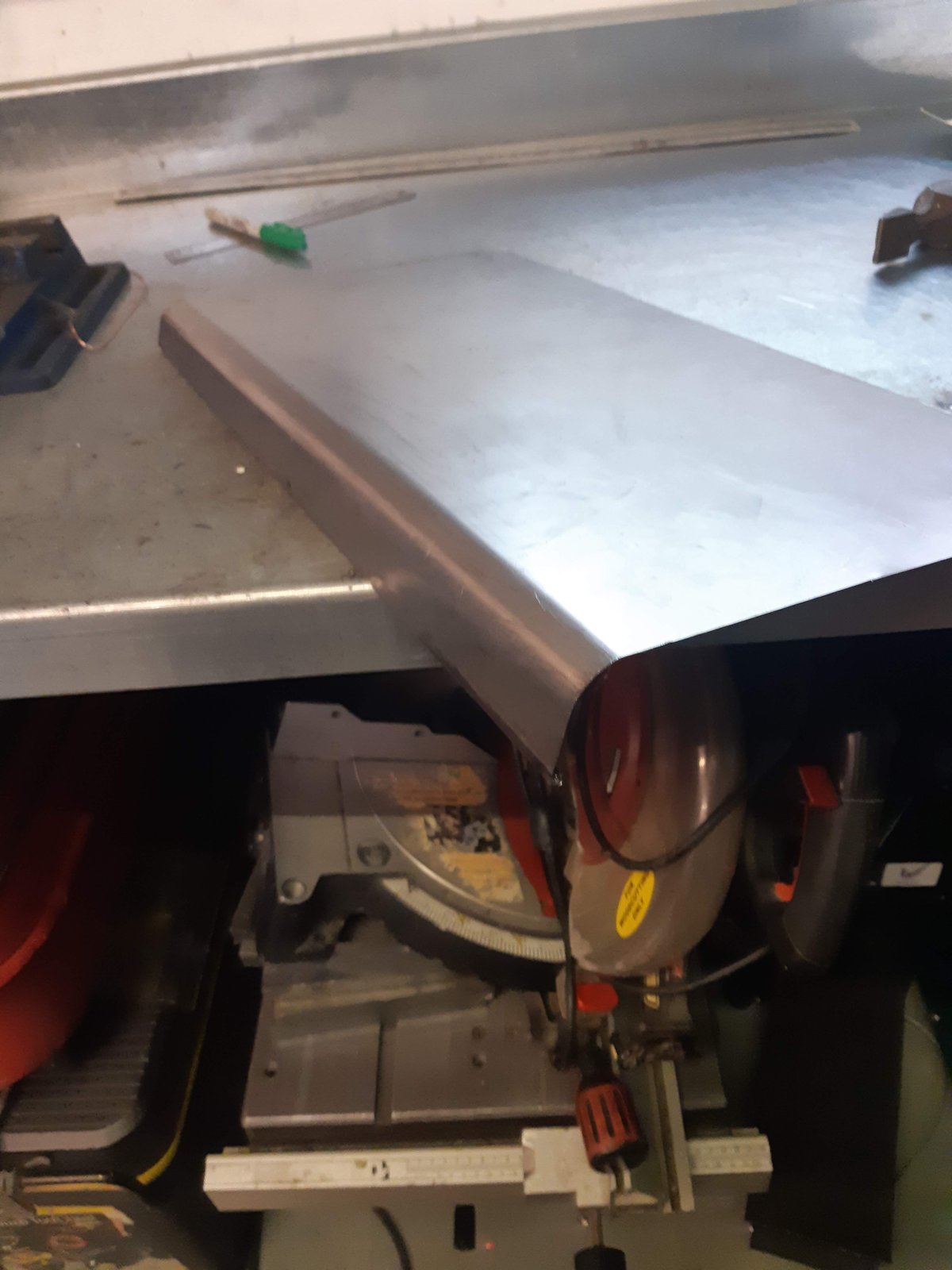

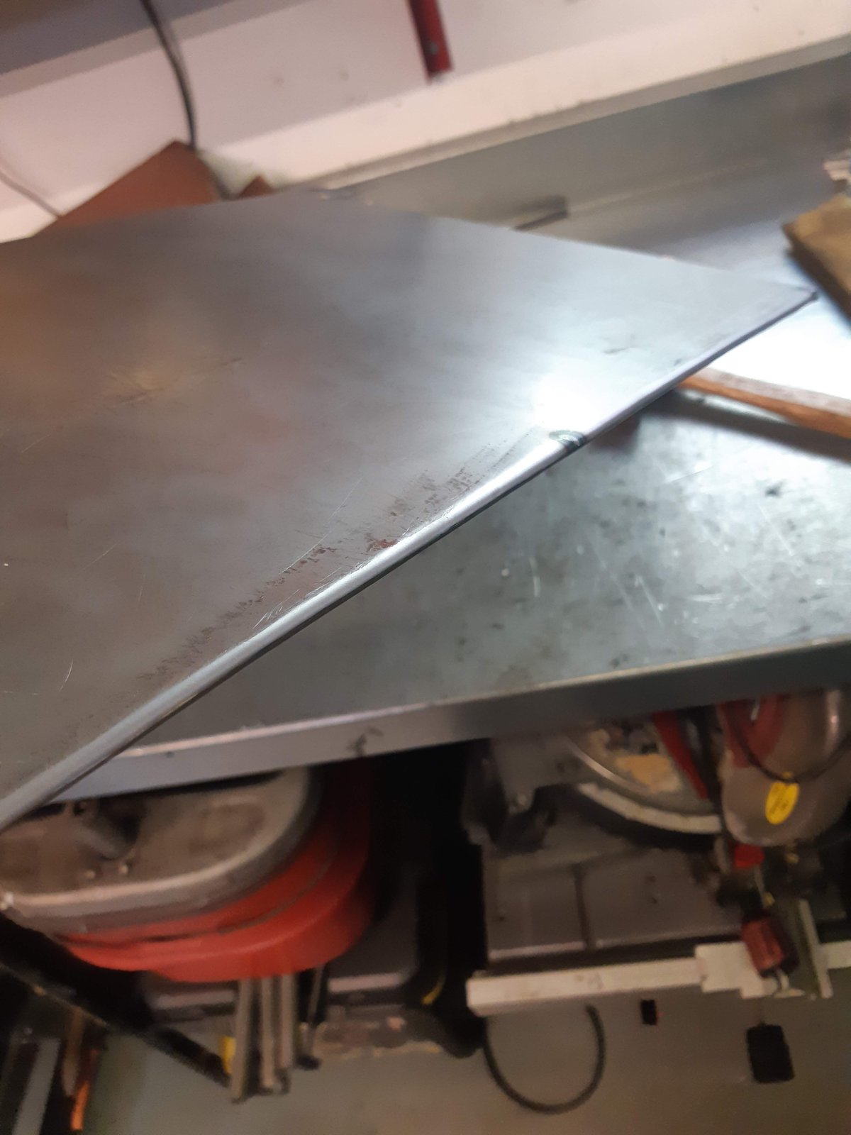

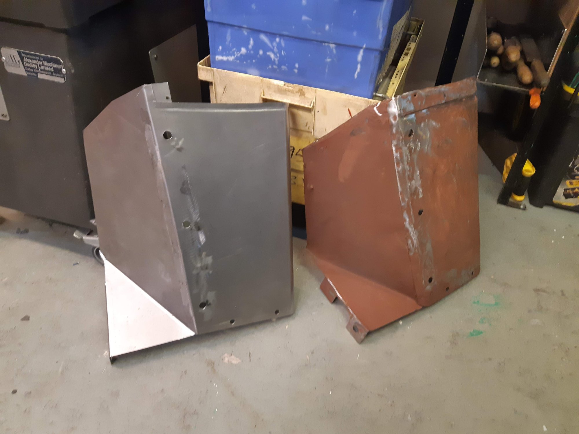

Fazerruss Member Messages 3,228 Sep 27, 2020 #5 Just needs a final bit of fettling with a sanding disk then done.

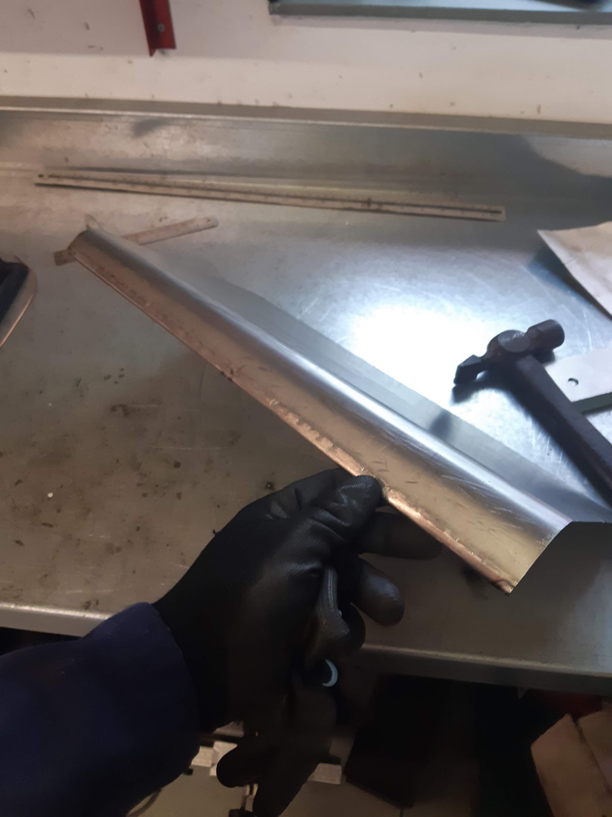

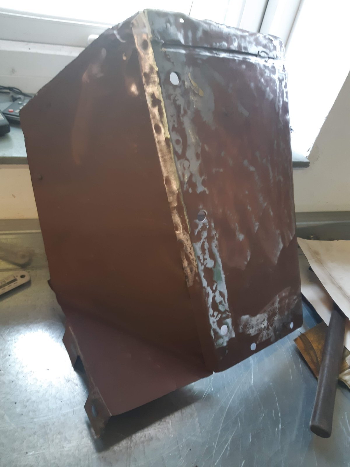

Fazerruss Member Messages 3,228 Sep 27, 2020 #7 Thanks. The owner could have bought new but wanted to keep as original as possible. Triggers broom springs to mind
