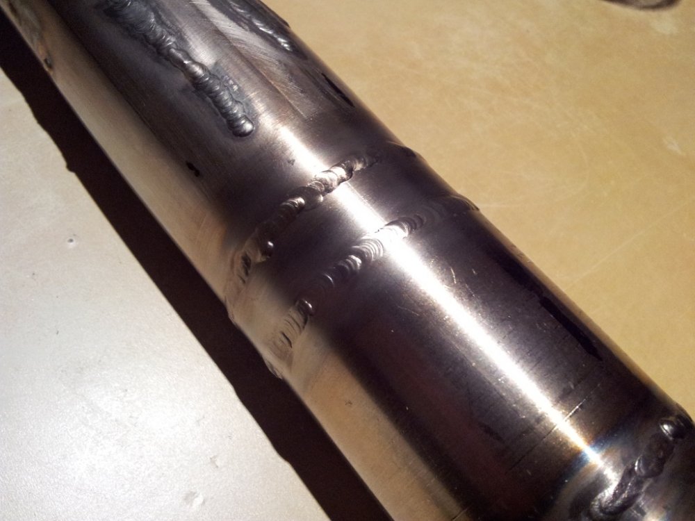

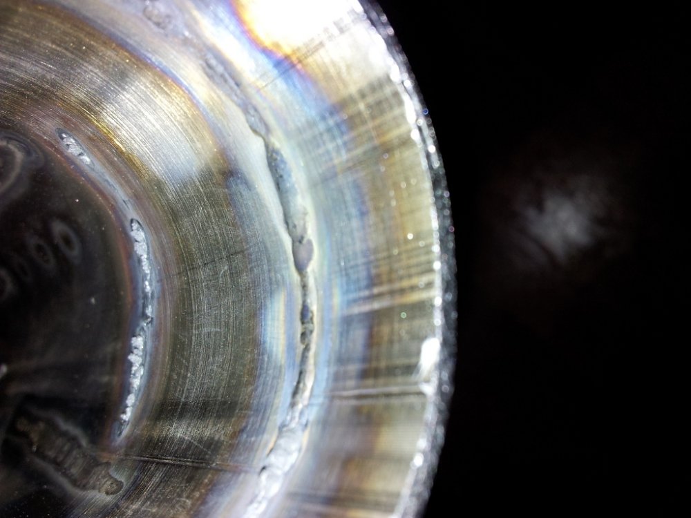

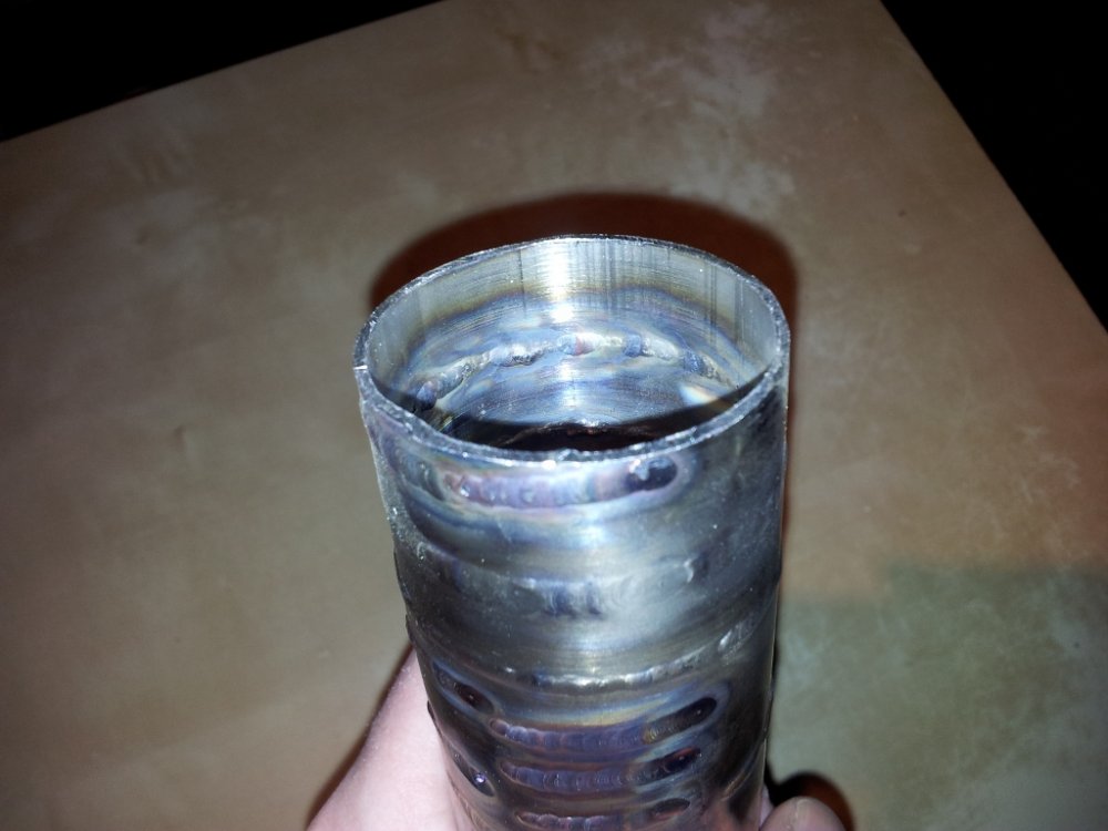

So my final weld turned out to be two. I made one with 45/20 amp split at 100Hz, it came out nice on the outside (first pic) on one half (the other half I somehow could not tune myself in), then I cut the pipe to see the inside (second pic) - not so good, penetration lacking in some places and I also forgot to turn on the back purge for one of the sections. But since I just had the pipe cut, I welded it again now at 50/20. This came out way better (third pic, the weld to the right), although it seems a bit more erratic on the pic, in reality it is much more uniform than the first one. Also I can see from the distance that the inside came out much better, but I am too lazy to cut the pipe again to check, perhaps on Friday.

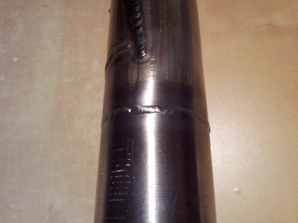

So the inside of my last weld, better than the previous one, but still missing it in places. I guess I could have welded it with more juice still.
