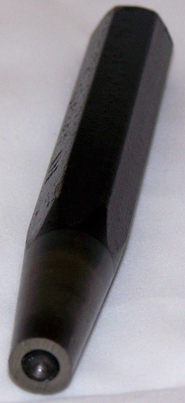

Called a 'snap.' Before that's used you close the plates using a 'set.' They're often combined in a single tool called... A 'set and snap.'

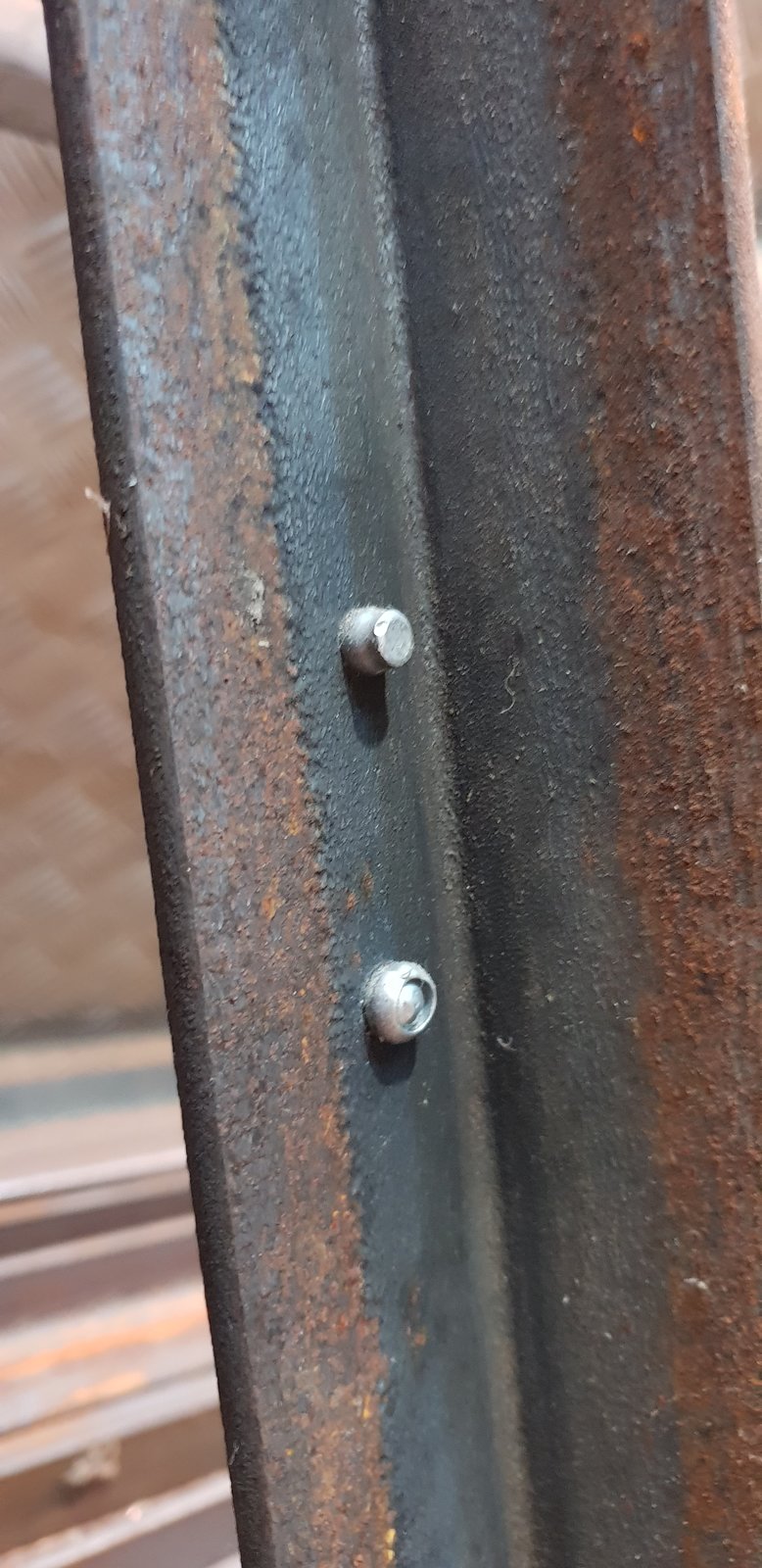

You'll still get a reaction where the aluminium rivet goes into the steel frame, so unless you glue/bond the ally panels to the painted steel frame it will corrode eventually.No because I am using Jotun 87 epoxy aluminium primer followed by Hardtop XP PU paint over the top to coat all the steel. I will also use Sikaflex although there is no point at all.

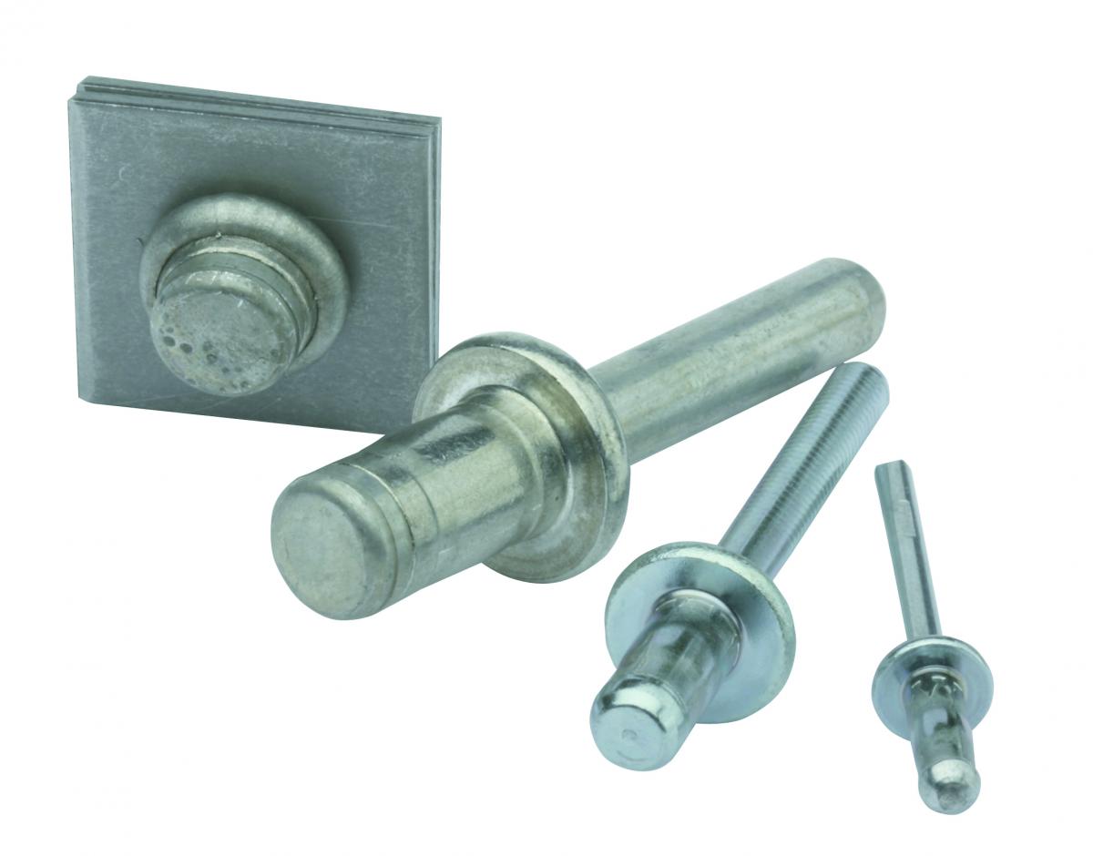

I would use monel pop rivets, setting 400 solid rivets by hand is a lot of work to no advantage, if the backs of the rivets protrude you can always give them a tap with a hammer and a dolly.
