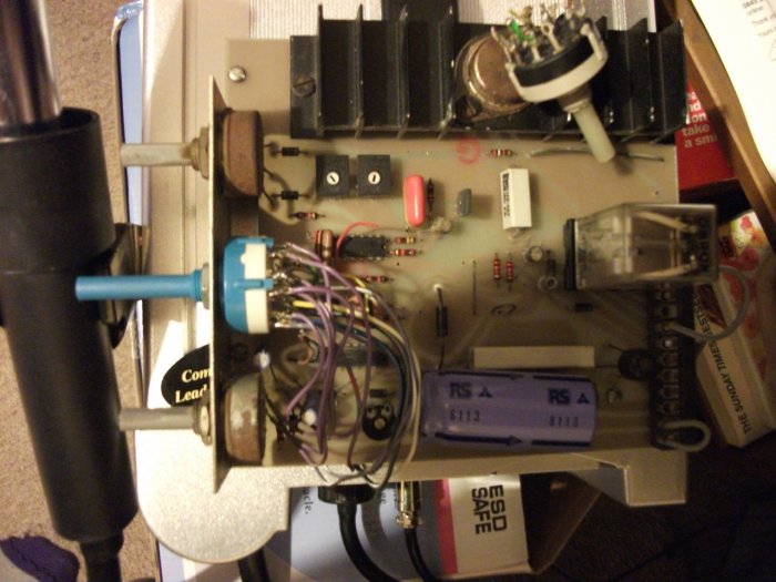

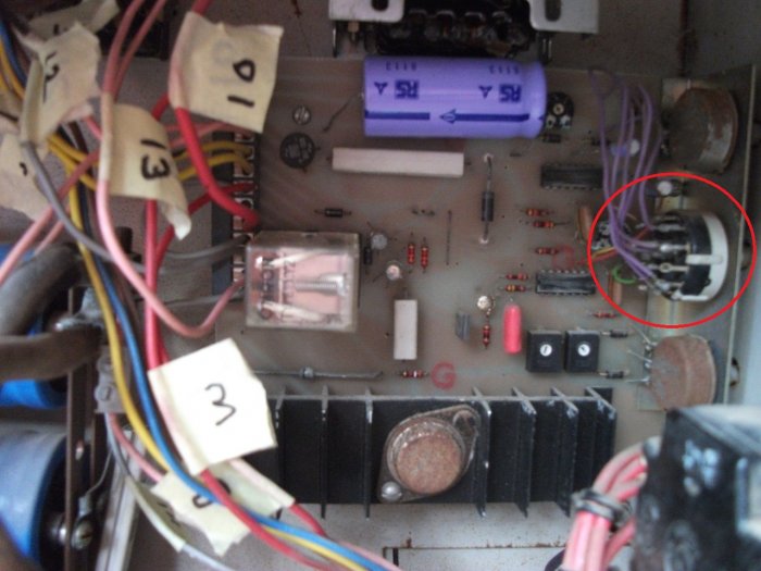

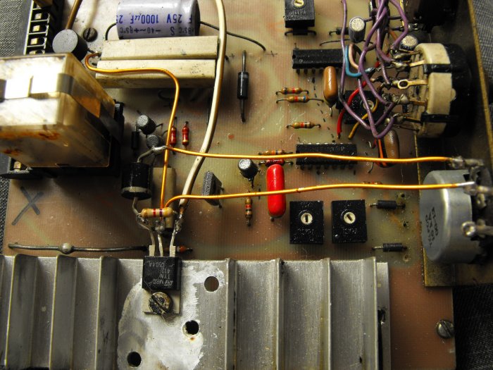

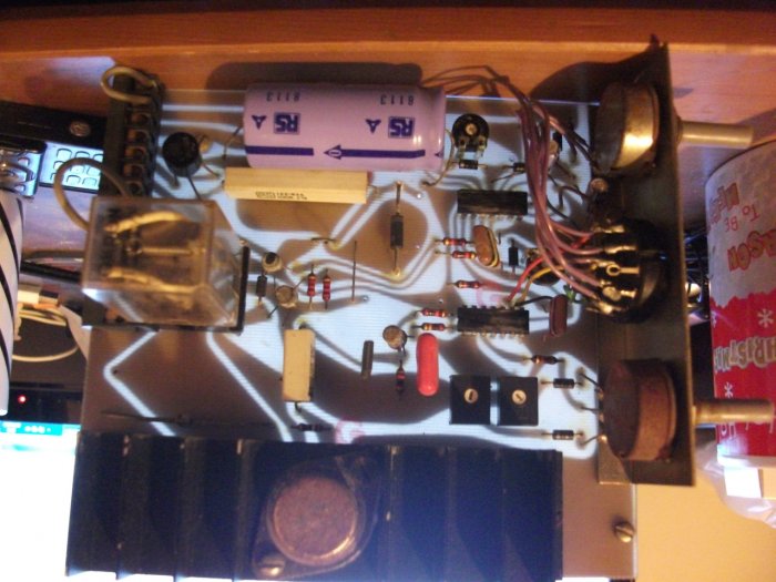

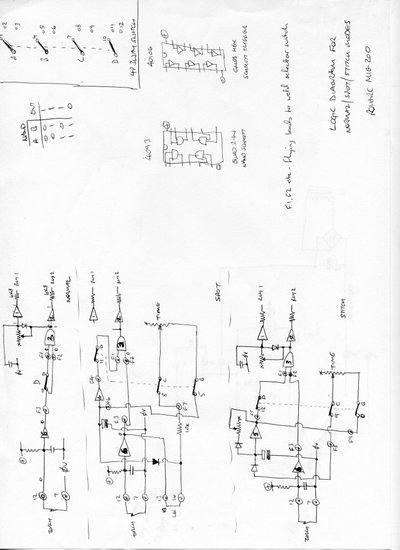

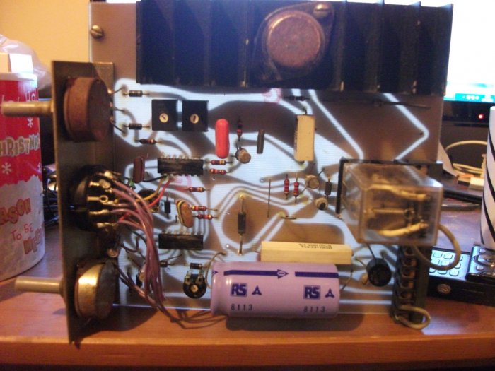

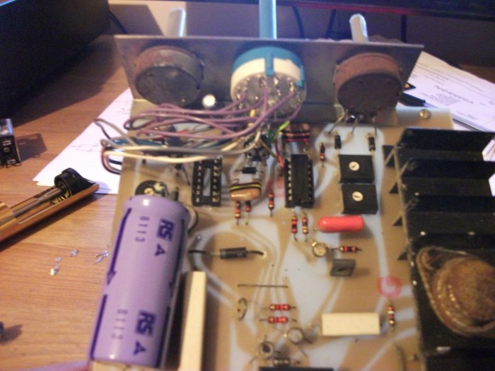

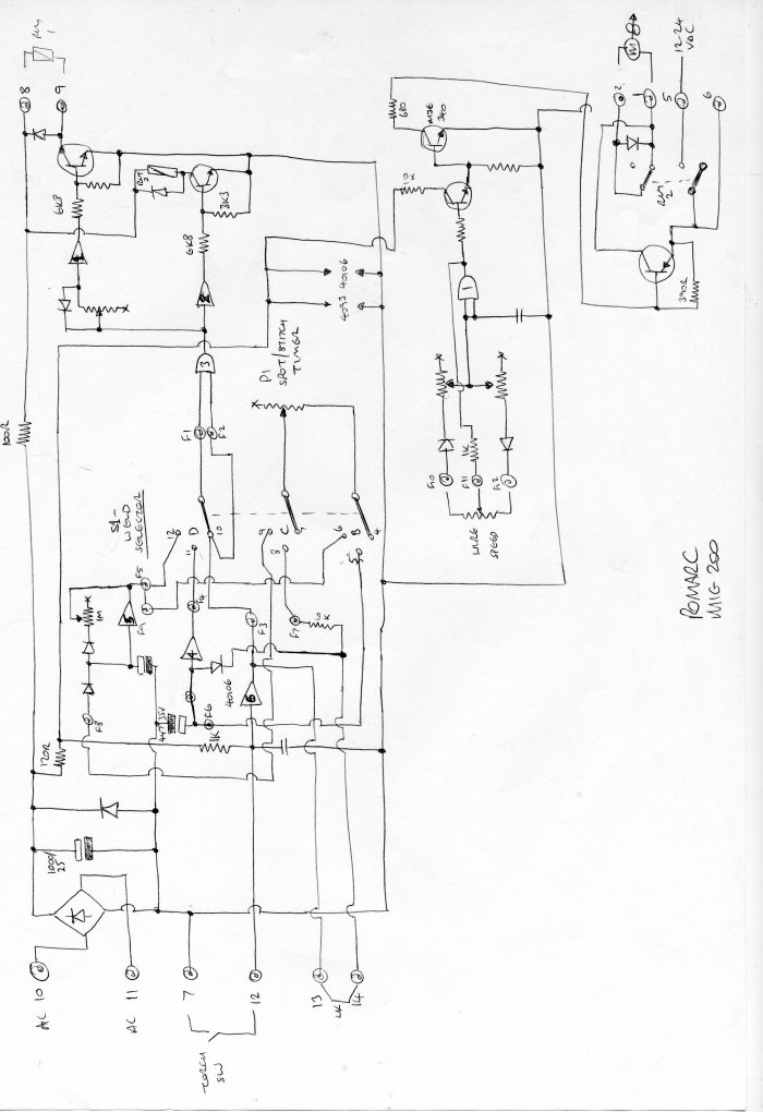

removed the PCB and replaced the 2 transistors near the relay on the PCB. when i re-fitted and press the ptorch trigger the relay stuck on. (the wirefeed relay)
can only assume the BC107 is not the right transistors as this hasnt happened before. relay #2 that activates the contactor still come on instantly so it has to be something else causing it anyway.
Im at a loss with it really, might bypass the part of the board that controls the second relay and make my own or source another board for the welder.![]()
Post the PCB up to me, I'll sort it for you. Can't be much wrong with it.
Those new caps look OK to me... electrolytics don't last forever anyway so don't be surprised if they start going down one by one. I think I spotted 1981 as a date code on your Romarc so 30 years from a component that is notorious for failure unless charged regularly isn't bad going.

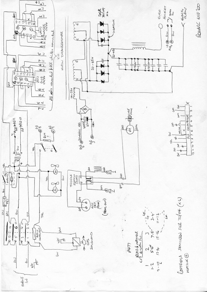

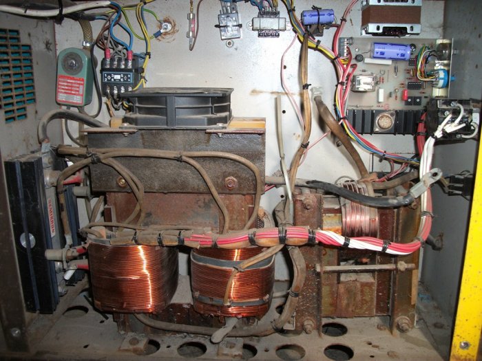

 best way i can explain it!The primary is usually on the inside as the secondary ha sthe most heat.

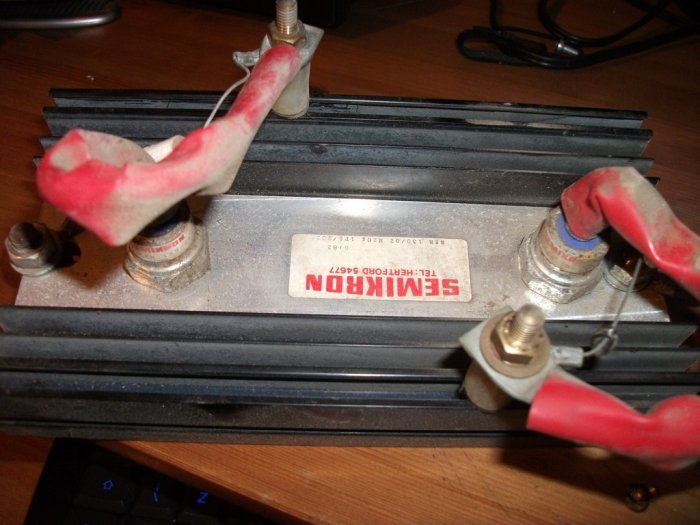

If ther is just 2 diodes, then it is a half-wave bridge (center-tapped transformer.) Each diode get the current 50% of the time; or average half the current.
looking at the transformer its wound completly different to any i have seen before. it doesnt seem to have a primary "side" as it looks like both sides make the current by joining each side with the rotary switch. i think the primary side is actually inside each of the coils.
does this mean half the load of the welder goes though each of them? that would be 80 amps going though each one or doesnt it work like that? only asking because that would mean the diodes actually have a percentage of amp overhead.
As for the diodes, on each mains half-cycle one or other of them is conducting, but as the total current flowing in a circuit is the same wherever you measure it, then as only one diode is conducting at any time, it must be carrying the full rated current, not half of it... I think![]()
It should be able to do 160 amps.
