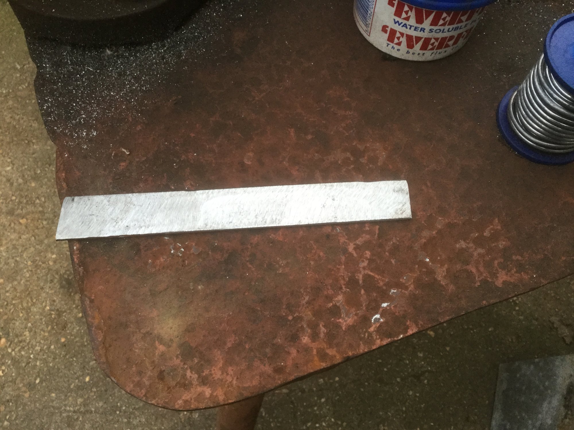

Here you go Ronan a real life demo

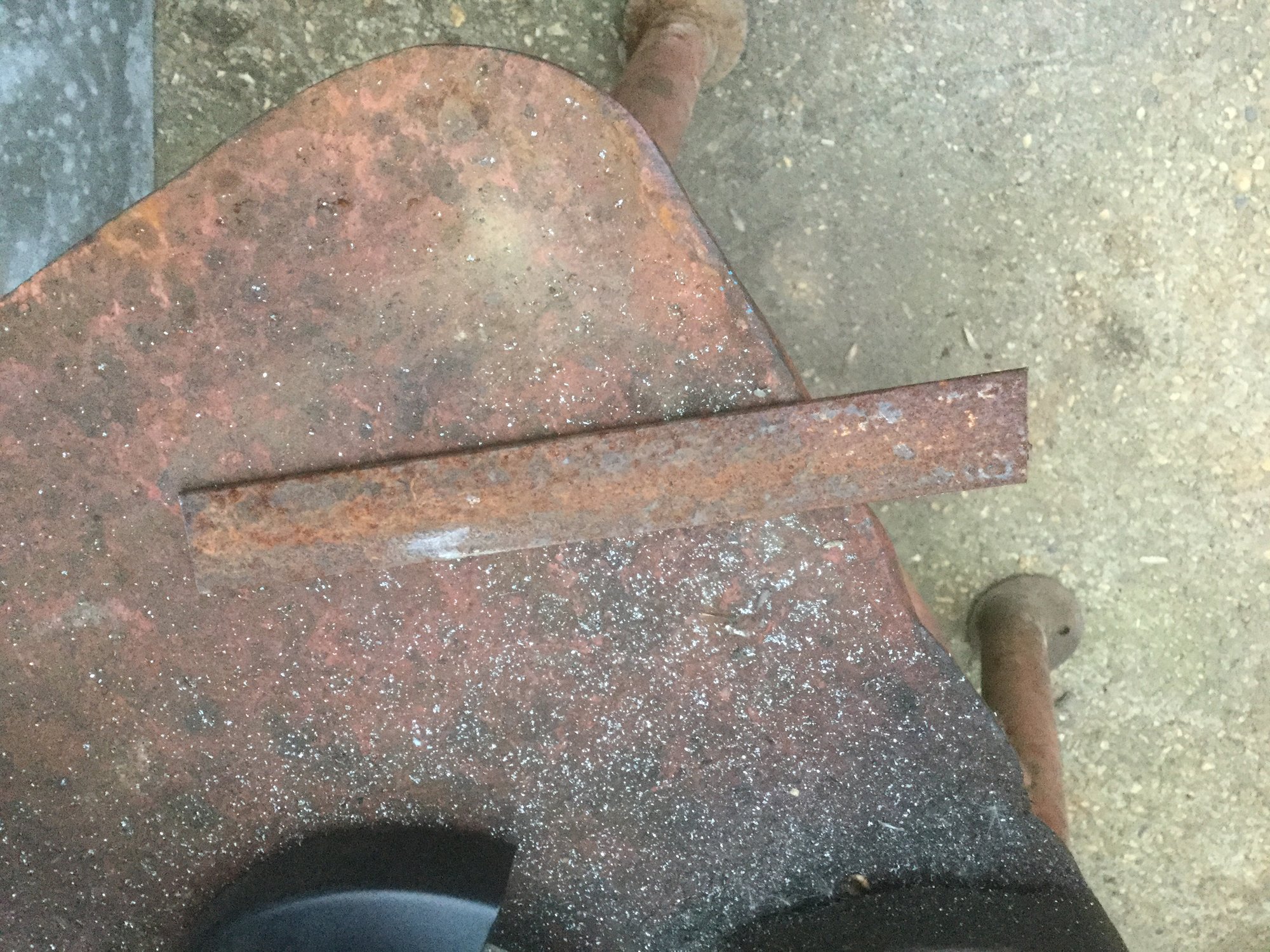

A nice bit of "cured" 30mmx3mm flat.

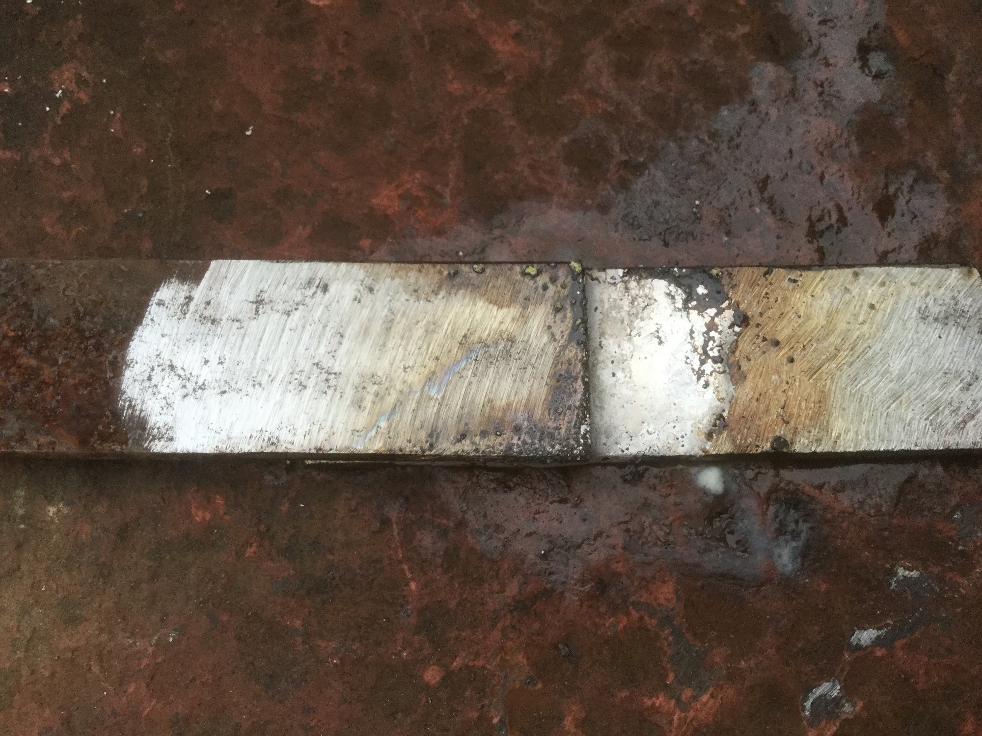

Cut , prepped and fluxed
Keep the gap tight to aid capillary

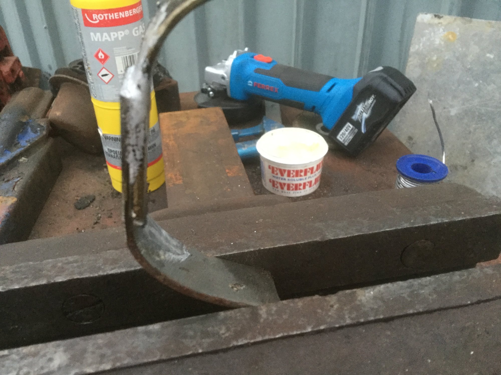

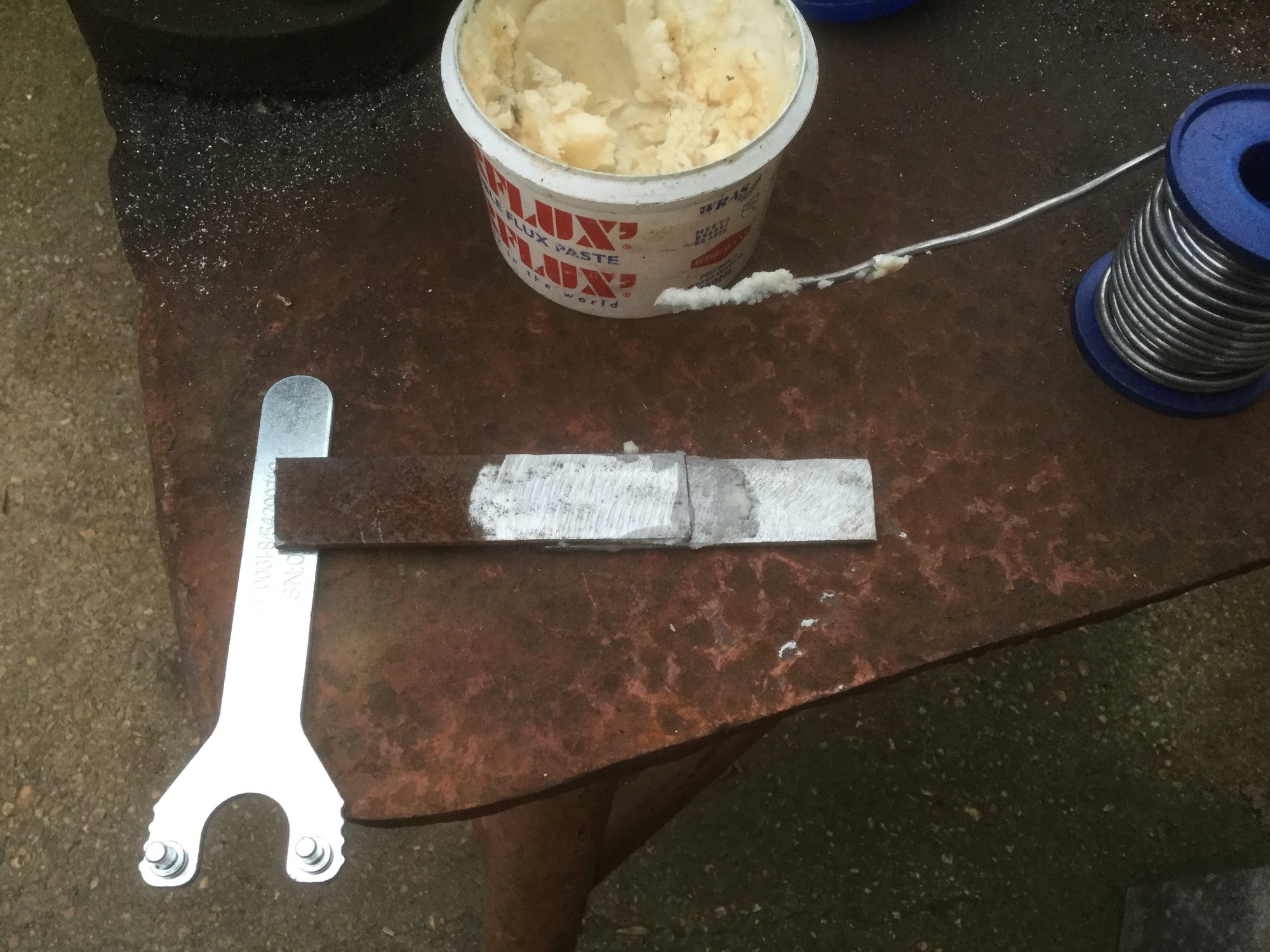

Soldered and bend test
View attachment 180086 View attachment 180087
