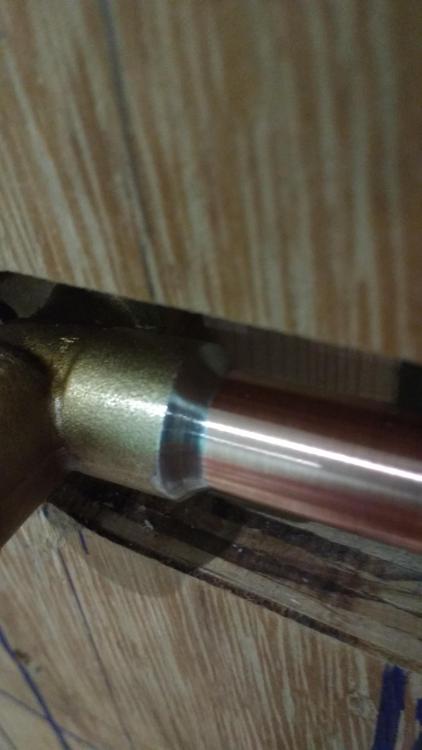

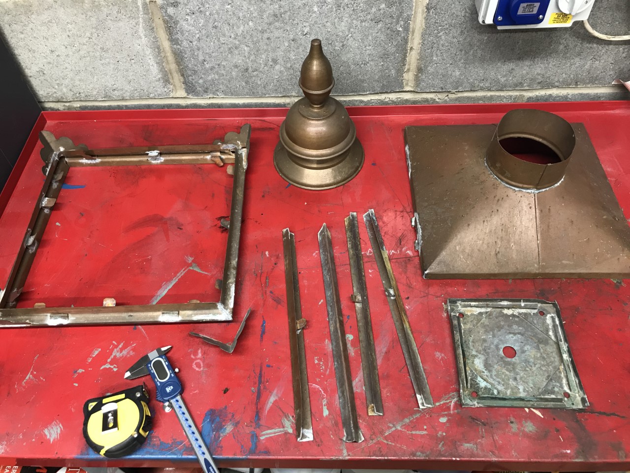

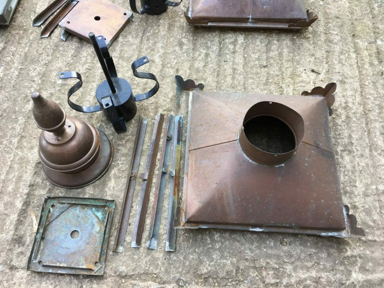

I've watched Doubleboost hard soldering and assume this is the technique i need to stick some copper together. (Copper sheet 1.5mm thick folded into small angles onto 1.5mm copper sheet)
I'll try dig out his videos again and have another watch.

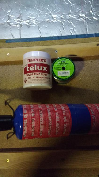

What flux and solder is the best to use?
Putting one of these together.

I have a torch that runs on MAPP, you can set it low enough to get a great wafty flame instead of a harsh "woooosh" one, but also use a standard butane/propane mix to heat my irons, but I can't seem to get on with using one.
Another source of copper is 28mm pipe cut down lengthwise which will give you a sheet nearly 87mm wide.This was another trick I picked up from my old man. It will need anealing once cut then open out and beat flat with a hard rubber mallet on a solid surface. I've used a smooth cast concrete step when no anvil but cover the side facing step with wide insulation tape to prevent scratches.
