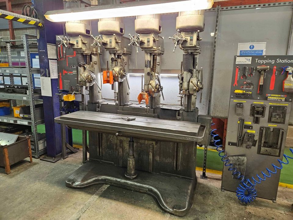

Well sold this weeks back and now its to prep for delivery to Ireland.
All i can think of is lower all we can to lowest point to lower the weight down.
But whats best way for it to sit on a pallet ?
I was thinking of a pallet size for base size of the drill, then on top of that BOLT down some more pallet planks in each direction and then bolt the drill down and ovbiously plenty of straps.. Then wrap it up.
Any better suggestion please ?
