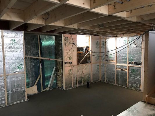

if im being honestHeres one I did earlier
in effect a box inside the stone shell
i like the stuff to a degree but i dont like the fire issue side of it
lost about 8" around the walls
a french drain inside of the house filled with pebbles and all leading to a sump pump drain
