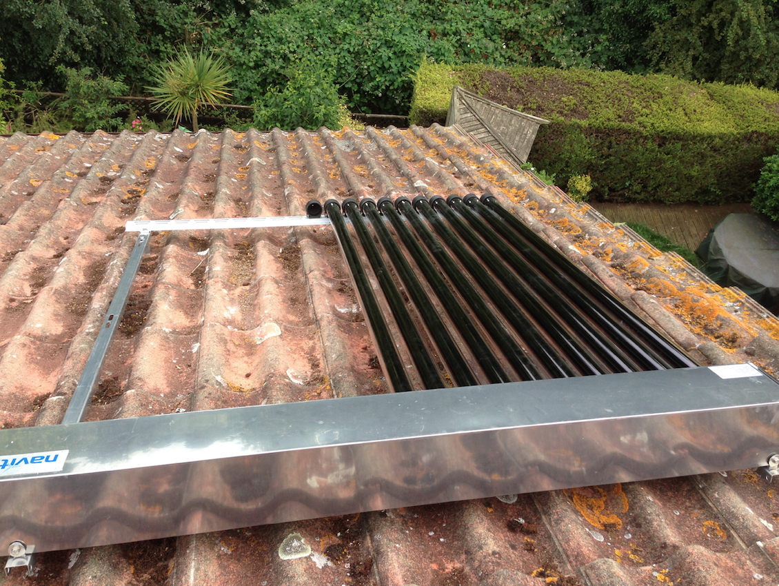

I assume you already know this but just in case, you need to make sure the system is all in place filled and functioning before you put the tubes in the manifold.
Something you can do to avoid dumping(you still need to have it in place) is to run the system at a higher temperature and fit a blend valve to lower the temperature of the hot water.
I was chatting to a guy at the place I got my kit from and he ran his cylinder at 85 degrees and even when he went on holiday in the middle of summer with nobody using the hot water the stats showed it never dumped heat once. The other benefit is your tank of water has more capacity.
