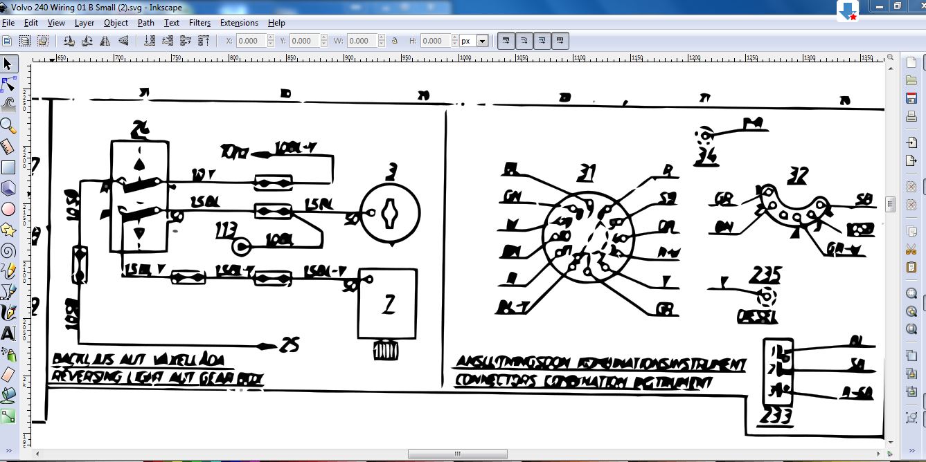

I have converted it to an eps and an svg. SVG opens fine and is scalable so I think it might sort rtbcomp out.
Confused. when I open it it does not show any nodes...That opens fine, it's slow refreshing &c and there are a lot of nodes, the markers tend to obstruct the image.

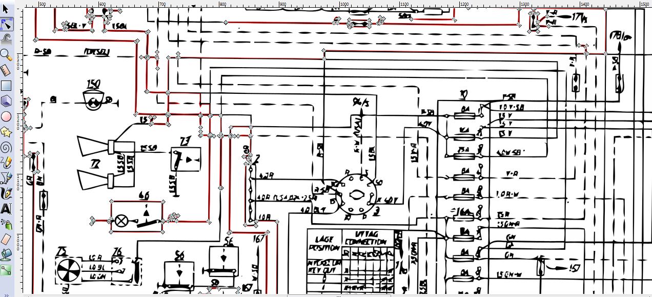

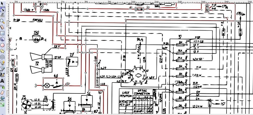

Inkscape but I cant get the nodes to show..lolI'm opening it Inkscape, what are you opening it in? The nodes show when I click the Bezier/Line button.
This is the latest one opened in inkscape.I'm opening it Inkscape, what are you opening it in? The nodes show when I click the Bezier/Line button.
