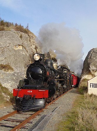

Firstly, a great many thanks for all the replies. I will sit down and deal with them when I get a mo. For now, here's a picture of the loco in question. It is 30 years since its last overhaul and is due a big boiler tear-down and inspection not to mention anything else that we find along the way...
