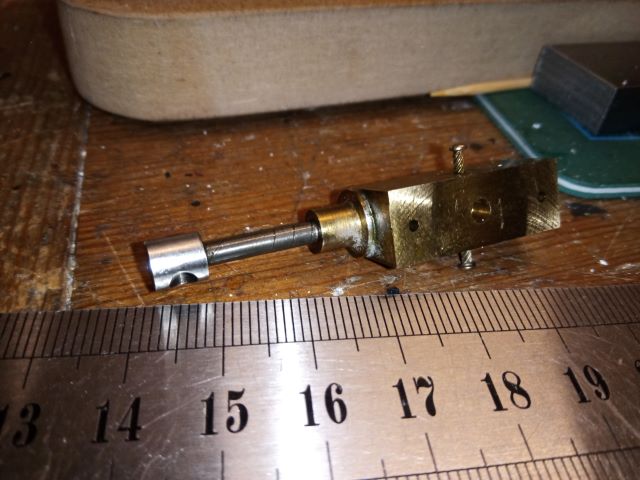

Im wanting to make a small toy steam engine and the normal method of attaching the cylinder covers to the cylinder is to use soft solder like on the cylinder below
I need to make a cylinder with 6mm bore and 0.8mm wall thickness, and working pressure is 30psi, so it should only get upto 135C working temperature so Im thinking that if the end cover is a light press fit in the cylinder and held in place with loctite 648 in a groove , would be a better alternative as its operating temperature is upto 180C than using soft solder
www.henkel-adhesives.com
the issue with solder is that there has got to be a gap to for it to work and that means that the fit of the piston needs to be looser to allow for any possible misalignment. Im thinking that thermal expansion could be an issue, but unlikely due to the size of the metal components being used although the end cover will heat up much slower than the cylinder.
what do you guys think
