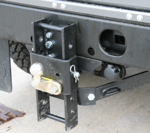

I have commented on how UK trailer hitch's don't remove they way they do here in the US, most popular are a 2" square socket, and that is something
that limits versatility. There is a wide range of attachments to plug in there.

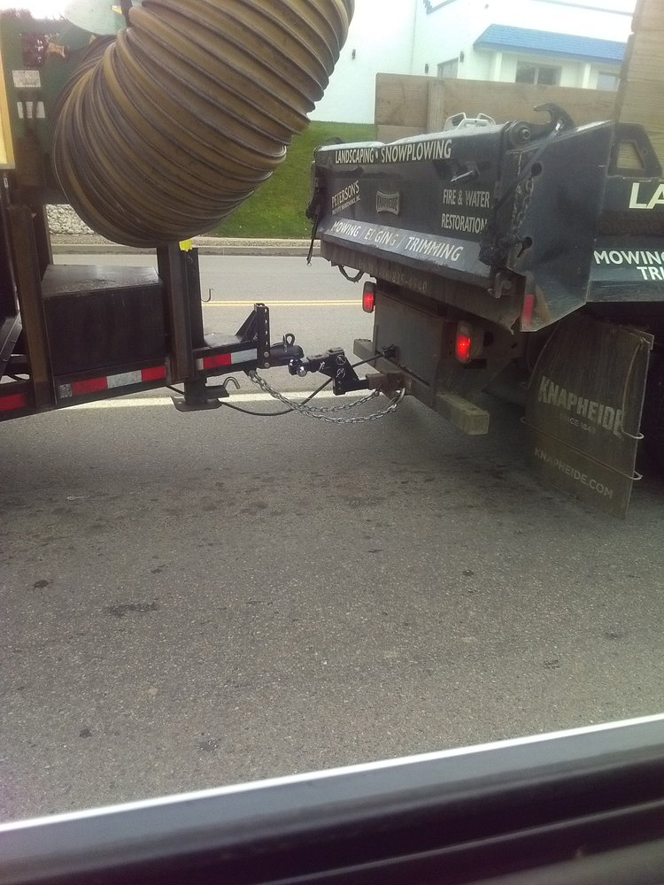

Spotted this landscaping contractor on my afternoon commute.....
It's a 1 ton dump truck, with the new 2 1/2" sq. hitch (that no-one sells anything for, so the OEM equips them with a 2" bushing that rust's in permanently)
Owner is pulling a 14k 2 axle dump trailer (everyone is geared up right now collecting leaves).
The amount of slop (up/down & side/side) by the time we get to the trailer is clearly visible, and the height adjustable part is set too high as well.
Not even considering how much further back the ball is from the truck, adding leverage (in a bad way).

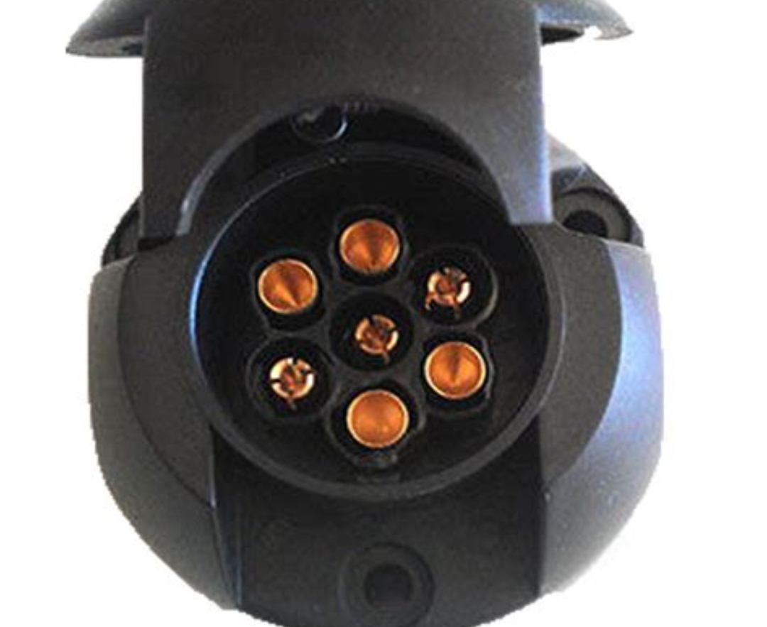

Why is the 7 blade round connector considered awfull ? I've fixed the 6 pin round and the 7 pin round, and the newer 7 pin blade is much better as the contacts wipe as you push
the connector in, and no tube socket to get plugged with corrosion.
One area that get's no love is the front of the chassis mounted socket, there is a spring loaded door on the back when it's disconnected, but nothing much
on the front end (where the wiring comes in) to stop the blast of road salt & sand coming off the back tires.
I have affixed a piece of old inner tube rubber all over that area with some tye-wraps, to keep it clean.
