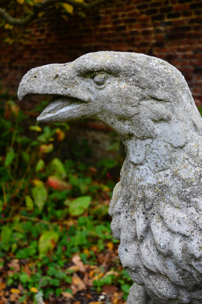

thanks but not the same design ,appreciate the offer though.There is this at a park not far from me. No problem taking pictures next time I walk the dog there.
pic added ,thanksHave you got a photo of yours? I know there's one at Crewe Heritage Centre, though I don't know whether they'd let you take a cast from it, or indeed how easy it is to access.

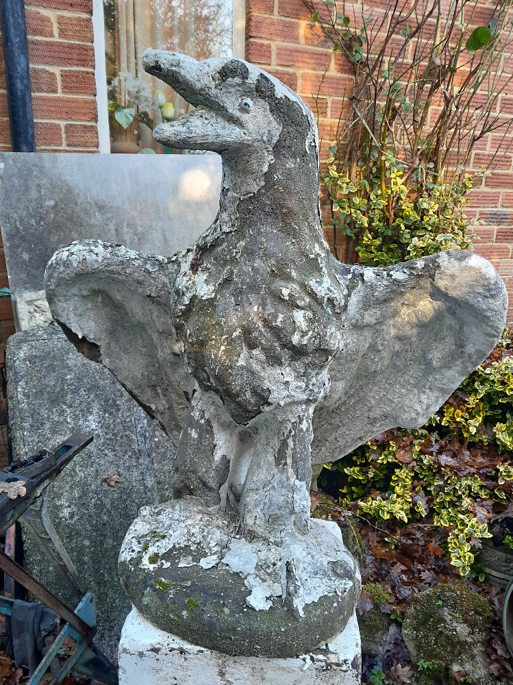

we ccan agree to dis agree, I realise what your saying though and some detail like feathers have to have an exagerated depth to actually show from a distance , the same as statues made for putting on roofs etc , they have much larger noses than normal to look in perspective from that distance. on everything I used to cast I would go over the mmaster before making the master mould and go into fine detail , statues would have toe nails etc etc , otherwise you get into the balloon faced rubbish you would see at some places for sale , distorted faces stained to disguise such poor quality moulds . my theory was all your overheads are the same if you cast into poor quality moulds as they are into quality moulds , yes they cost twice as much, but you gained that back by no labour correcting faults on casting , then made more by selling more due to quality . yes loved my work! the other benefit of better moulds is they stay cleaner longer .with stone less is important too much detail becomes wear but designed right becomes a less wear over the years

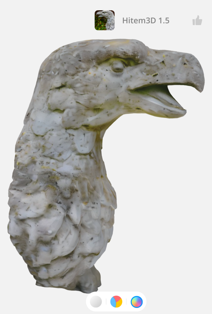

does it always reverse the image ? and preferably I would need more neck if possible (that sounds wrong) but thats the correct pic for sure.
where did you source the pic? thanksIts a 3d model, you can view it at any angle you want.
it would be printed in 3d as a positive to take a mould from, that youd then use for the repair.
The pic I used, didnt show the whole thing, so to have all would need a different pic.

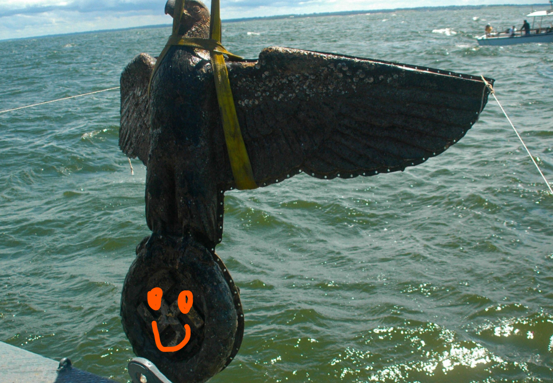

Better not to ask......Maybe the German Embassy have some in their basement.
ok , thats brilliant , great detail seeing how far its enlarged eh. thanksI googled that place you said with eagle on the end, 7th one down.
must be doing something wrong , I zoomed in on the original pic and it pixelated , need to tinker with setting i geuss.I googled that place you said with eagle on the end, 7th one down.
