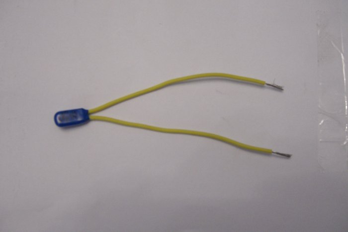

Hi again guys, I picked up a old snapon minimig180c cheap to replace my old welder which was stolen, up untill yesterday it was working fine, yesterday after about 20mins of welding it just stopped working, i checked the fuse and even tried a new power lead just in case there was a brake in the cable, but still no joy, someone suggested it could be the thermal cut out, my question is how do i go about resetting it, or is there anything else i should be checking on the welder ? cheers for any advice
