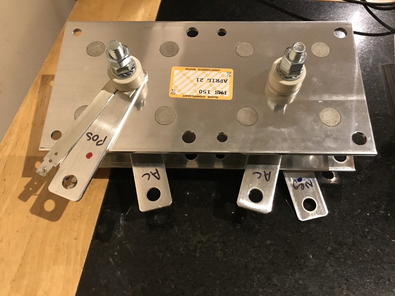

The last one I bought, a 150 Amp unit, was from Sealey's spare parts service.Sorry, I see you already answered the question about the Chinese rectifiers
Had Chinese writing all over it.
Was about £25 posted to my local distributor.

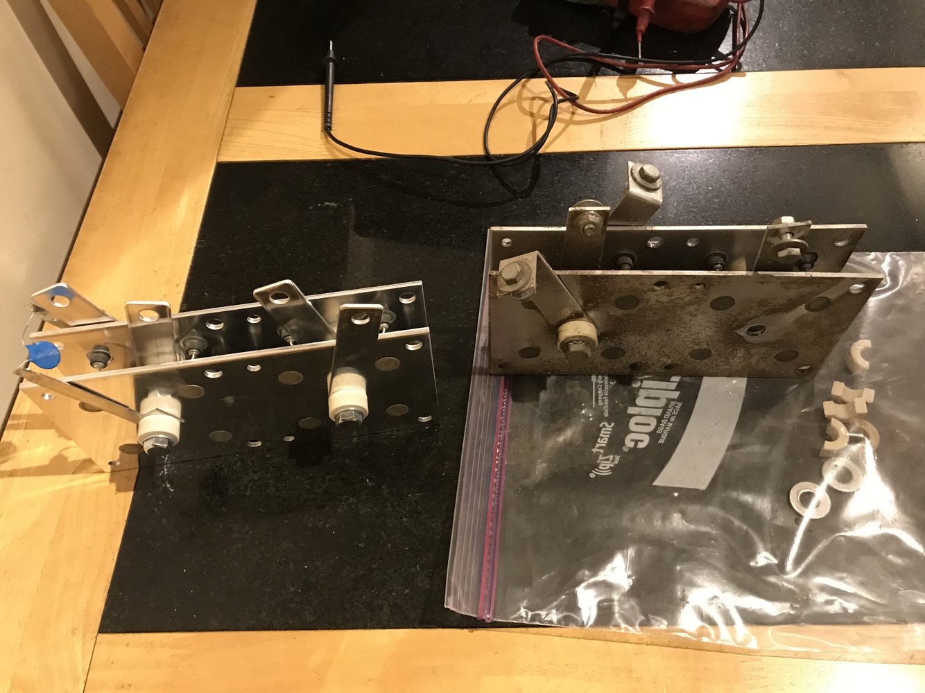

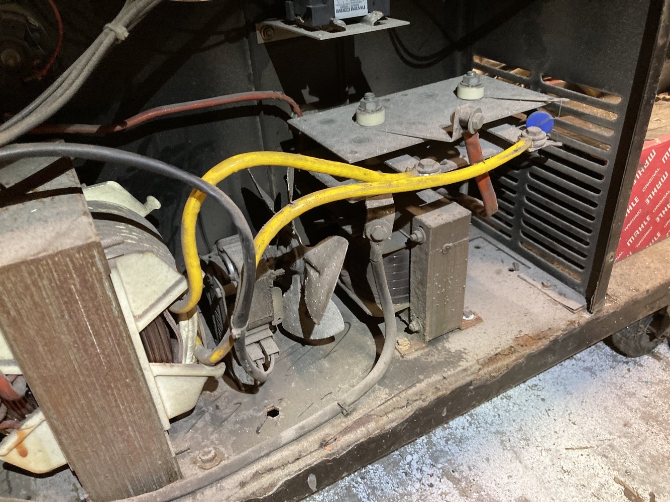

The numeric value shown in Diode Test mode is the voltage dropped across the diode when it is conducting ( the forward voltage ) in millivolts. Typically 0.4v to 0.7v - 400 to 700 millivolts.i got the rectifier out tonight and started testing. My multimeter gave readings in the 470-482 range (on diode test - assume it’s resistance but not sure - the meter doesn’t specify the unit of measure) except one which is open circuit both ways. The connection to it was broken as well, so I reckon that’s blown, properly!
